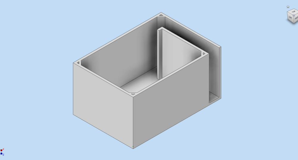

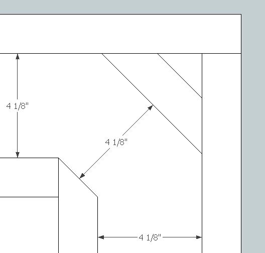

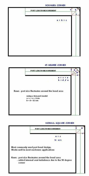

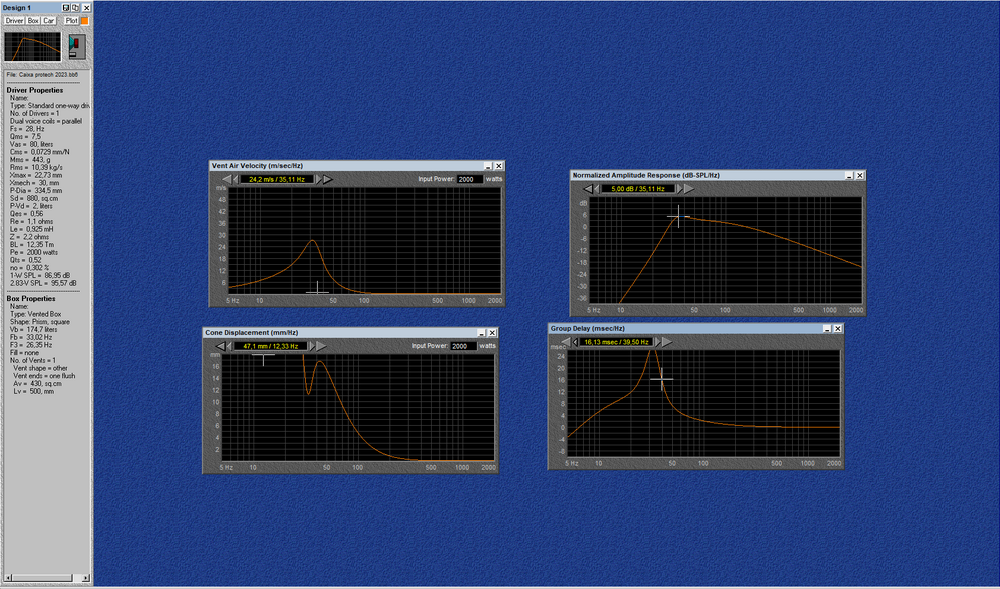

@Joe X Hello, I managed to get this result as shown in the photos, the peak of the box was at 35 hz, the FS was at 33 and the FB at 26. Do you think it's good to play low and loud? Or is it possible to get more output on lows? I am improving the electrical system, I would also like some tips on construction, I made a CAD drawing of the model, I changed some dimensions to get a larger box in my vehicle, as for the 45º in the corner of the duct, what is the correct way to measure this curve ? I found an image on the net, should I follow this method? thank you very much
