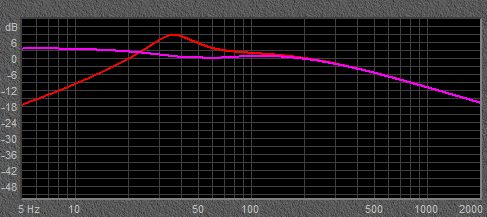

it a gp car audio subwoofer enclosure and im going to be putting two stereo integrity sql 12's in 1.55 cubic feet per sub tuned to 35 hz.  also couls someone model the subs in .91 sealed ve the proposed ported box.
Red is 3.1 @ 35Hz 54 squarer inches of port area. Peak vent airspeed @1000W per driver is close to 20 m/s
Violet is  0.91 (per driver) sealed.
Cabin gain is set for an average sedan, 12dB per octave 3dB gain at 50Hz. May or may not represent your situation.
You can always fix either with DSP.
