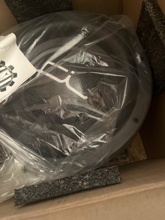

209er Posted March 9, 2023 Report Posted March 9, 2023 I just open my Fi ssd Neo. Had it in storage for a good minute. I just bought a 06 single cab. I wanted to know if any could help me with dimensions on a 4th order. It will be a cut/blow through. I definitely have the room. I was debating on just putting 2 gcons(10s) but decided to stick with the single fI <p>Pioneer AVIC 6000 NEX, JBL 660c Components - FI SP415- Arc audio xdi2000.1- Xs Power- 0 gauge, Big 3 Upgrade Dc Power xp270
