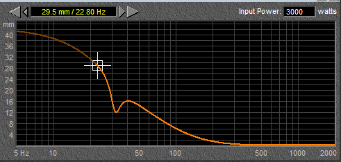

The SALT 4k can put out 6106W uncertified @14.3V so let's say 3000W per driver:
Box: tuning is 32Hz net volume 2cubic feet per driver.
As you can see you hit Xmax at 23Hz, going over Xmax produces distortion and likely coil heating.
