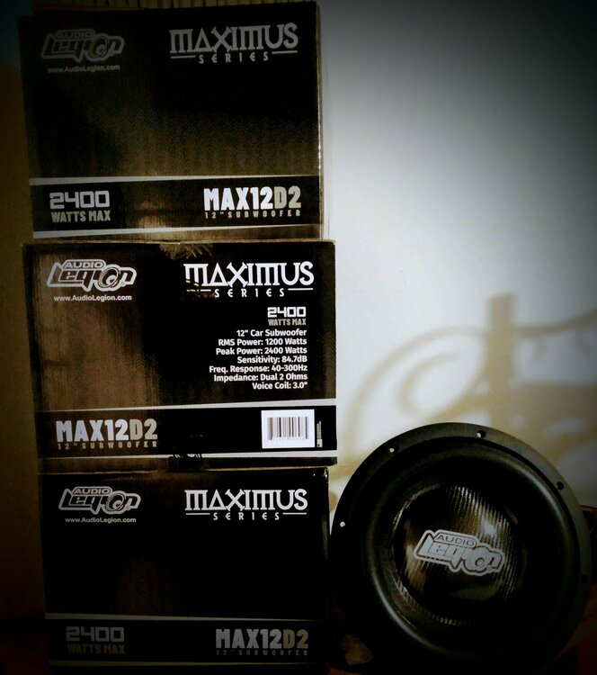

there all here now now i really need to get to work , i did end up clearing out any remaining stock on the dual 2's that were left on  he website
