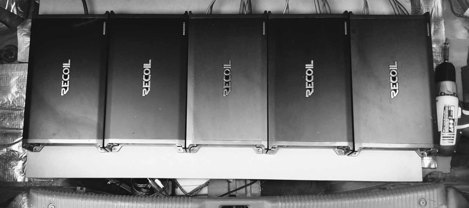

getting close to having the wall done and wired up on 5 of the small amps( swaping to 5x 2500w rms amps in the near future  , still need to seal it to the b pillars and other work but i got plenty of time before the next comp
4 of the 5 playing on low power , now that im out of work for the day ill get that last amp hooked up and get some full power send videos

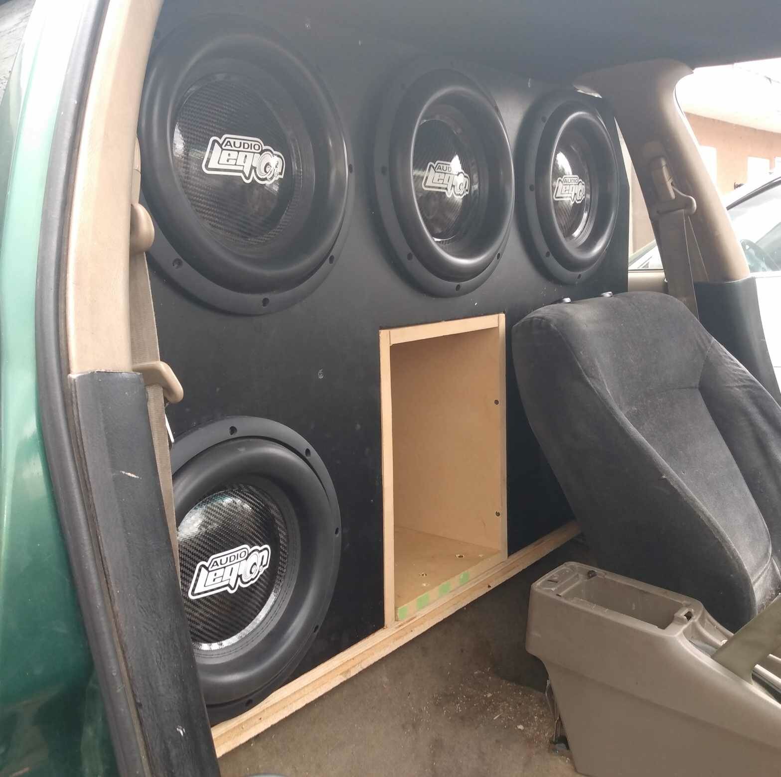

got all 5 hooked up and relized i was running into a power handling issue , ended up cutting some pieces to put int he port to shrink it and it helped so im going to cut a new port thats 112sq inch instead of 170sq inch ill get some vids up a lil later today im currently sitting at 130sqinch of port and it will taske full power but im only ruinning at 1200w per driver currently when the new amps go in it will be 2k per driver
droppe dmy port tunning down to 26 hz should be heading out to do some testing later on today , i aprently also need some more bracing ont he front baffle what i have + a tripple 3/4 thick front baffle is aparently not enough im starting to see some baffle flex at near peak power levels

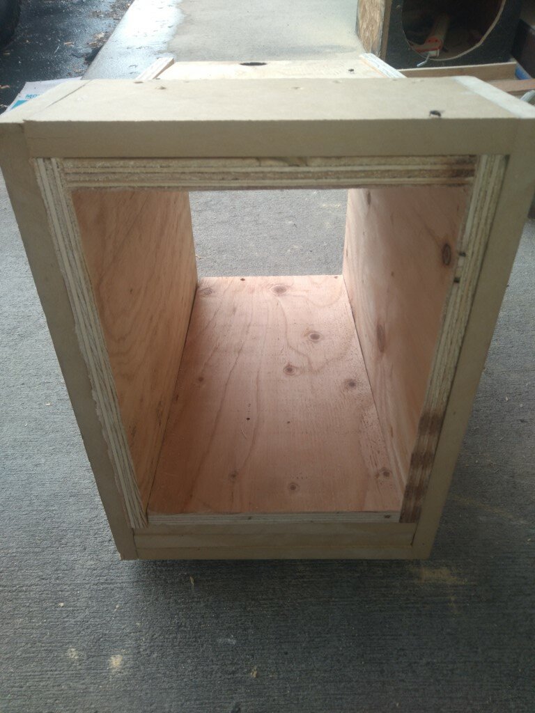

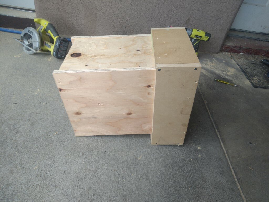

finilizing my swapable port for the wall build , the mdf section is the main port installed into the wall , the plywood insert can be put into the port and bolted into place to lower the tunning .
mdf port is tuned to 44hz and then i have 2 plywood swappable inserts that are tuned at 32hz and another one at 28 hz 20230821_092321.thumb.jpg.a7151f465f2440c69e48a384e1a0c6b8.jpg20230821_092338.thumb.jpg.f264f4858df48701653e6acab611c129.jpg
the subs are audio legion maximus 12's in dual 2 , they are no longer available they were available for a steal at 124$ each until they sold out

so quick stupid update on my part , when i wired up all 5 sub amps it was dark out and i somehow missed the ground wire for the 5th sub ( the one behind the driver seat ) found it today when i was dbl checking all my conections and wiring so now i have all 5 hooked up
