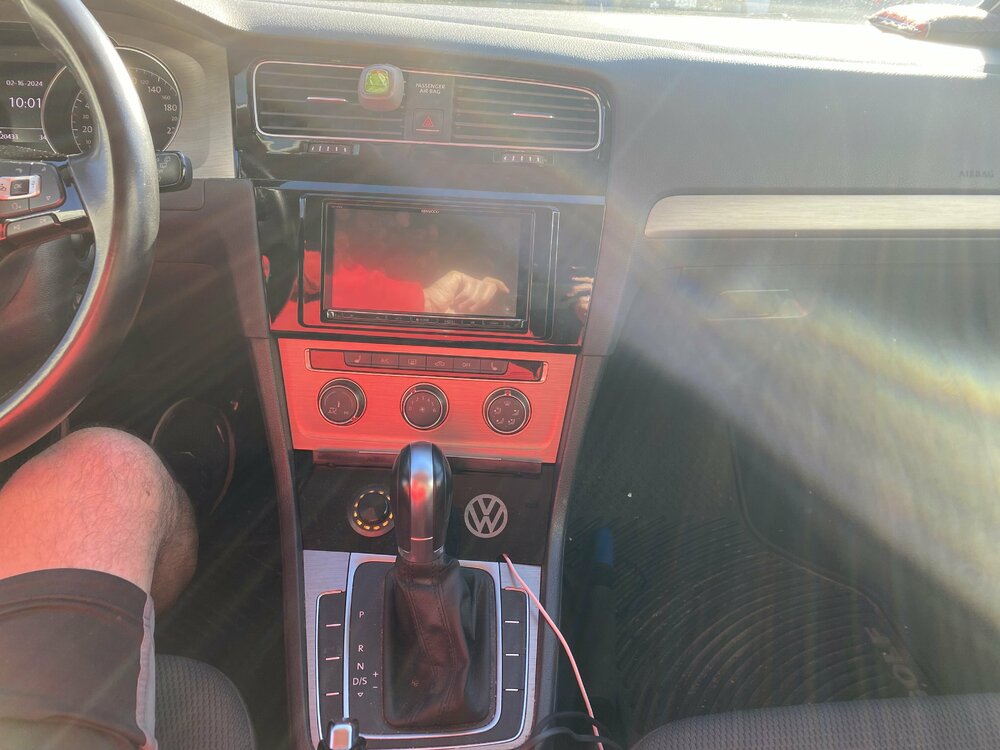

pnutz37 Posted March 12, 2024 Report Posted March 12, 2024 I have a VW Golf (2017). It has the basic entertainment system. I wanted to go with a high level to my DSP. I had nothing but problems going that route. The VW head unit is looking for a specific resistance at the speakers. I was constantly getting distortion coming in and out depending on the recording and song (It would happen multiple times through a song). This happened on multiple music platforms. It didn't matter how we set the headunit eq or volume at. If it was flat, below flat, frequencies turned down or up. It always came back to distorting at some point. I did get the work completed through a reputable shop and was thankful that all the diagnosis did not cost me anything. There is a unit that can be installed that integrates the VW head unit and has RCA outputs (I don't remember what it is) Ultimately I had went to the aftermarket headunit. Zero issues since.

pnutz37 Posted March 13, 2024 Report Posted March 13, 2024 13 hours ago, bigrank916 said: I had seen that info about the head unit sensing the ohm load from the speaker. Most of the LOC PRO units from Audiocontrol have an ohm selector switch that will feed that info back to the head unit. Hopefully that will fix that issue. Did you use an LOC with that feature? I've even heard of in line resistor type for stock plug ins. Was that the only issue you had going the high level input route? I'd love to find something that would allow me to use RCAs straight from the head unit. I haven't seen anyone replace the HU from my vehicle or the like anywhere online. Everything I've read or watched says aftermarket units for my car is next to impossible with the NAV, climate, etc integration. It's a very weird shape as well so nothing from a normal kit would work. I did not go the LOC route. I have a helix Dsp with high level input. And yes that was the only issue I had. We even adjusted the internal resistance of the DSP. Otherwise it would have been perfect im definitely lucky on having an easier time to get an aftermarket headunit with trim plate
