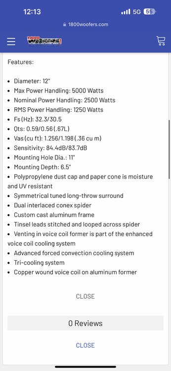

OuijaEight Posted April 17, 2024 Author Report Posted April 17, 2024 Features: Diameter: 12" Max Power Handling: 5000 Watts Nominal Power Handling: 2500 Watts RMS Power Handling: 1250 Watts Fs (Hz): 32.3/30.5 Qts: 0.59/0.56 (.67L) Vas (cu ft): 1.256/1.198 (.36 cu m) Sensitivity: 84.4dB/83.7dB Mounting Hole Dia.: 11" Mounting Depth: 6.5" Polypropylene dust cap and paper cone is moisture and UV resistant Symmetrical tuned long-throw surround Dual interlaced conex spider Custom cast aluminum frame Tinsel leads stitched and looped across spider Venting in voice coil former is part of the enhanced voice coil cooling system Advanced forced convection cooling system Tri-cooling system Copper wound voice coil on aluminum former

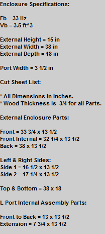

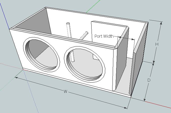

Joe X Posted April 17, 2024 Report Posted April 17, 2024 So here is a suggestion, power: to sub(s) rated, amp subsonic filter to 28Hz, minimum port clearance 3 1/2", figure is just an assembly guide: NOTE: If building outside you need to build a cardboard dummy box to test fit before building the real box. NOTE: Box can still be used with better subs for a future upgrade.

Joe X Posted April 18, 2024 Report Posted April 18, 2024 You can use a 1500W RMS amp no worries, just no clipping, subsonic set to 28Hz, careful with bass boost and other tone controls after setting gains.
