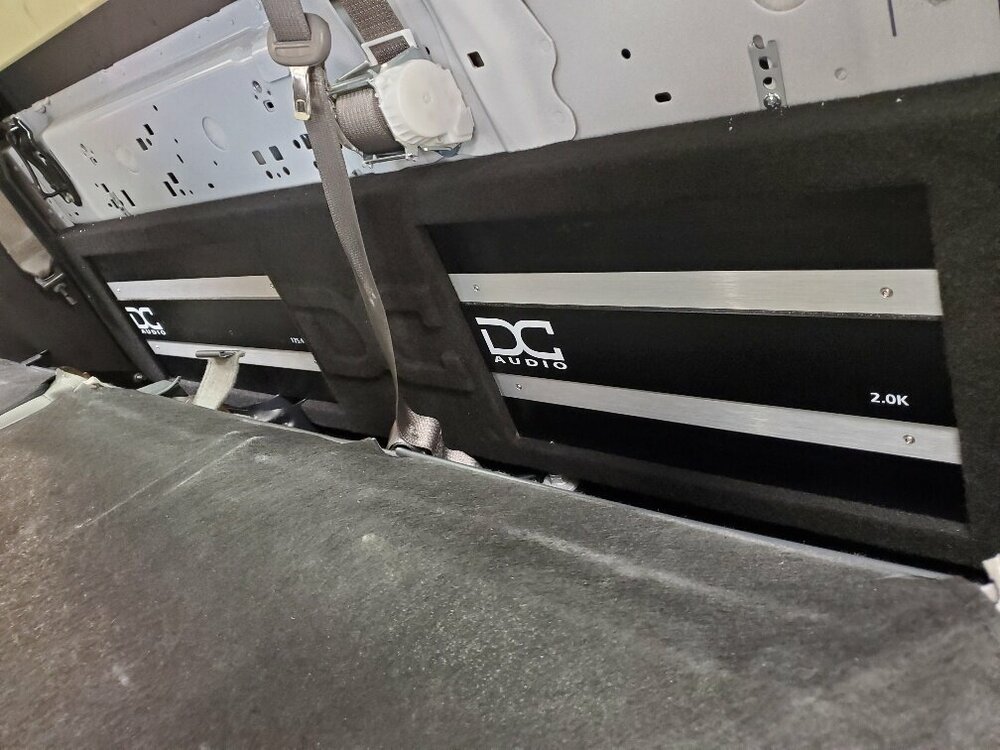

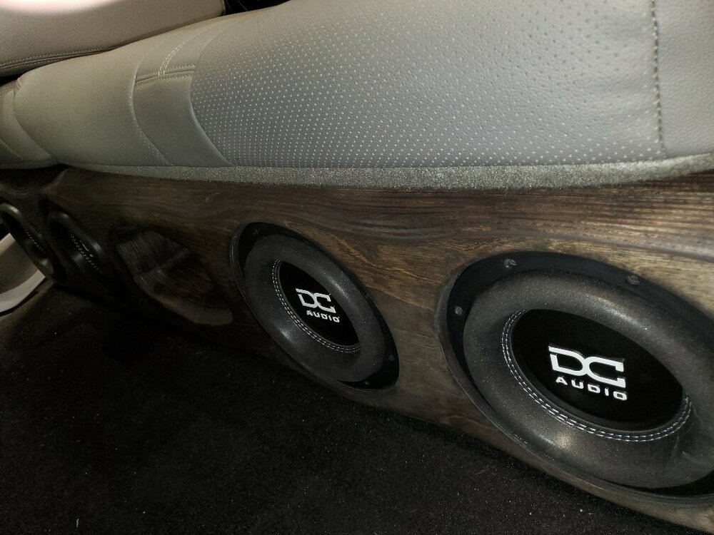

I have 4 M38's on a 2k in a Gately perfect fit box in a 2019 f250. I bought 2 xl spl 10S AND A 3.5K AND THE SAME BOX FOR 2 TENS. I know cone area is king, but what are your thoughts on the tens being louder and playing lower? I put a level 5 12 on a JP 33 in my other truck, and it kills the 4 8s.
Looks like you won't be gaining a lot with your new setup, you lose cone area and gain RMS, the result is for sure not a compelling upgrade.
As far as getting lower  I would have gone for the  XL Elite instead of the SPL version, and also gately don't give you the box specs.
 I would have gone for 4 X8 on say 5K and make sure the box specs are right.
thats what I was wondering, but they dont make a 10 in xl elite, need to keep my back seat low enough for adult riders, already has a seat lift
As before, in your situation  I would get 4 sundown audio X8 v.4 and make sure your box tuning is 32-33Hz (I think that box is tuned high) that is the best you can do as far as I know.
