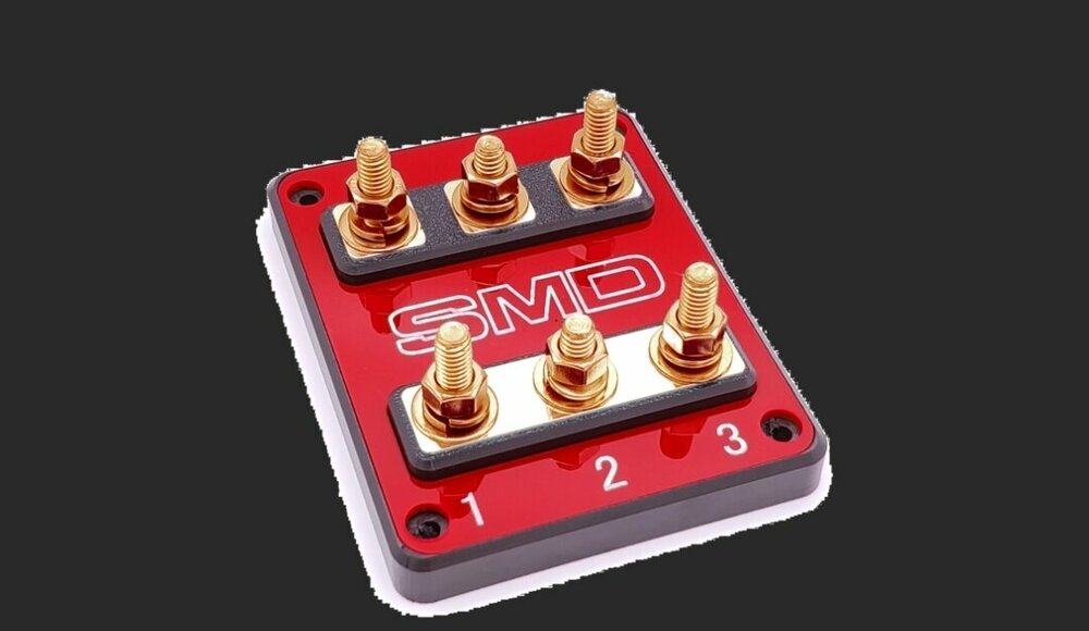

I'm planning to purchase this distribution block to power three amplifiers with their respective fuses (perhaps not all of the same amperage). I've asked sellers on eBay and Amazon, but they haven't been able to answer. How many input wires are needed to feed the input of 3 amplifiers? Any advice would be greatly appreciated, thanks.

Depends on what the amps need.
Say this,
amp 1: 80a
amp 2: 150a
amp 3: 100a
330a total / 2/0 minimum (1/0 if short and actual quality wire).
The image you posted appears to be a 3-3 fuse-holder, yes it still can act as a distribution block but it'd just make sense to have 2-3 runs depending on what power you're trying to pull thru it.

I'm going to run three wires from the secondary battery to the distro and then to the amps with their respective fuses. As I wrote earlier, your help is greatly appreciated.
