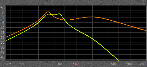

Posted (edited)
Your sub has an incredibly stiff suspension and a brutal motor so is not surprising that it does that, actually is meant to do that, to fix that behavior without losing a lot of output I came up with a "compact" parallel 6th order box:
It's about 4 cubic feet net (which defeats the purpose of getting a 12" sub) but you get 28-55 relatively flat.
That sub is so SPL oriented that it has dual 1.4 ohm coils clearly aimed at wiring in parallel to 0.7 ohm to suck all the power it possibly can from most amps.
Edited by Joe X
Posted (edited)
Thanks a lot for the help. That makes sense about the sub. When it was brand new it was super stiff like you said, but now after some use it’s actually really easy to push in by hand, so it definitely loosened up a lot.
That 6th order design looks solid, especially the 28–55 Hz range, but I just can’t make a 4 cubic foot box work in my space at all. The max space I got available is 30" wide 16" depth 20" height.  Unless I can get the 6th to fit within these specs then I guess I’ll have to try the current enclosure plan, even though it’s a bit peaky.
Really appreciate the insight though, it helped me understand what’s going on a lot better 👍
