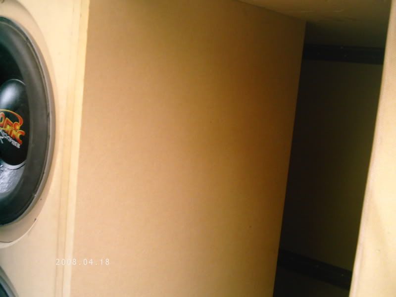

uhoh_45 Posted October 26, 2008 Author Report Posted October 26, 2008 2 15s 30+cube wall 2 powerbass's at .35 each per sub big ass port and all i had it doing a 153.3 at 42 with 2 DD 9917s in there and 2 z1s off a single yellow top battery it was up to a 154 and some change so the wall was doing its job i think... plus it plays music so i doubt i'm going to have any troubles with the subs unloading or damaging from being to big R.I.P! (Nov-29-2009) 92 explorer - 4 Atomic Apxx 15s duel .7s - 4rth order bandpass wall -4 powerbass XA-3000D's - 16 8volt batts wired to 16 volts - (9+/9-) runs 0gauge - 152.3 Db @ 29hz BUILD LOG current build 97 chevy lumina4 - 1 Atomic Apx 18 - 6 cube slot port trunk sealed off - 1 powerbass XA-3000D - 2 optima G31s in spare tire18 1 run 1/0 lumina build log
Corey Posted October 27, 2008 Report Posted October 27, 2008 30 cubes is stil WAYYYYY HUGE!!! and with that big of a box and that low of a tuning with that much power, im curious to see how long those woofas last. The port, subs and baffle take up interior volume btw, so its not exactly 30 cubes..... Alpine INA-W900 Dynaudio system 362 Zapco DC650.6 Stetsom 2k 2 15" DC lvl 4 hybrids

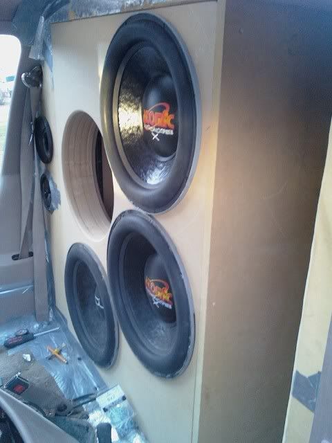

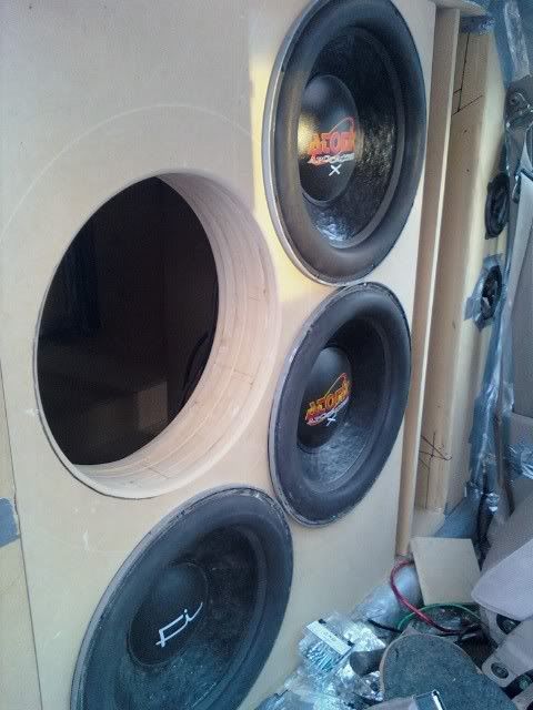

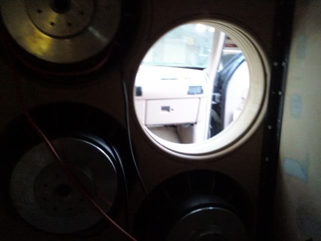

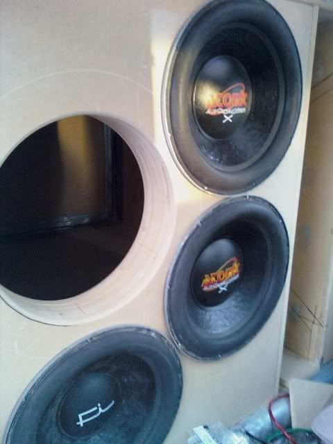

uhoh_45 Posted October 27, 2008 Author Report Posted October 27, 2008 did little bit of work today i went to get some wire but they didnt have the 8 gauge i already installed so i said fuck it and bought some 4 gauge also mounted 3 of the 4 subs forgot i had left some shit in there so i had to climb through this hole to clean it out more to come going to put the center console back in and the deck later on tonight R.I.P! (Nov-29-2009) 92 explorer - 4 Atomic Apxx 15s duel .7s - 4rth order bandpass wall -4 powerbass XA-3000D's - 16 8volt batts wired to 16 volts - (9+/9-) runs 0gauge - 152.3 Db @ 29hz BUILD LOG current build 97 chevy lumina4 - 1 Atomic Apx 18 - 6 cube slot port trunk sealed off - 1 powerbass XA-3000D - 2 optima G31s in spare tire18 1 run 1/0 lumina build log
BigPimpin91 Posted October 27, 2008 Report Posted October 27, 2008 Couldn't fit though the port? I'm pretty sure you could have. BigPimpin91's Banging Music

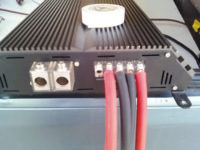

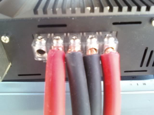

2000LaDe Posted October 27, 2008 Report Posted October 27, 2008 not sure i like how much bare speaker wire is sticking out of your amp.........
uhoh_45 Posted October 28, 2008 Author Report Posted October 28, 2008 Couldn't fit though the port? I'm pretty sure you could have. port is 8" wide and 24" long so to answer your question no even when the port wall wasnt in there it was 8*4.5 i had to go in feet first and slide my way threw it was a bitch this ways alot easier R.I.P! (Nov-29-2009) 92 explorer - 4 Atomic Apxx 15s duel .7s - 4rth order bandpass wall -4 powerbass XA-3000D's - 16 8volt batts wired to 16 volts - (9+/9-) runs 0gauge - 152.3 Db @ 29hz BUILD LOG current build 97 chevy lumina4 - 1 Atomic Apx 18 - 6 cube slot port trunk sealed off - 1 powerbass XA-3000D - 2 optima G31s in spare tire18 1 run 1/0 lumina build log
uhoh_45 Posted October 28, 2008 Author Report Posted October 28, 2008 not sure i like how much bare speaker wire is sticking out of your amp......... thats been fixed its just cause it was hanging out the trunk and so it was pullin on it i trimmed it down and put tape around each piece to make sure it didnt touch or anything R.I.P! (Nov-29-2009) 92 explorer - 4 Atomic Apxx 15s duel .7s - 4rth order bandpass wall -4 powerbass XA-3000D's - 16 8volt batts wired to 16 volts - (9+/9-) runs 0gauge - 152.3 Db @ 29hz BUILD LOG current build 97 chevy lumina4 - 1 Atomic Apx 18 - 6 cube slot port trunk sealed off - 1 powerbass XA-3000D - 2 optima G31s in spare tire18 1 run 1/0 lumina build log
