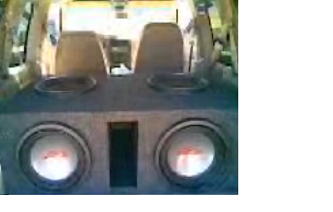

alpine Posted February 5, 2007 Author Report Posted February 5, 2007 This a box that i belive J_black built the deminsions are 7.2 ft3. Internal vol. BOX= 13.5H x 40.5W x 22.5D. External 15H x42W x 24D. It is tuned to 33hz. Port was 5 x 12 x 11.73 here is a pic but it is blurry because i copied it from a video.......... untitled.bmp untitled.bmp_thumb untitled.bmp untitled.bmp_thumb BANNED LIKE A MOTHAFUCKA IM BANNED BECAUSE IM A FUCKIN FUCKTARD
sean 371 Posted February 6, 2007 Report Posted February 6, 2007 nice you finally got it built. does this mean youre done asking for free box designs? hey, fyi, dont throw out dimensions, use volumes instead. and, of course, how does it sound? A couple links to some box builds: Tahoe Box 1, Tahoe Box 2, Nissan Titan, VW GTI, Mini-Bump, Hummer H2, Ford F-150 My own car builds (current setup --- under construction): Overall Thread, Kickpods, Dash, Back Doors Subwoofer Wall
