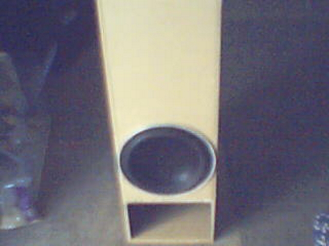

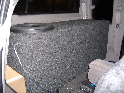

6- 15s in a T-line? how is that physically possible? It couldnt be a true t-line, thats for sure. A tline needs a port area that is constant with the cone area, and the length of the t-line is based on the frequency. if you were anywhere close to the orginal 32hz, you would see about a 9foot long (Per 15" ) with a port area of about 160-175sq inches (Per 15")... do the math, thats a little impossible, unless you have either a night club, or a 12 passenger church bus.Now, just 1-15" I can squeeze in a small hatch back area of a Ford Aspire, tune it to 40hz, with a 40hz bass boost, and see a 146db with 500 watts. but that box, tuned at 40 hz, has a t-line that is 7ft long, with a constant port area of 175sq inches. The box was 17deep x 44" wide, and 20 tall, and with the amp mounted to the seat, the seat didnt go all the way in place. just to show, a  real t-line is pretty huge. I know Toxic bass knows there sht, but I just think saying 6-15s in a tline, in anything driveable for every day, is a pretty HUGE feat. Maybe a super small ported box, with a 9foot long port, or port as long as the frequency desired, now thats possible.here are a few pics of T-lines I have done, just for 12"s ( one is 1 i designed for my buddy, and each box did well over a 140 with absolute min power- like 250-500rms)

i wouldn't mind hearing that enclosure, that's a nice design
