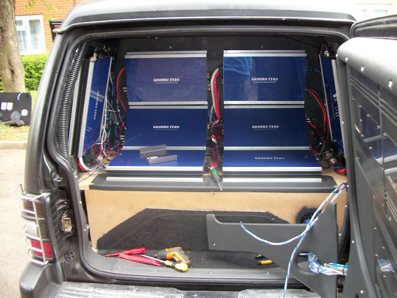

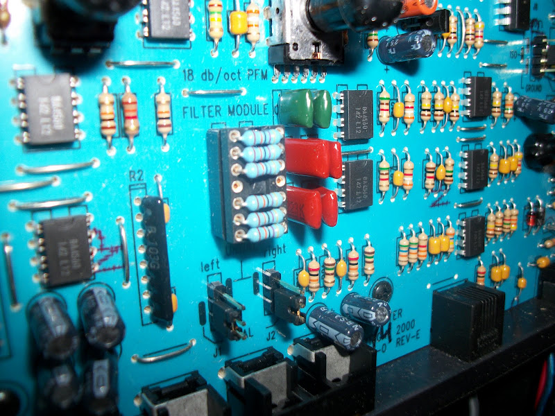

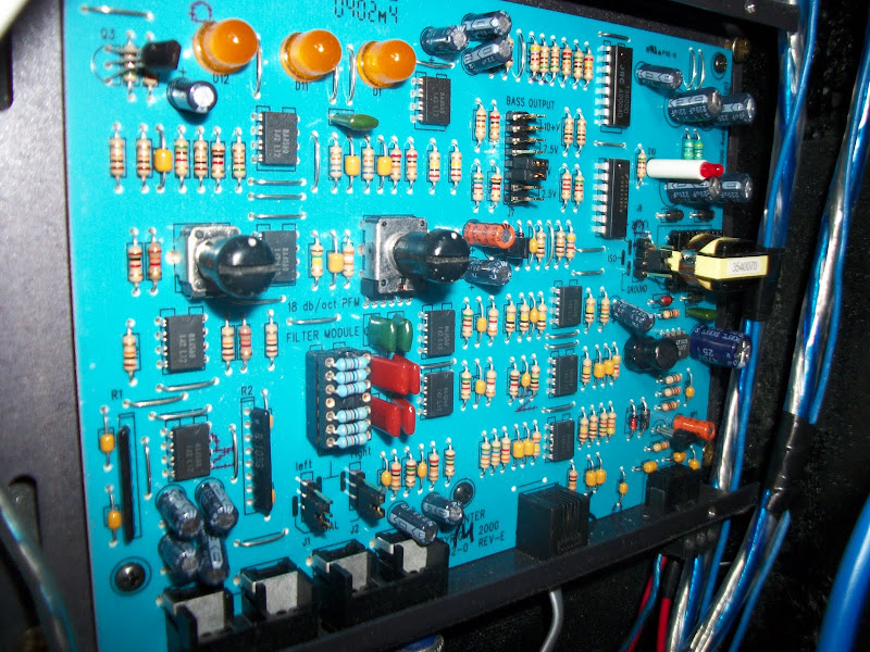

thejoose Posted June 20, 2010 Author Report Posted June 20, 2010 Gave big black a little bit of a check up today and fitted the 18hz subsonic was basically checking to make sure the cables underneath where still sfe and secure - a poor mans jack For anyone looking to change the standard 33hz subsonic filter in an epicenter (remember you low tuned guys this little chip is stealing your DBZ!!!!) here it is on the left of the pic with the 6 resistors next to the little red tabs - the stock one looks more like a chip than this custom made 18hz one (THANK YOU DIRTYDUBBER!!!) my 24hz module is going spare if anyone wants it at Ignition Extreme I also stripped down the amps at the back and tightedned every thing up following the 'is the back wall vibrating no its this loose amp here' issue Took Big Black out for a little testing session as well here is a little video that kind of demonstrates the clarity and volume of the front end - immense!! http://www.youtube.com/watch?v=Sa8xCmz6Xcs Dont forget to vote for Big Black!!! http://www.stevemeadedesigns.com/board/topic/80698-june-2010-sotm-vote-sponsored-by-audio-savings/ Sign up and vote number 11! thejoose Check out http://www.projectbigblack.co.uk and subscribe to stay up to date with the progress of Project Big Black Check out my videos on the Project Big Black youtube channel HERE updates also available via Twitter @projectbigblack UK Extreme OS 3+ Champion -157.3dB @ 30hZ- UK 149.9 Bassrace Champion - Talkaudio 2010 Bassrace League Winner, Propper Droppers Walled Champion, EMMA ESPL Master European Champion

cc_audio Posted June 22, 2010 Report Posted June 22, 2010 Will the epicenter still work properly if that subsonic was removed completely? And of course I voted you for SOTM, your truck is the hottest finished vehicle on SMD right now. It's all gone! The Celica Build Feedback If I buy something from you, DO NOT USE FEDEX!
lukaQ Posted June 22, 2010 Report Posted June 22, 2010 Will the epicenter still work properly if that subsonic was removed completely? And of course I voted you for SOTM, your truck is the hottest finished vehicle on SMD right now. I think you just won't have subsonic at all... Got carbon fiber dust cap???
cc_audio Posted June 22, 2010 Report Posted June 22, 2010 I think you just won't have subsonic at all... Yeah, thats the idea. My amp already has one I certainly don't need one before the amp. So I was asking if it would function without. It's all gone! The Celica Build Feedback If I buy something from you, DO NOT USE FEDEX!
thejoose Posted June 22, 2010 Author Report Posted June 22, 2010 Look alright but play some low hz... Will these do you fella? 25hz Window Open http://www.youtube.com/watch?v=IqcAO61EopE 25hz Door Open http://www.youtube.com/watch?v=cAaLJpUYTxI 3MCs and One DJ http://www.youtube.com/watch?v=QO51Q5K76T0 Will the epicenter still work properly if that subsonic was removed completely? And of course I voted you for SOTM, your truck is the hottest finished vehicle on SMD right now. Thank you kind sir - im glad you like it I was talking about this exact same thing the other day with Am Singh (the dude with the AA chevy astro) and he said it just makes the subsonic 0hz i am forever forgetting to turn the repic down when im done - so dropping some silly lows through my subs doesnt appeal hence the 18hz module being fitted Check out http://www.projectbigblack.co.uk and subscribe to stay up to date with the progress of Project Big Black Check out my videos on the Project Big Black youtube channel HERE updates also available via Twitter @projectbigblack UK Extreme OS 3+ Champion -157.3dB @ 30hZ- UK 149.9 Bassrace Champion - Talkaudio 2010 Bassrace League Winner, Propper Droppers Walled Champion, EMMA ESPL Master European Champion
lukaQ Posted June 22, 2010 Report Posted June 22, 2010 Yeah, thats the idea. My amp already has one I certainly don't need one before the amp. So I was asking if it would function without. with it, it would cut off faster and you could have it set at diffrent point, say one at 20, and on amp on 30 or something, at 20 it would cut off a lot more then just amp by itself Got carbon fiber dust cap???
cc_audio Posted June 24, 2010 Report Posted June 24, 2010 with it, it would cut off faster and you could have it set at diffrent point, say one at 20, and on amp on 30 or something, at 20 it would cut off a lot more then just amp by itself Yeah, I don't need two roll off points, plus I keep my tuning low already with extremely large drivers. Playing below tuning doesn't concern me, my subsonic is already very low. I would rather not have one at all. So I could remove that subsonic chip and it would work without having anything there? Or do I have to add something there to make it work? I can get epicenters dirt cheap but I wasn't impressed with my friend's. If I can custom tailor it a little more I might use one. It's all gone! The Celica Build Feedback If I buy something from you, DO NOT USE FEDEX!
