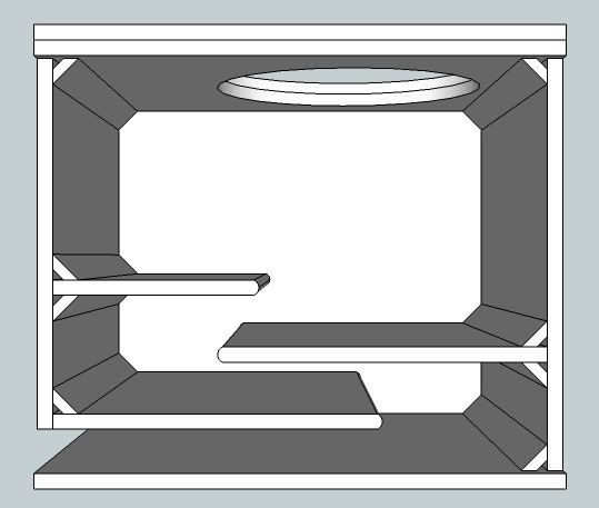

essentially make two circles.
the first one will be the cutout diameter
the second will be the outer diameter of the sub
offset the area inside the first circle (pull it down like you're cutting it out)
raise the area around the outer circle 3/4" because this will be your second baffle.
end result should look something like this
(took all of 2 minutes, but who's counting :D)
Wow I'm incredibly retarded. That was easy. Thanks.
by adding a flush-mount baffle does it effect the integrity of the second baffle and the strength it provides?
besides looking nicer, i think it helps with the stability and strength of the baffle, with two layers on top of each other, there is less likelihood of baffle flex
ive seen people double up on every piece of wood, not just baffle, but that is overkill id say unless your throwing a lot of power to it

New box design, still need to throw in the bracing and round some of the sharp edges. Working with it and the Torres calculator to get it just right. :good:
Edited by SenorPeligro
3 extra baffles?
im sure the program assumes the first baffle, and it appears you only have 2 in this design, so where are the other 2 extra baffles
Posted (edited)
I suppose only two baffles then. That puts me at a net volume of 3.55 cubes, with an approx. tuning of 26 hz. Is there such a thing as tuning a box too low?
