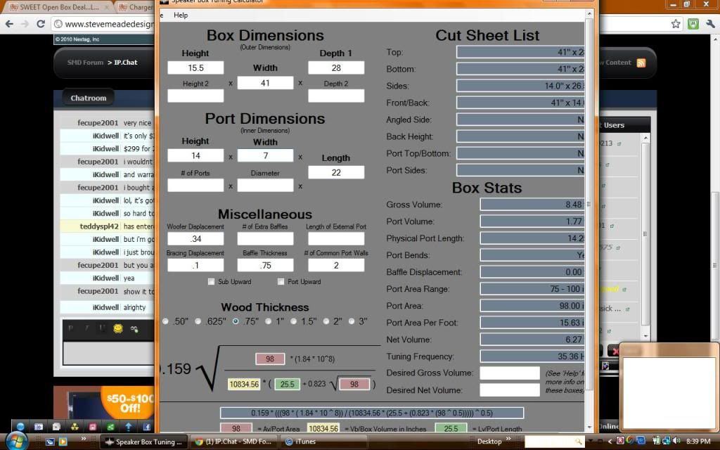

I decided since today is the first day of summer i would start building and getting ready for when my subs come in....
thats all for now...subs got upgraded from what i thought i'd have...2 level 4 with lvl 5 coil 15's are waiting to get built..xl and level 4 motors are at the chromer right now, should have subs before july :peepwall:

Nice! im in the same boat awaiting a XL 18" and ive got my box almost finshed too
Im pretty surprised to hear you say this tbh
Ill be looking into this build. I like all that port xD

yeah i know..didn't think i would..but after doing a little more research and talking with some people a little more it was going to be the best choice with the power i had (although i did have 6 level 2 10's in mind at one point yesterday). But all the port should be really nice and good for putting up some numbahz. at this point the box is almost done, waiting to cut out holes for the subs and decide if i want to flush mount.

is the box going to be laying down? or standing up. If its horizontal. flush mount. if its vertical just surface mount them unless you love crushing your fingers.
it'll be vertical..so no flush mount it is :pardon:
I'll probably get the same subs :peepwall:
Yes, that port should get teh deebeez! Bigger ports are usually more efficient if you didnt know. I'd say that the upgraded 4s could and would take the beating :drink40:
