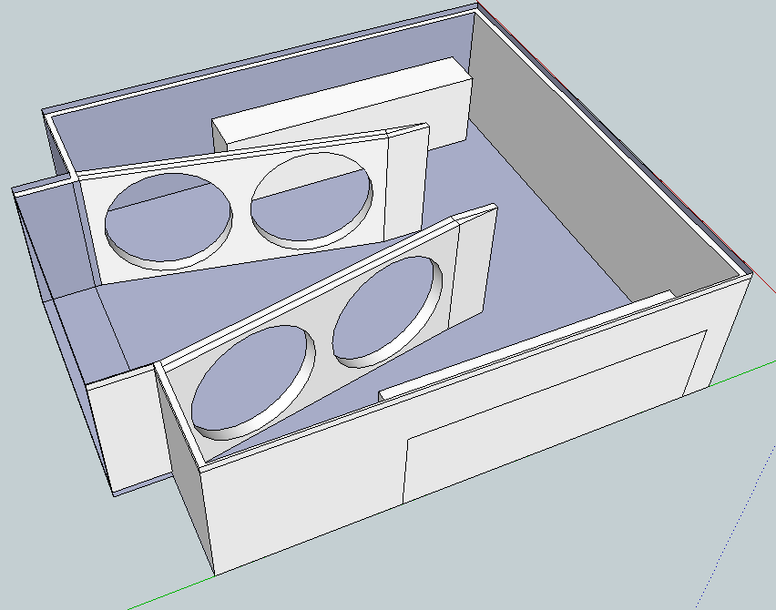

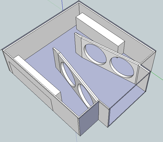

I've decided to down size to only 4 - 15s. What would I have to do? I want to keep the same width and the height at 16.75''. I've never designed this type of box.

Here is my attempt at changing it to a four sub box... :ehh:
The measurements are similar to the same as above except a little shorter (15.25'' tall inside). The back opening is 14'' wide and the ''blowthrough'' part is 27'' wide. The back opening is 16'' from the back. I know it's a little tight height wise but they should fit with a little strengthening.

take your sketchup. draw a line accross the back of the port to block off the "chamber" right click and go to selction > area (or something like that) it'll give you the square inches. multiply that by height and you got your cubic inches. divide by 1728 (that's 12^3) and you got cubic feet.
Design looks solid!
Try a smaller port
I wouldn't these boxes already have the innate ability to get lower then you expect due to double end correction on the port.
