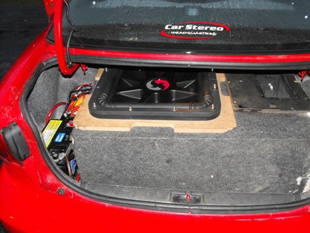

DK99 Posted October 17, 2011 Author Report Posted October 17, 2011 Here are the measurements that will work... H-13in W-35in D-25in Im not sure what my car peeks at so tuning and port can be suggested and this is my current box it sucks Hi SMD Members If anybody has computer problems and is an SMD member with at least 150 posts I will fix your problems for free by phone support or I can also fix your computer over the internet.... I have references such as All State insurance, Nationwide Insurance and much more... just p.m me for help.. I am not the greatest with when it comes to audio systems so I figured I could contribute to the forum this way.... Thanks David
CleanSierra Posted October 17, 2011 Report Posted October 17, 2011 Drop the 18 and get something else. What kind of airspace are you dealing with? That sub is totally loading off the top of the trunk. If you went with something else(smaller) you could probably sound cleaner and louder. Im not the one you want to try to troll. Just a fyi for you.
DK99 Posted October 17, 2011 Author Report Posted October 17, 2011 Drop the 18 and get something else. What kind of airspace are you dealing with? That sub is totally loading off the top of the trunk. If you went with something else(smaller) you could probably sound cleaner and louder. I don't have the funds to go smaller I got this sub cheap I would like it to load to the back or side... Hi SMD Members If anybody has computer problems and is an SMD member with at least 150 posts I will fix your problems for free by phone support or I can also fix your computer over the internet.... I have references such as All State insurance, Nationwide Insurance and much more... just p.m me for help.. I am not the greatest with when it comes to audio systems so I figured I could contribute to the forum this way.... Thanks David

CleanSierra Posted October 17, 2011 Report Posted October 17, 2011 Throw it in the back seat? Im not the one you want to try to troll. Just a fyi for you.
