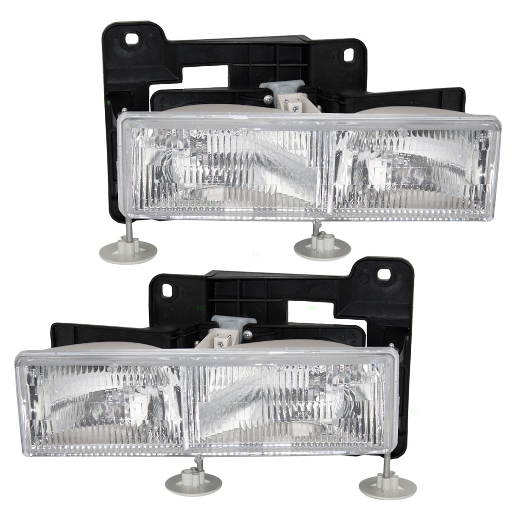

I will vouch for diamond cut lenses vs stock lenses that have the diffusers or ridges that scatter the light even more.
The shape of the lenses also seems to have a lot to do with it, a lense that is not to high and has very little horizontal relecting will not glare no where near as bad as a housing that is taller and rounded.
Every headlight assembly is no where near the same, some are worse than others. As I stated on the other thread where your acting like a know it all, ive stated my thoughts with pictures.
But what would I know. Ive probably only installed 50-70 sets. retro, stock housings, factory projectors, ebay projectors, aftermarket diamond cuts, and also have a wholesale account with DDM, god is that pricing nice....
Something with rounded headlights like this where the rear reflector is all the way around is going to scatter light more in all directions
vs a headlight that is not as high and has no horizontal reflectors to reflect the light up into the trees and every where else like these.
and than when you have a oem or replacement headlight assembly with the diffusers in the lense, you will also have a lot more glare due to the diffusers shooting the light all over.
Like these.
In no way am I saying projectors are not the correct way, however everyone does not want to spend the time or money to retrofit their lights or pay someone to do it... IMO I almost think my truck without projectors has a much cleaner cut off than my Cadillac with factory projectors, but again the projectors are made for halogen lighting, not HID, and well the factory halogen projectors seem to be 20X better than the cheap ebay headlight assemblies.
