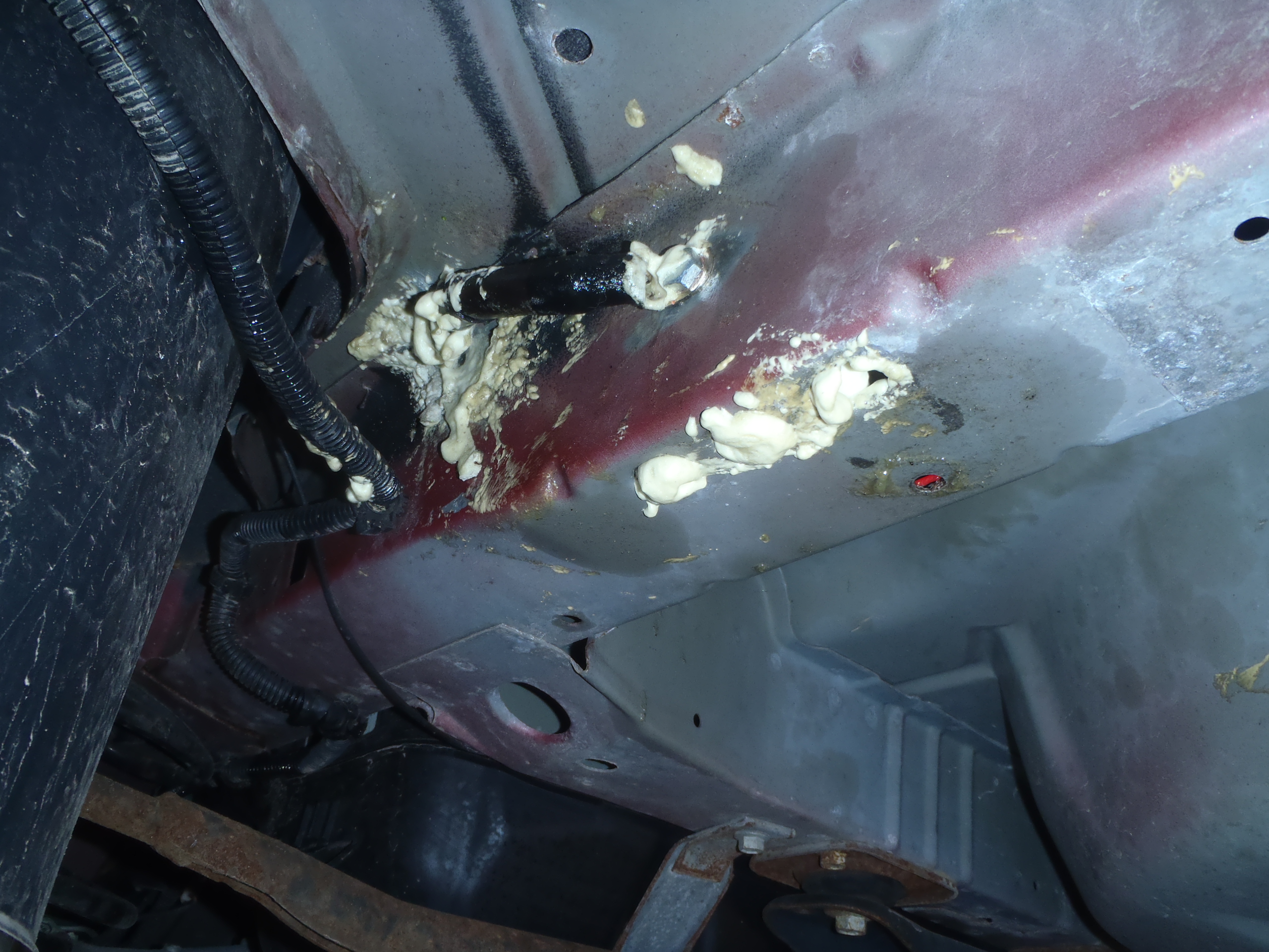

oeking87 Posted July 3, 2012 Author Report Posted July 3, 2012 This is the wire form the last pics bottom to frame of car.

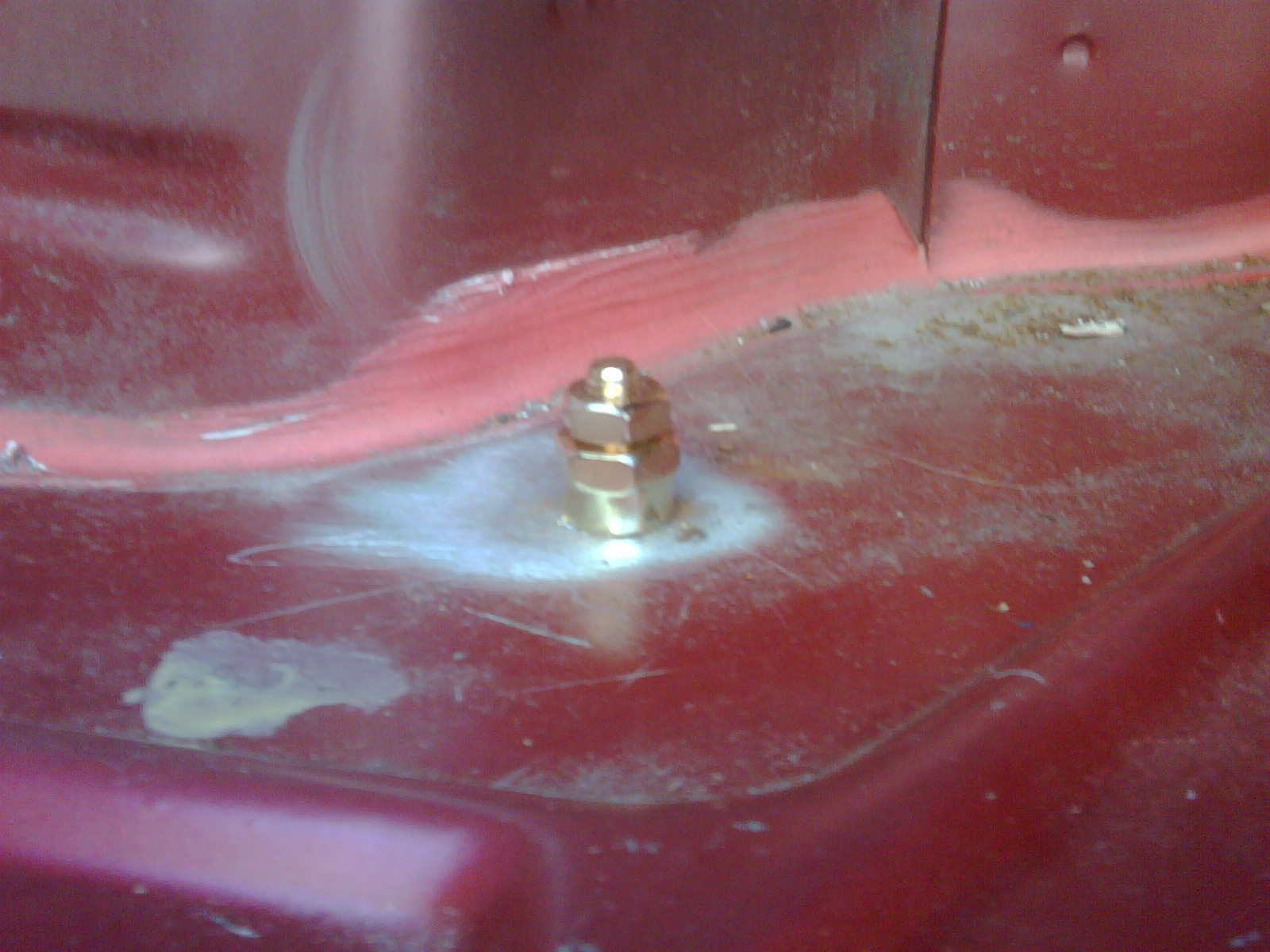

oeking87 Posted July 3, 2012 Author Report Posted July 3, 2012 I have some Q's so bare with me and be patient. I'm just trying to eliminate some causes and trouble shoot. Since this thread is all jacked up right now i want to get back to square one. 1. Could you explain your ground a little better. "A gold battery post ran threw the car "paint removed" with a 1/0awg wire outside running to frame so to points of contact." That confuses the fizzle out of me. 2. What kind of vehicle is this? 3. Where is the voltmeter (in your video) hooked to? (front battery, read battery, amp?) 4. Is this cutting out, a sharp cut off, or does the bass just fade in and out? 5. Have you tried playing one sub at a time? ( I realize this might be a pain in the rear to do but it might pinpoint whether or not it is a faulty sub or lead ect) 6. Can you post some pics of your grounds and other connections for us please? Don't take this as me doubting your connections and stuff, It's just that sometimes a simple thing might be slipping past you. Sometimes when I have issues with a system I just need to step back and look at the big picture or get a second set of eyes on it. It just happens because I am too close to the issue or over thinking something. We all do it, part of being human I guess. 2004 Buick Lesabre Limited. Voltage Meter Is Stock Its Built Into Car. Subwoofer Cut Out Sharp. And Im Going To Try Subwoofer By Subwoofer This Weekend.
