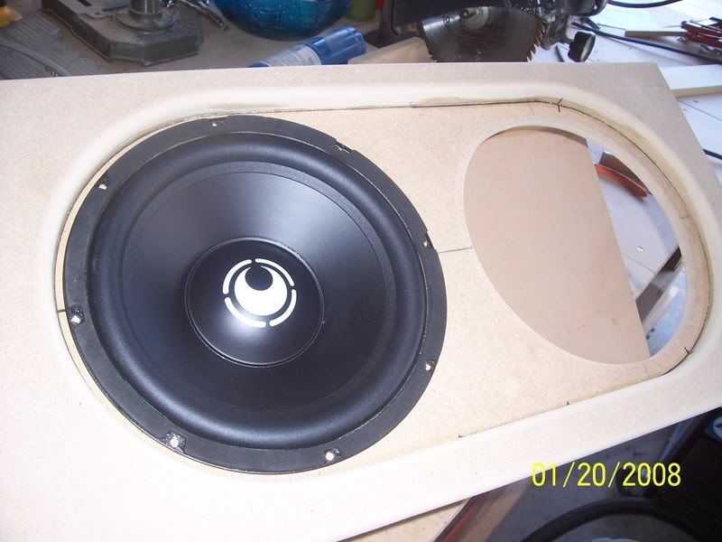

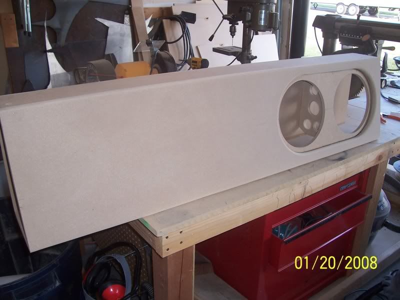

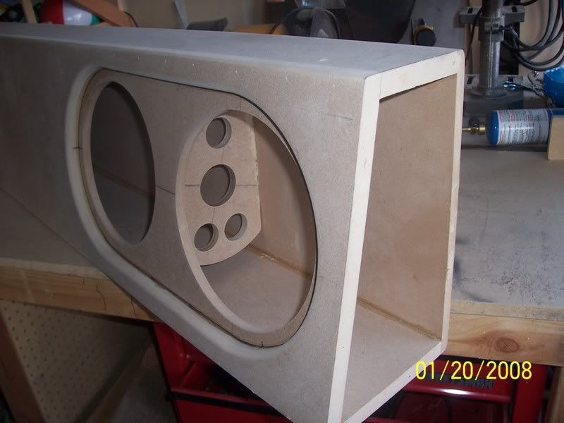

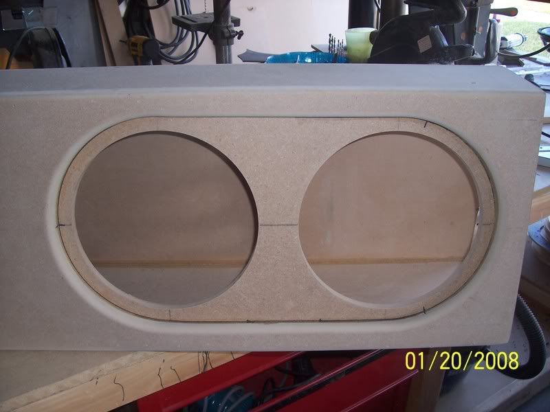

I'm replacing my undersized single RE10 box with a small double RE10 ported box. Here are the build pics. I didn't pic up the other woofer yet. This keps m from rushing the box and doing a crappy job. The plan is to vinyl the box, unless it sounds bad.

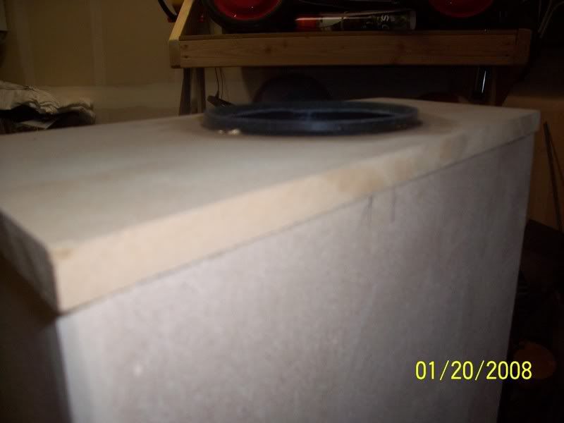

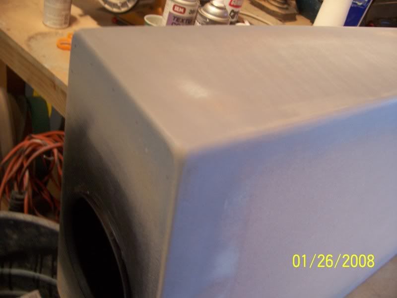

in this pic i have the port out 1/4" to flush with the vinyl side panel. I will have side panels so the seam is pretty

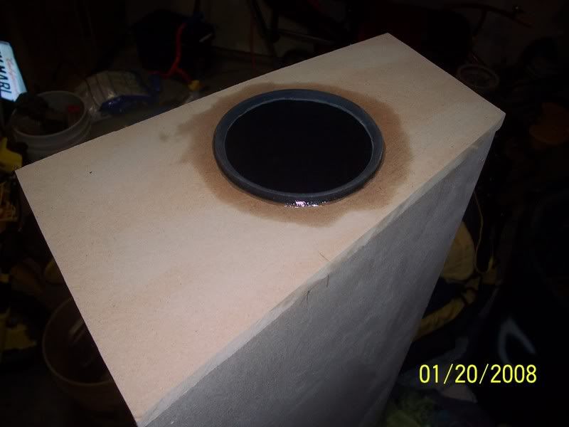

the port is actually a 4" dia. that box sounds ok. i think i want to double my power. the little 400watt amp isn't enough.

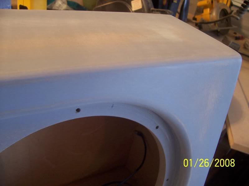

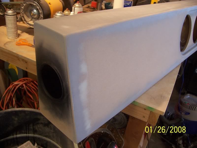

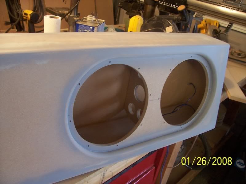

got some more done. the box will be vinyl so , in my eyes, it has to be paint quality or it wll show through the vinyl. So some filler and some sanding on all the seams. a little primer to check them and ready for vinyl. I still have end caps to make so thats why the ends aren't filled and thats why the port sticks out a 1/4"
