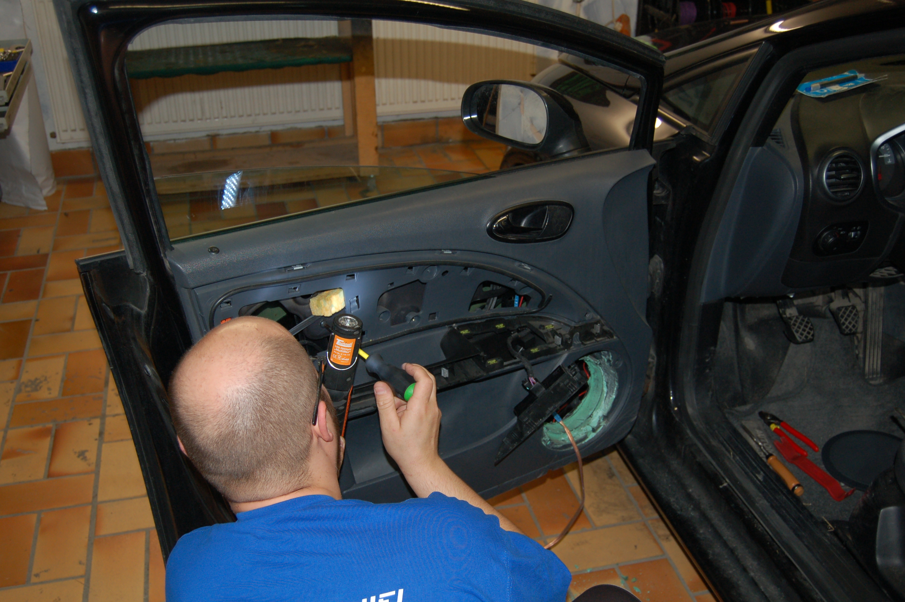

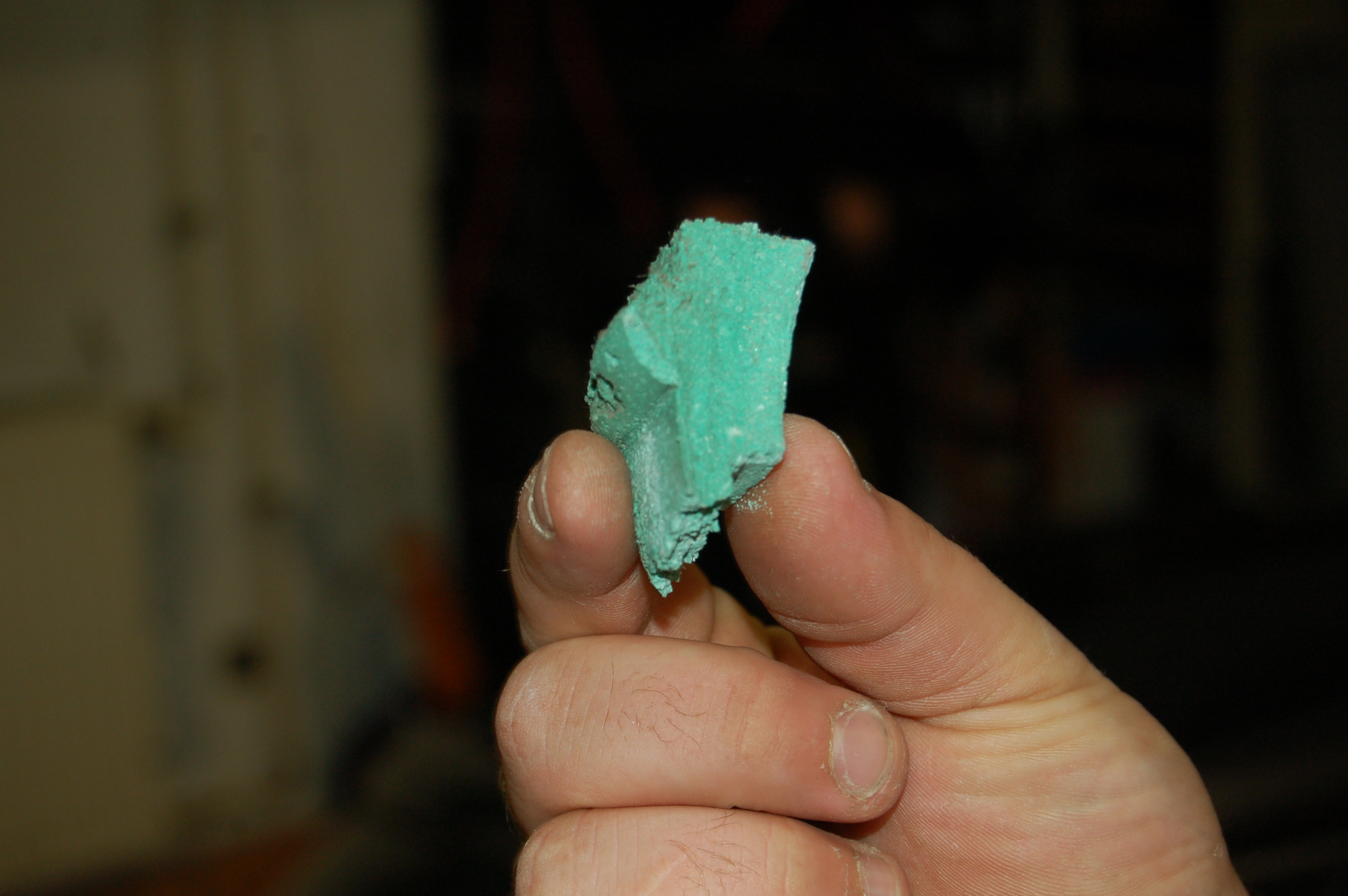

at first we opened the doors to insert the 8 inch speakers... ignore the green stuff, thats not in my doors anymore...
while we removed the "silitec" (the green stuff) from the doors, (because its really really useless...) i asked me: is that the stuff superman is allergic to?
to remove the doorboards, i got help from peti (thanks a lot at this point...)

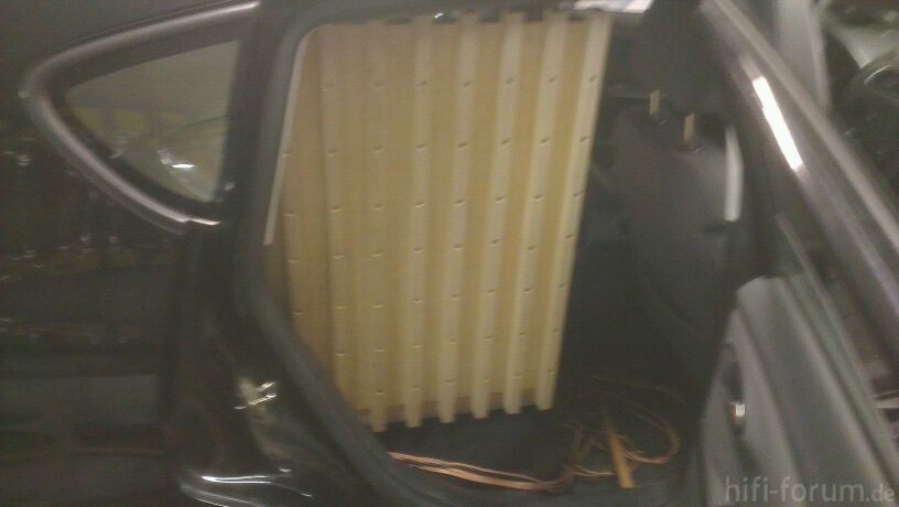

before we installed the doorboards again we insulated doors & roof:

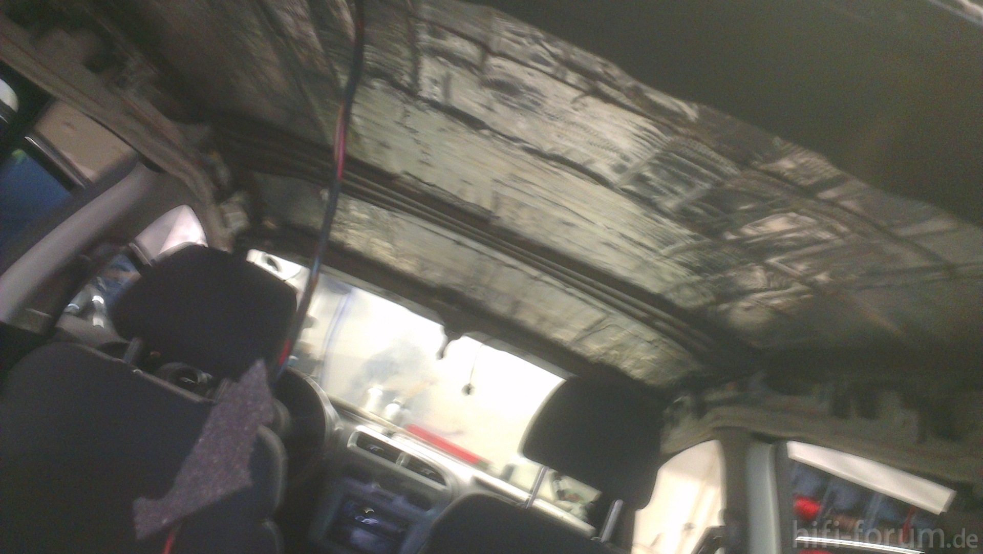

Insulating the Roof with STP BOMB

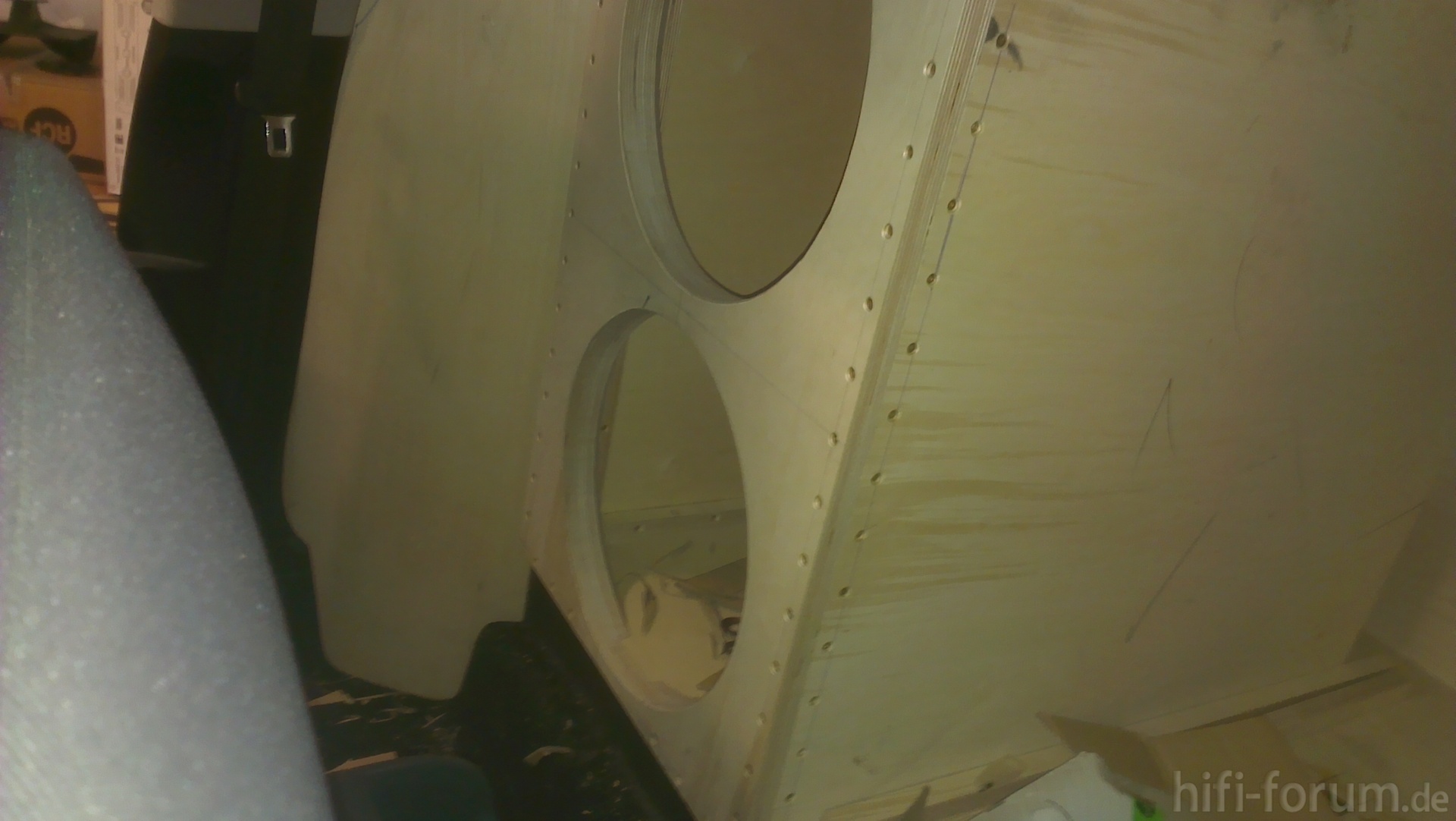

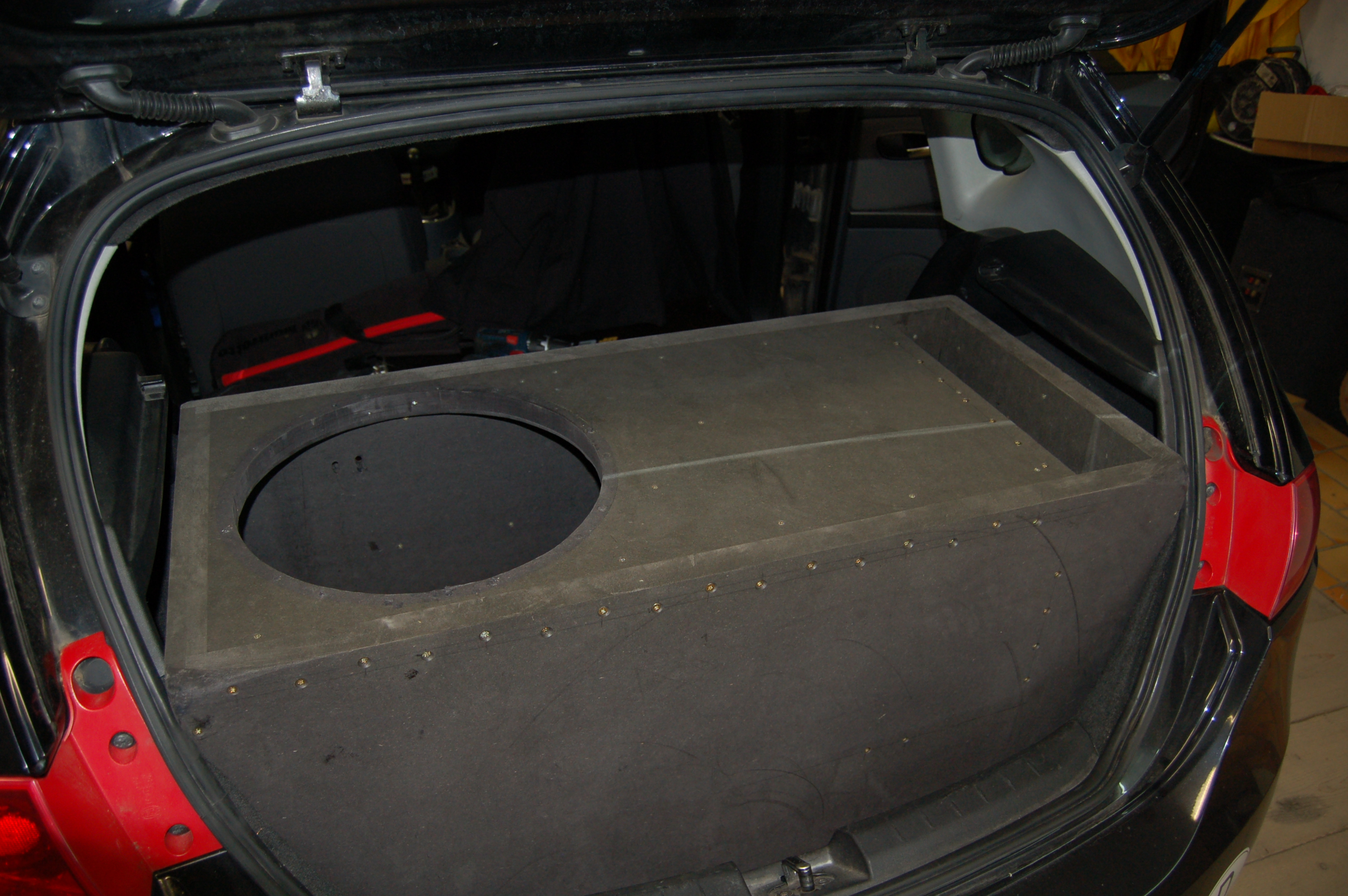

Then we installed the box in the car :D of course... the backseat had to go :'(
then we installed the batteries and the copper rails (... sorry for my bad english btw... :D )

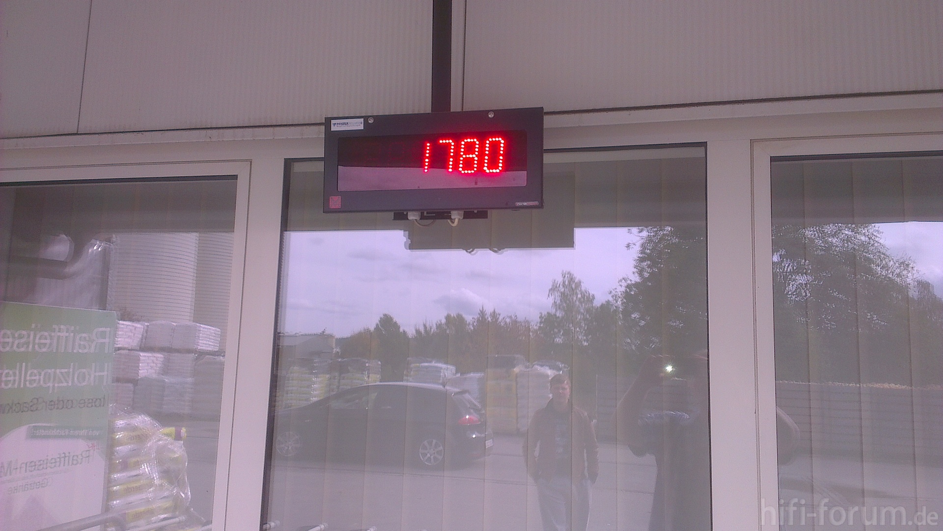

After that we checked the weight of the car... 1.8 tonnes are okay... heres the result:

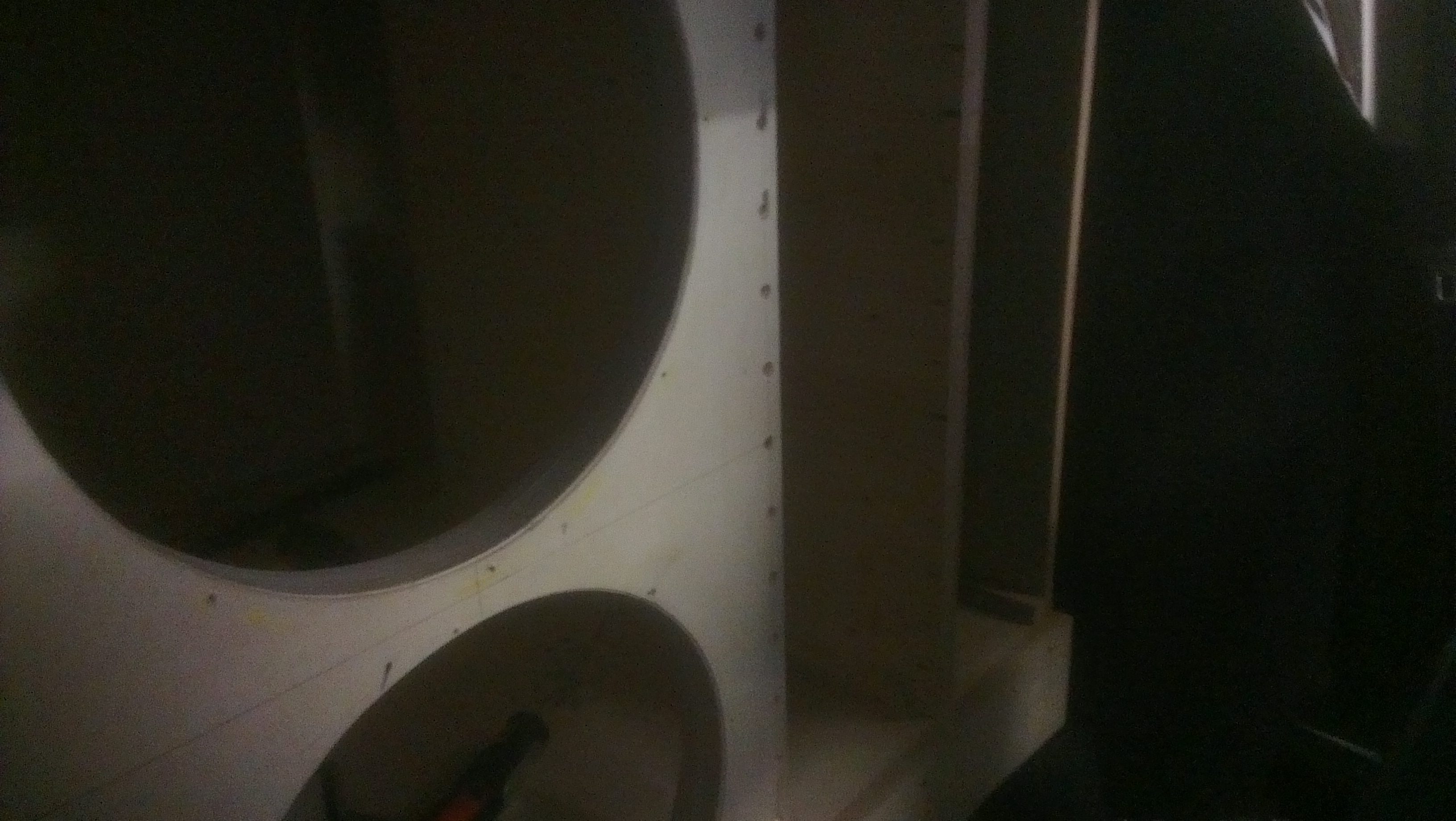

today we got the box lower... but what teh fuck , i wanted 30 hz... now im tuned at 23 hz... REALLY LOW... toooooo low for normal music use.
that means... tomorrow again and making the port a little bit shorter... :S
hair trick at 24 hz... dbzz and killowatts tomorrow... im tired now... sorry guys ^^

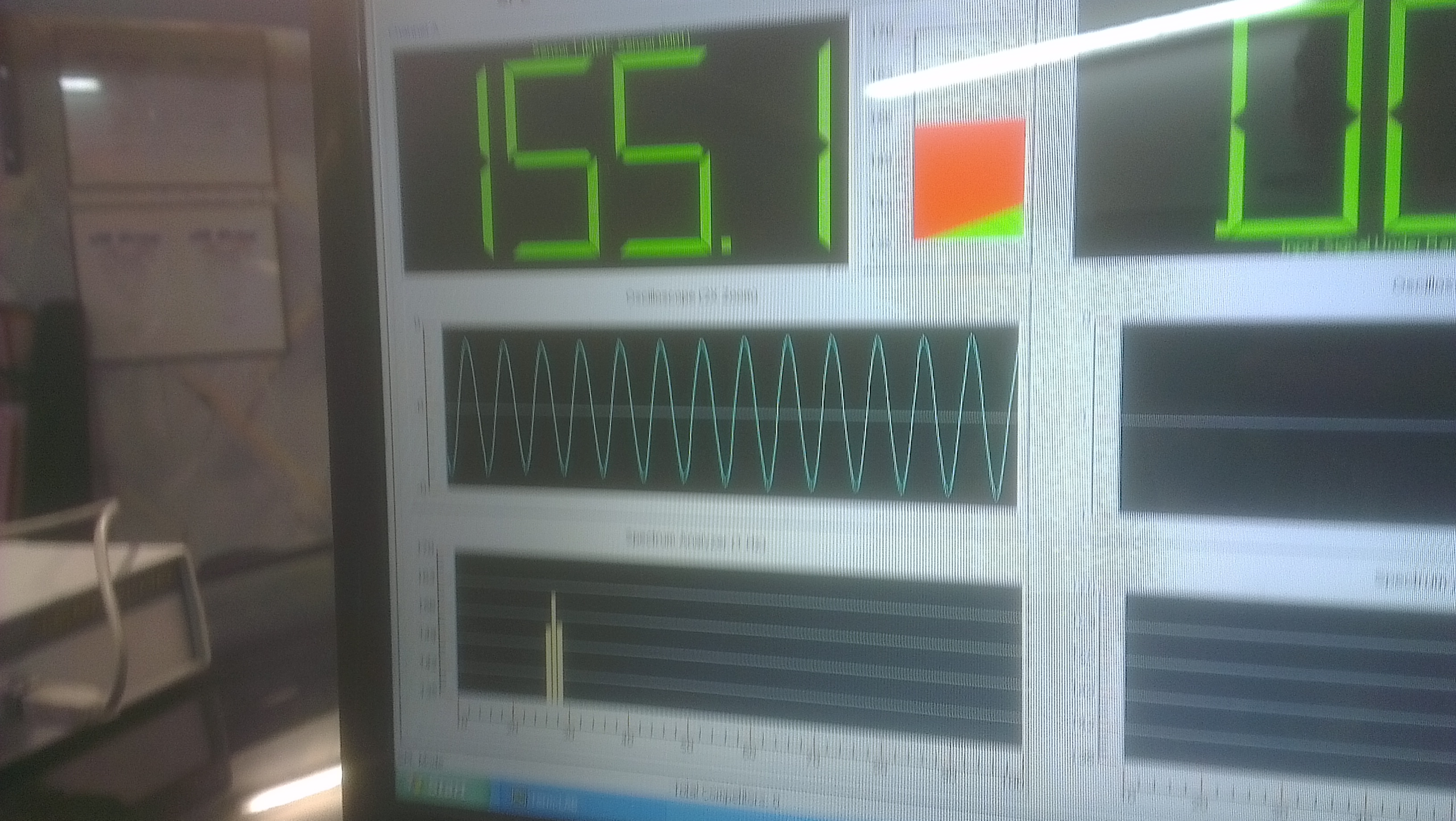

at first id like to show you the 27 hz try... its better for the woofers
155.1 at 27 hz

then we removed the beasts... again... to getting up from 24 hertz to 30 hertz... normal music use business and so on ;)

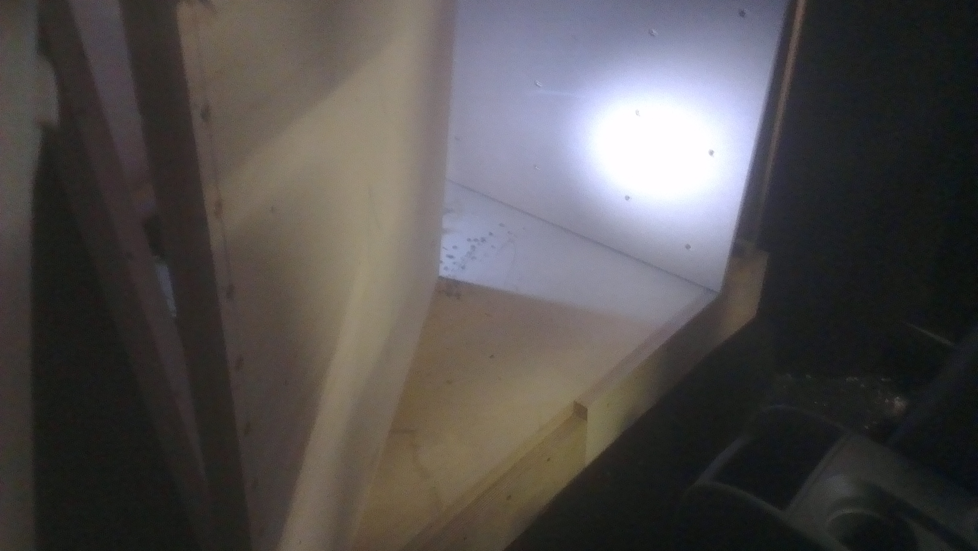

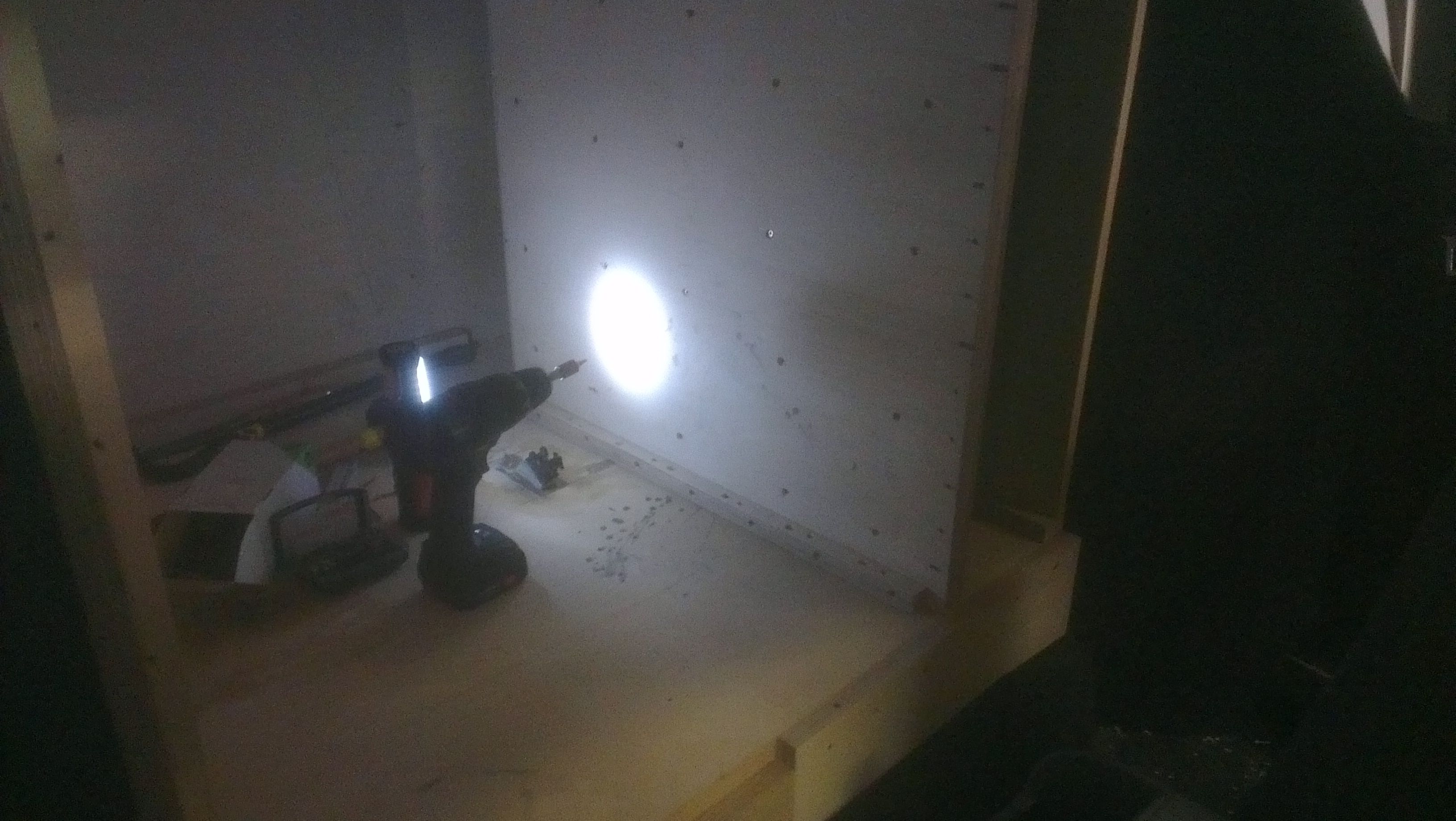

a last pic from the wide-ported box ... (yes its the 35 hz tuning... now the port is about 7 inch samller)
removing the port... ouh shit, what a tight and difficult quest
... shit... i had to sort the screws ... :D

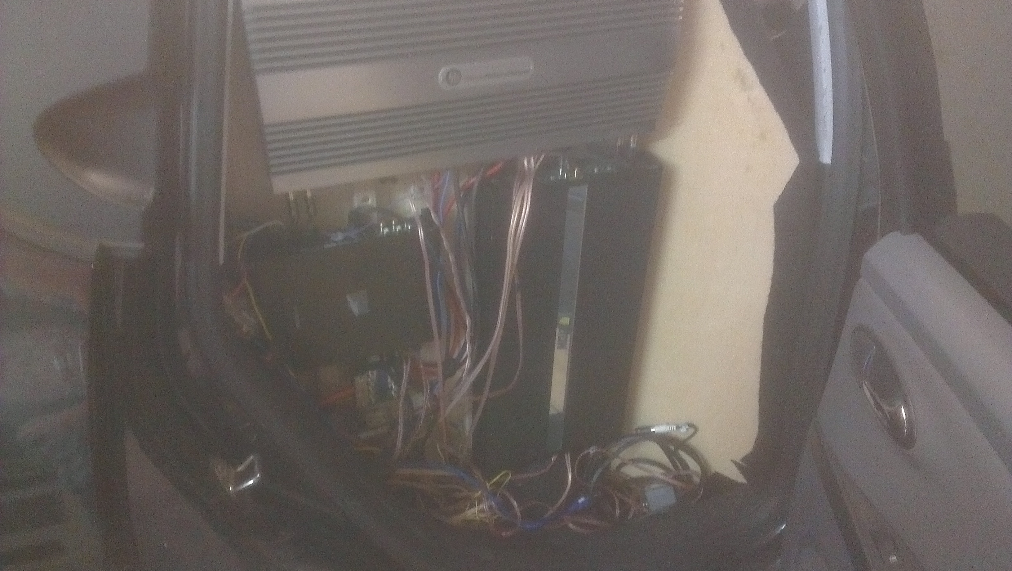

... and my service door... the heart of the sound (processor... high and mid amps... )
sorry for that ugly cabling... it gets better in the near future... i promise... the install is not finished... its only "ready to go"...
now we're putting the new port in the box
then we inserted the front plate for the woofers
no close the middle "hole"... inserting the woofers... and we're ready for take off:
... enough from the pics... now the box is tuned at 30 hz... with a 155.4 at 8.6 kw's at 30 hz... thats what i want...

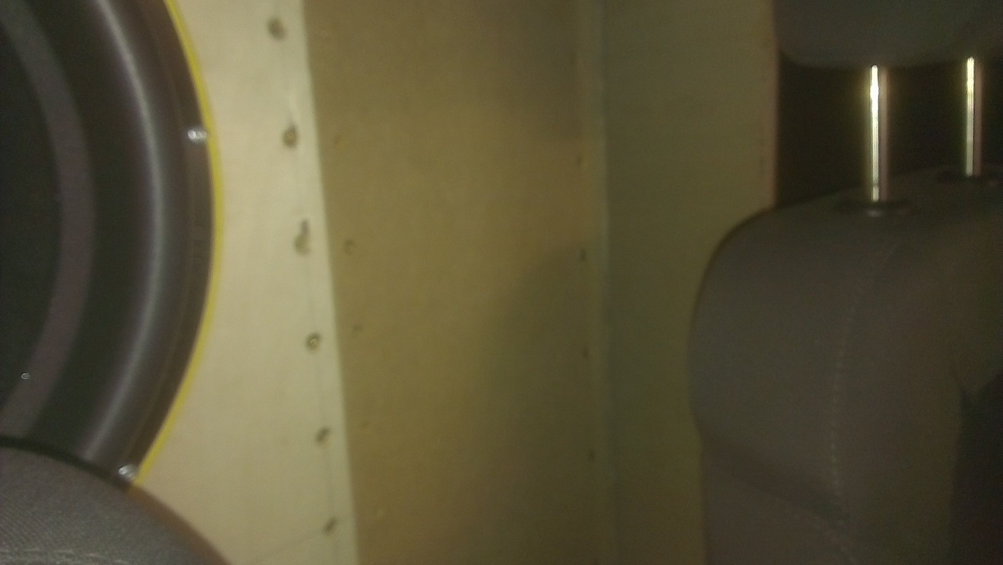

At first we had to remove the port, because something BIG is coming:
now replacing the front plate... for 4 15" woofers
now placing the subs... and do some low business ;)
