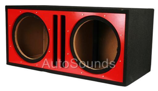

KeaganH6 Posted January 10, 2013 Report Posted January 10, 2013 I am getting a Quantum Audio 1500 watt mono amp 2ohm and two 12in d6 dual 2ohm Diamond subwoofers. Amp Model #: QB1500D Sub Model #: D612D2 How much power RMS will each sub be getting ? Am I going to be overpowering or under powering ? What should I look out for so that I do not damage my subs or amp ? I am worried that I got decent sub woofers but a crappy amp or an amp that is not powerful enough. Also on the quantum audio site it says the amp is 1 x 1500 Watts @ 1 Ohms Mono but any other site I look at says that the amp is 1 x 1500 w @ 2 ohms. Isn't that contradictory ? My box is a dual 12 red ported box, looks like this: I payed about 480 for all of this installed, tax, wires, everything...did I get ripped off ? I have a 2004 4 door honda civic and I have a Kenwood face unit and I have kicker door speakers..I do not know if that will help answer my question
