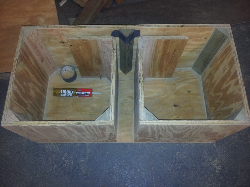

Well the speakers have shipped and the box is almost done... Here are a few pics of the box being built... Just need to find something to finish the exterior with...

A few things to check are that the port width on the lateral ducts is 1 3/4" and to round a little the inner side of both ends of the port like shown in the pics above. I will add that is a very clean woodworking job. Must have a nice tools stash.
The rear corners of the port have been cut like the drawing and the rear insert has the 1 3/4 clearance (not glued/screwed in place yet)... Well as for the wood working I wish that it was done with my hands but it was not, the box is being built by one of the 'Wood shop pros'... I told him what needed to be done and got the parts to do the job... I got the e-mail that the speakers have shipped and should be in my hands in two weeks or less...

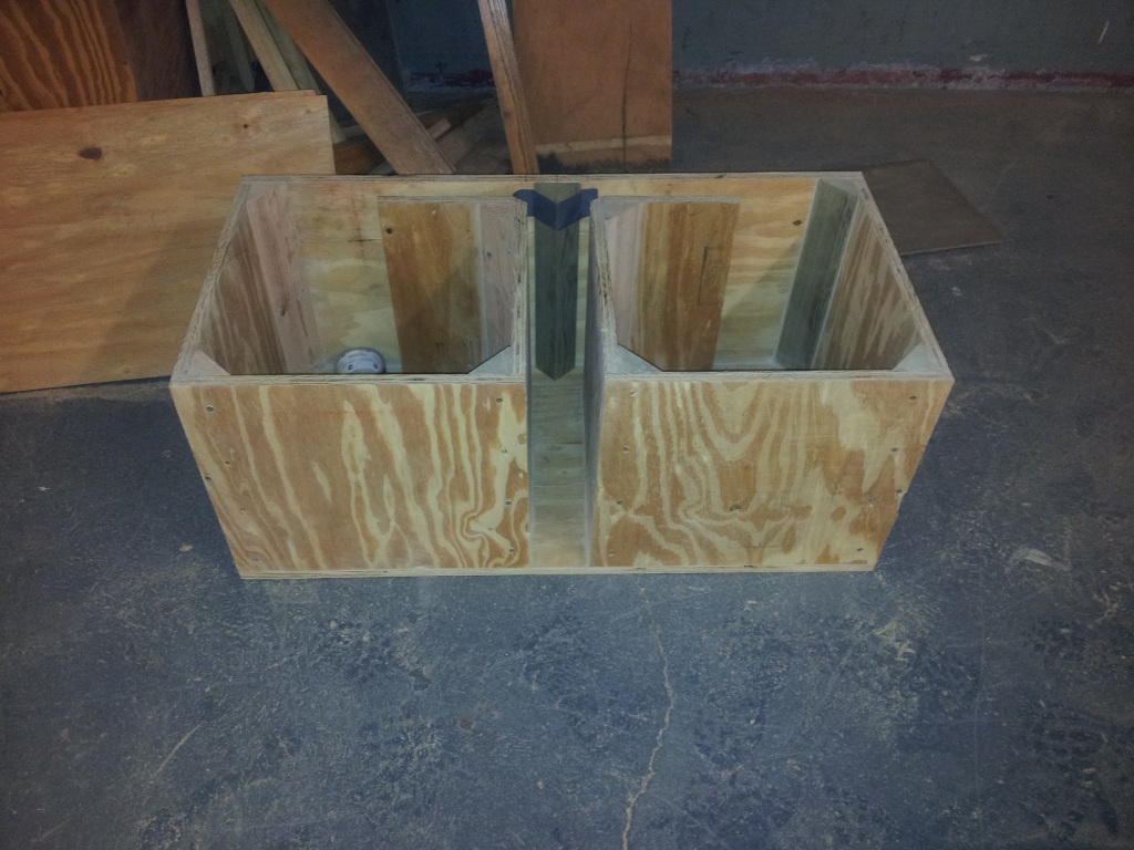

Here is a shot of the test fit, still need to cover the box with something... But other than that the box is just about complete... I made four holes for the bolts to feed thru on each side so I can change the ohm load without needing to pull the speakers out...

Great building job without a doubt.
