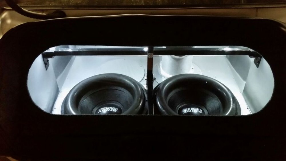

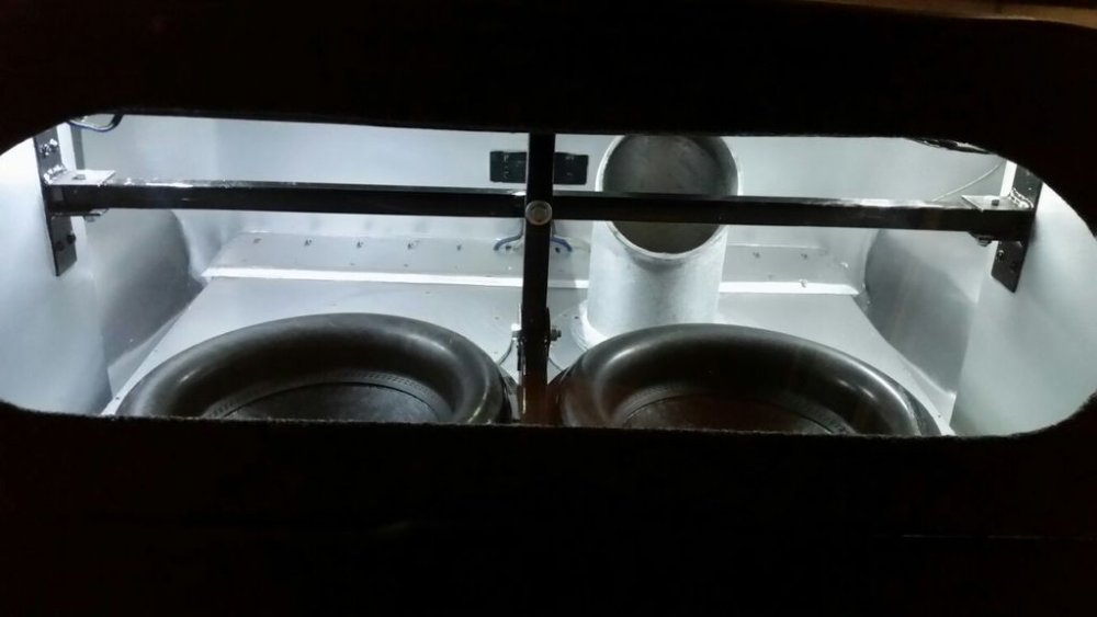

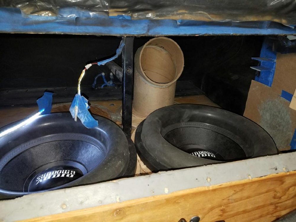

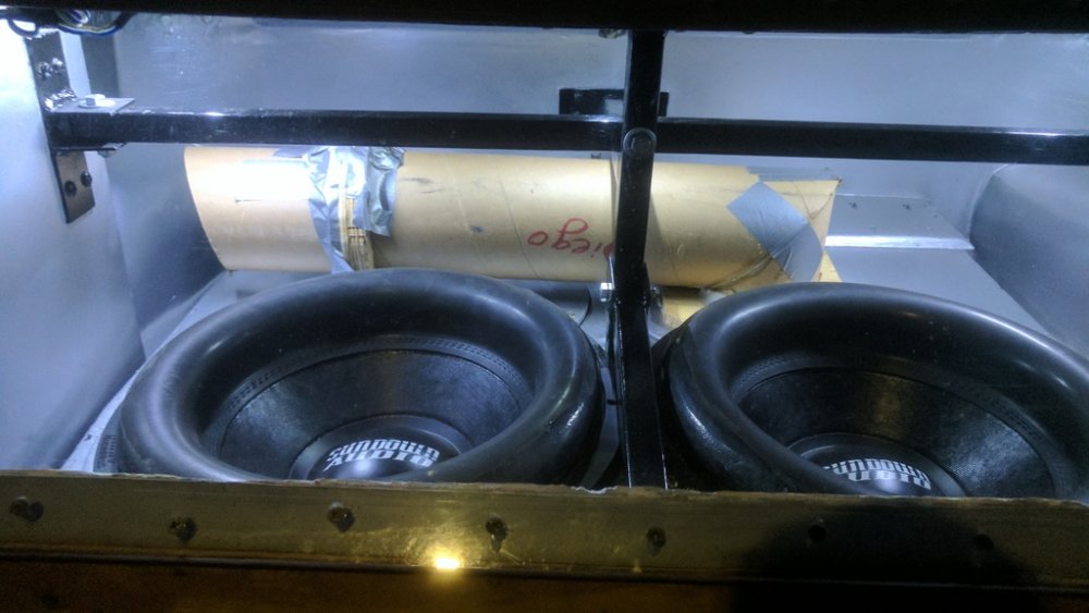

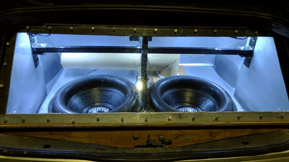

ok updates guys, so ive been working on the build off and on, made some adjustments, box is starting to dial in, currently playing with rear port. I fixed the roof but i was talked down to use epoxy instead of welding it, turn out a fail so i will be addressing that down the road, heres a couple of pictures
IMG-20161017-WA0001_zpsngfm2phs.thumb.jpg.2335c6b6bd329f6d8fb1a0fa511bfd6d.jpgIMG_20161106_205416_zpsb7wzfuaq.thumb.jpg.8e494a07cb68f1061779d24b4fcab7f4.jpgIMG_20161023_220250_zpsecnahtnw.thumb.jpg.f50f55ebee32bc5380c0dbfdfb82c858.jpg123951_zpsiisbetfm.thumb.jpg.b49d1842dfffd1352d45ce165ec553b7.jpgIMG-20161017-WA0002_zpssoxjuot6.thumb.jpg.a9a6ebe94a4a4b1ffdb56406d8dfec5f.jpg
Yeap yeap you have a-d-d bro you can't leave nothing along for long. Ha ha , looks loud dude. Always liked this build, because of the audio in it. but most of all the detail in your work with no half stepping. Always watching for updates on this build.
I used rivets and a pop rivit gun to add bracing to the metal straps on the roof. My buddy has a metal shop and the first thing he said was my sheet metal was so thin that trying to weld it would make the metal weaker so I used rivets. he was correct, my mounts for stripper poles are held in using 8 rivets per flat stock. Couldnt be any happier.
