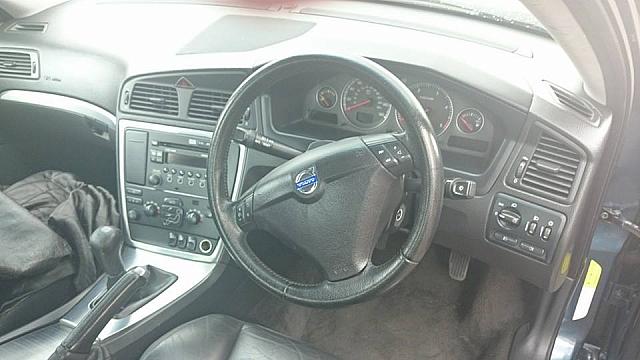

This is my volvo
10270578_699997480065324_460077236718653
10513536_699997576731981_726770738951728

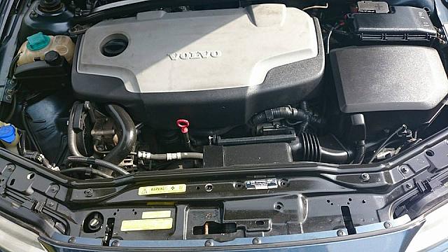

It is a 2005 Volvo s60 D5 so it comes with the 185BHP 5cyl Diesel engine mated to a 6speed manual box, pretty good engine

It is fully loaded with all round leather seats - heated fronts, climate, cruise the works.

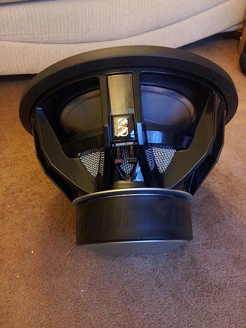

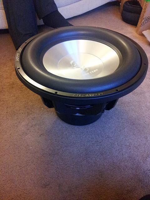

2 Ground Zero Nuclear 15inch woofers

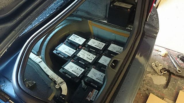

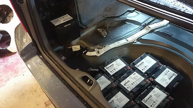

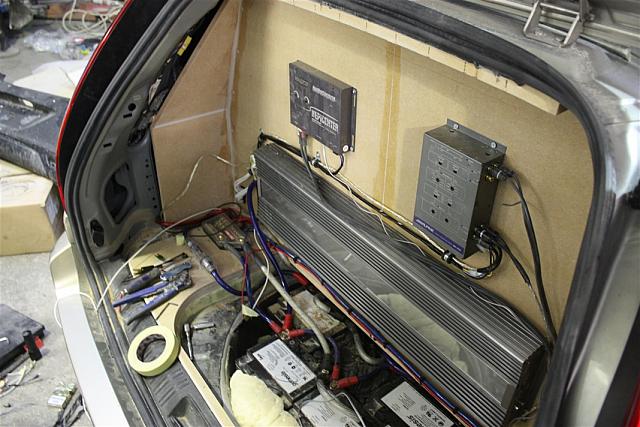

10 hawker Genesis batteries, here you can see me test fitting them in the volvo - they all fit in the wheel well and to the sides with the stock battery, ontop of these i have a Odessey pc1500 to replace the stock battery

And an Epicentre

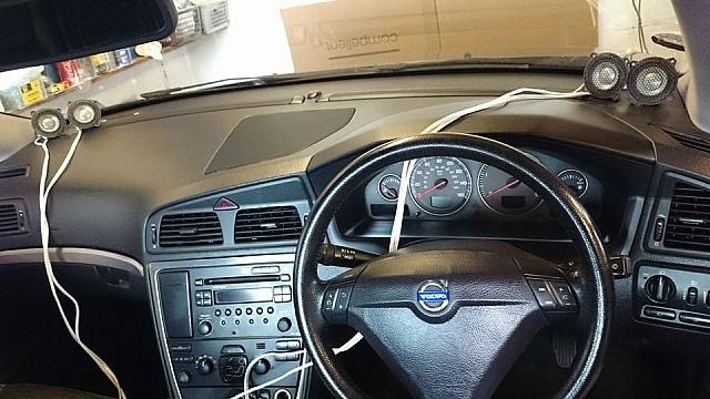

So the plan is to mount the full range speakers on the dash, already done some testing to make sure they sound alright on the dash

They are pretty good - tbh for the positioning testing i was running them free air using a phone as a source into an amplifier way too big for them but they still sounded pretty good. Treble was a bit harsh for me but im sure that can be sorted easily via an eq
