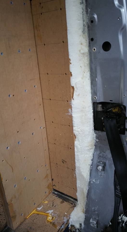

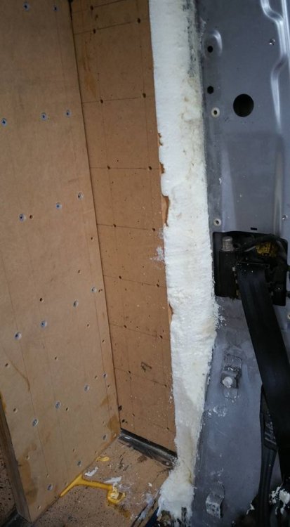

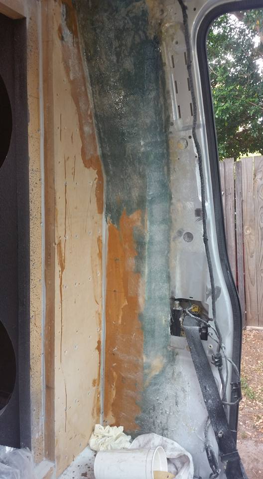

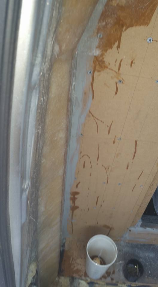

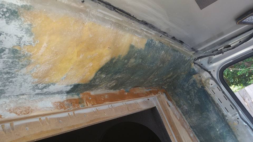

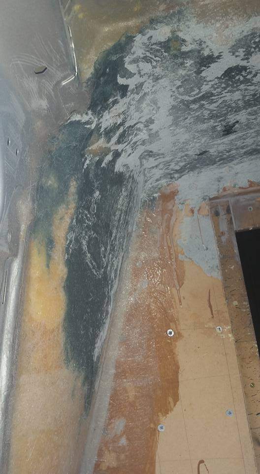

im45pl Posted January 28, 2017 Author Report Posted January 28, 2017 So i finally got off my ass and sealed the box to the b pillar, i was looking at some fancy fabrication way of doing this but in the end i just expanda foamed the gaps, shaped it, used some fibreglass reinforced body filler in the low spots then added a few layers of glass. Now it just needs to be filled and sanded TEAM DC AUSTRALIA My_Build_Log
