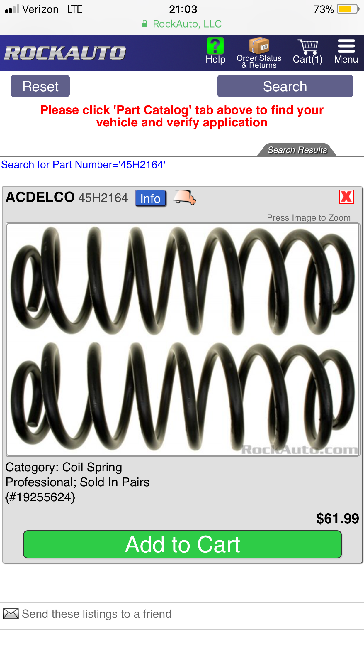

Z71 springs should help bring that rear end back up and level with the front if they haven’t already been installed. Much mo betta than the stock springs on the LS/LT Tahoe and Yukon. 9BFF6558-0CDF-47D6-920F-14CBF36CAD7D.thumb.png.166e85b0e8825a0fb45b8a937b7b356b.png

thats cheap AF!

Yes. I put those and billstein 5100’s on mine. With the front 5100’s set to stock height (adjustable up to 2”) my rear sits a few inches higher than the front without weight, so I’d imagine with the weight you guys have, it would probably bring it a lot closer to or right at level with the z71 springs. Maybe a coil spacer with them if needed. I don’t know about that walled life though.... :p
I can take height measurements later and let you know what the difference between my front and rear is to give you an idea. Before I put the coils on, it was maybe an inch difference
