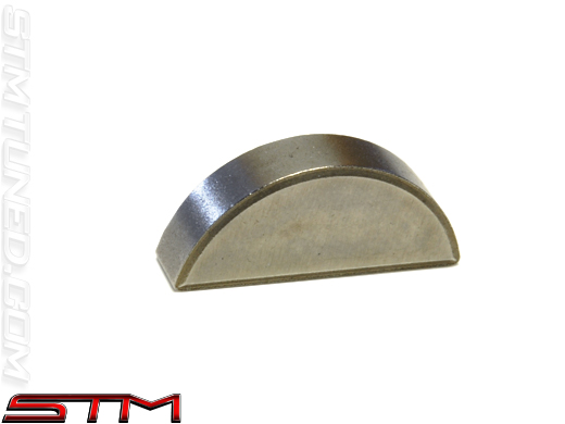

Not sure if you mentioned how you were planning to make your tablet popper (I guess you could call it lol) but I had an off the wall idea.
I think you said it only need to push it out a little bit so my not use a motor with a half moon cam key mounted on it and a momentary switch? So it will rotate when you hit the switch and push the tablet out to where you need it then you would push it again to rotate it back around so the tablet can sit flush.
Like this: oem_4g63_crankshaft_key.jpg
Not sure something will be coming through back plate in your design but it was a random thought i had. You would put the mounting hole center bottom towards the flat side of the cam.

That's not a bad idea really.
My plan was to have a micro actuator, I think we posted a link previously in the last page or two. It would have a 1 1/2" or 2" extension. Build a bracket so it's straight behind the left side of the tablet, right side is where the connector is. Then when it extends it'll extend straight out, and straight in when back of course.
That is a good idea though. I'm sure I could make something like that Half Moon Piece and I have a motor in my Arduino Kit. Maybe I'll have to try something with that this weekend.
The tablet really only needs to lift up about a half inch on the left side. The pocket thickness is about 1/4", and then another 1/4" would be perfect to get my fingers behind it and pull it off of the connector.
Thanks for the suggestion. I appreciate it.
