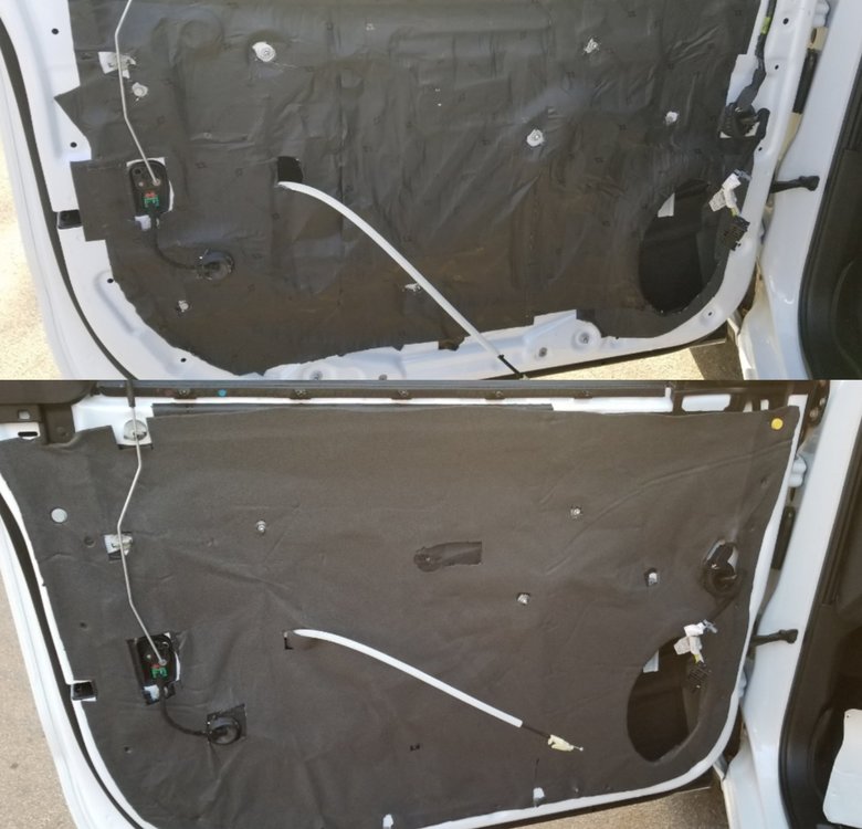

Usually goes between deadener and mlv. In my case im not using mlv on my doors but i wanted to decouple the door panel
Top is deadener. Bottom is ccf over the deadener

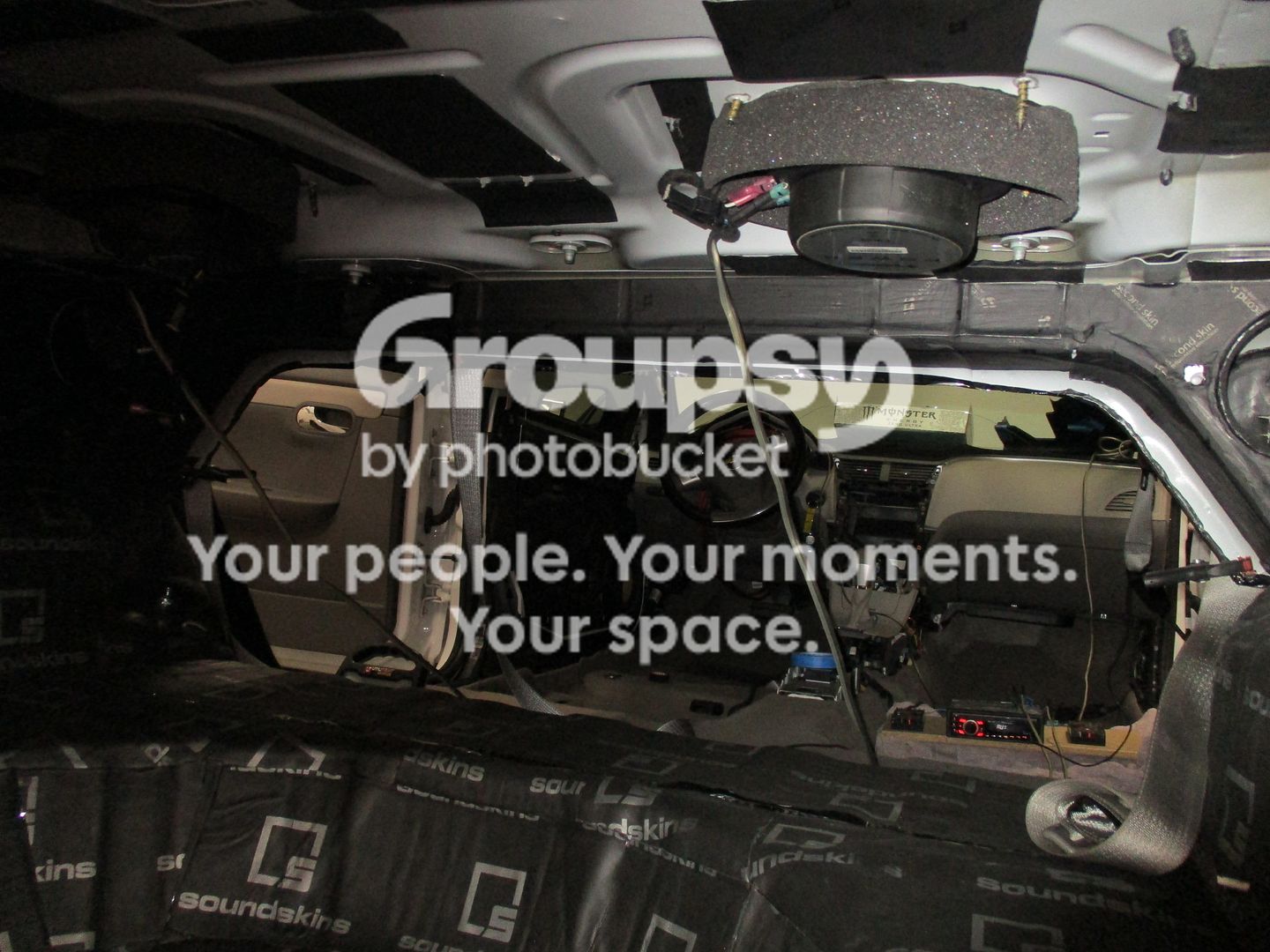

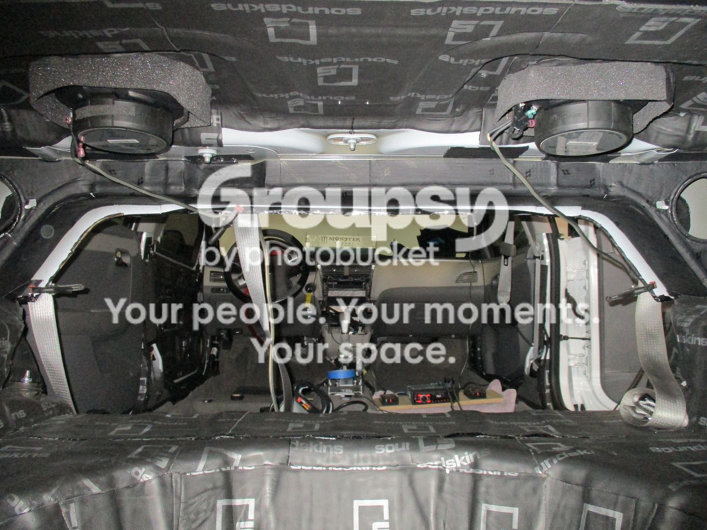

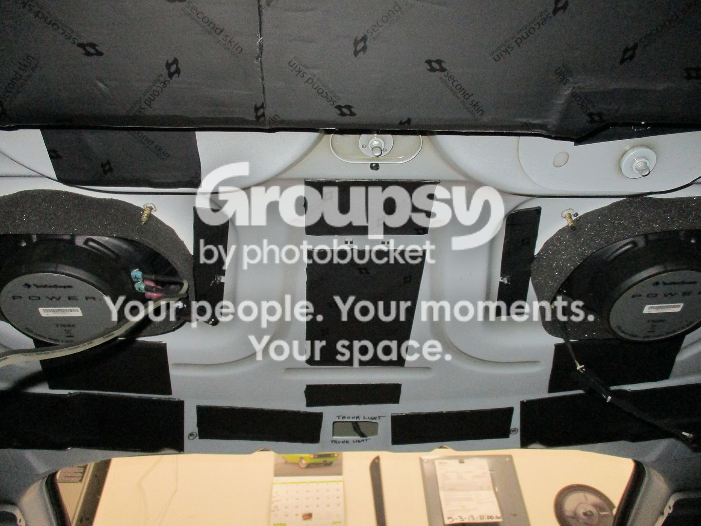

spacer.pngI believe that under the rear deck needs some attention. I hear what i think is reflection of the back wave bouncing high notes off the deck and i don't think it sounds as good as it could.
spacer.pngPlus i have just enough material left to do it. To be honest i am itching to get a couple more rolls and just keep deadening. LOL There is a stiff fa-bricked panel that covers the underside of the rear deck. I can only imagine the back wave bouncing off it and hitting the bare under side and sounding tiny or reflective.

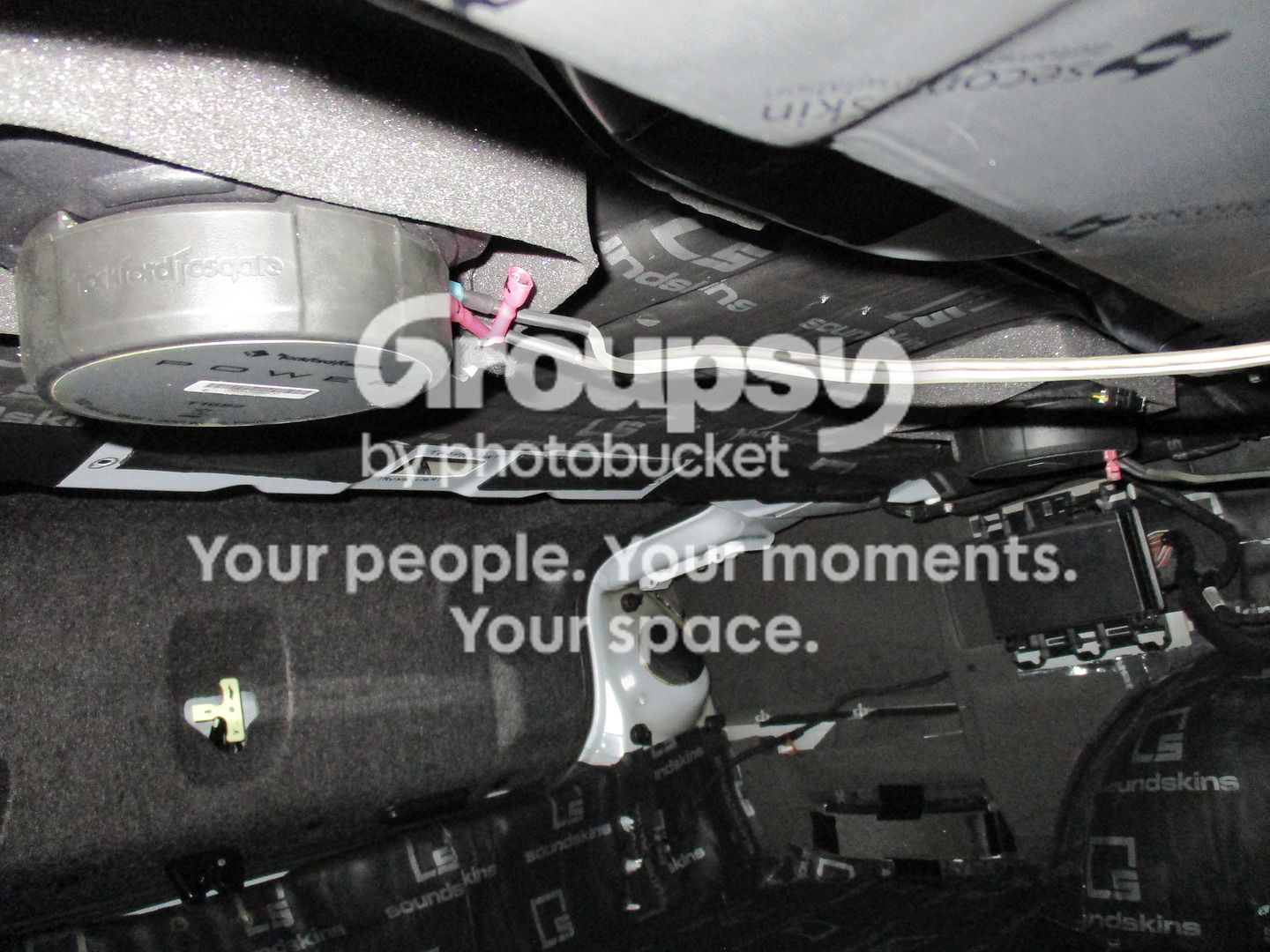

spacer.pngSo it begins...

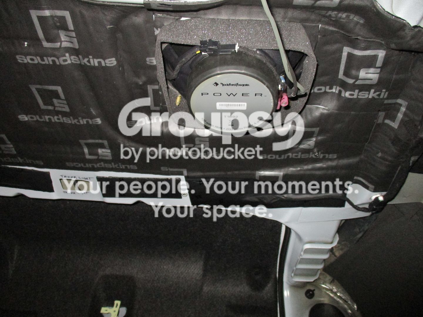

spacer.pngSo ya, upside down still suck. At least the spare tire well is comfortable. I spend a lot of time rolling out air bubble's, i want as close to 100% adhesion as possible. And that takes time's poking and rolling it out.
spacer.pngI had the results i was hoping for with deadening this area. Deep bass, rich mids & crisp clean highs. I am thinking about putting some Dynamat 1/8" CCF Dynaliner on the backside of this panel for extra added insurance that it sounds good. $45 a roll and a few hours work makes for maximum effort. Going back to work monday will slow this build right down but i will be able to afford all the goodies i need to finish next fall.

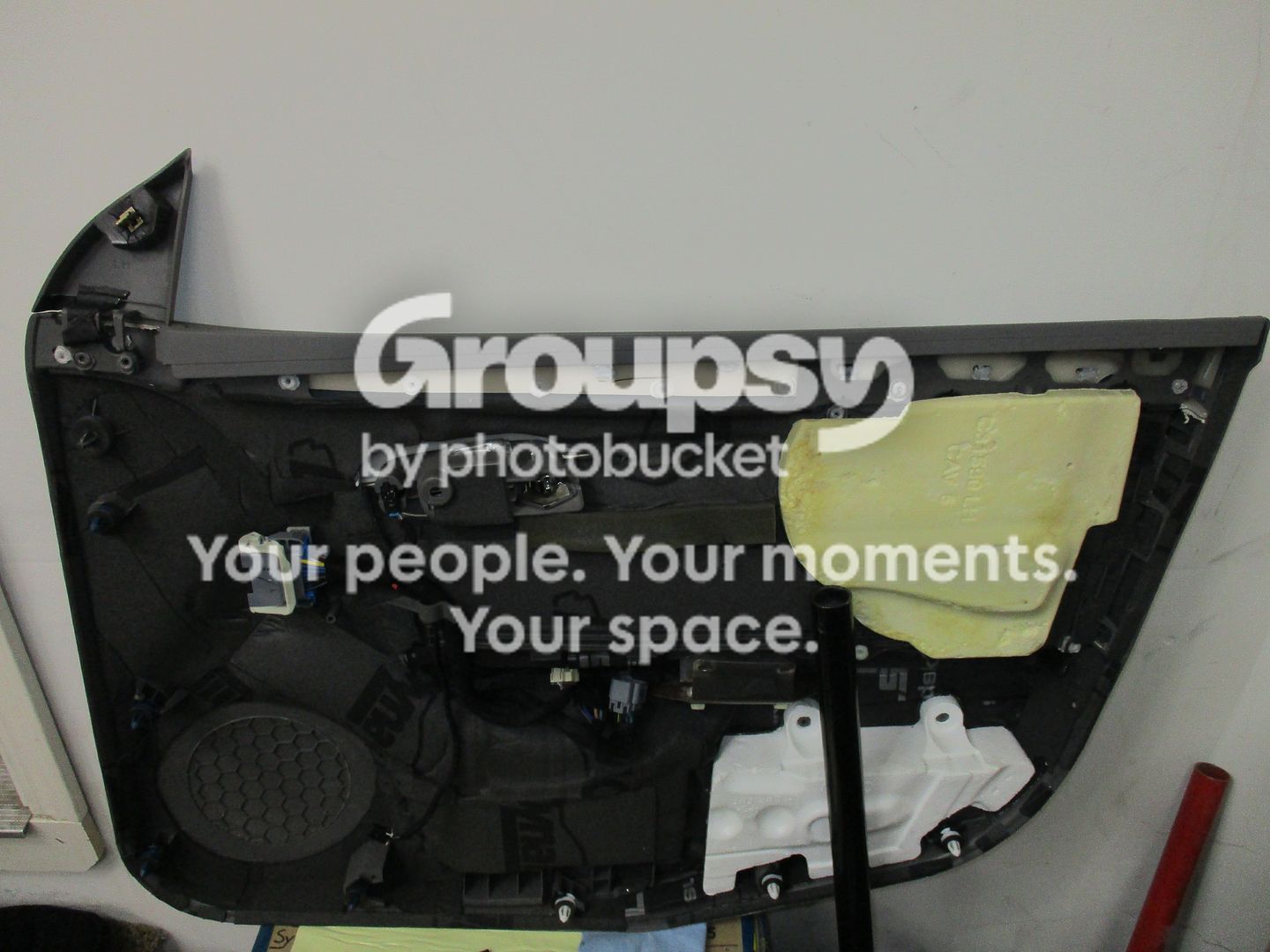

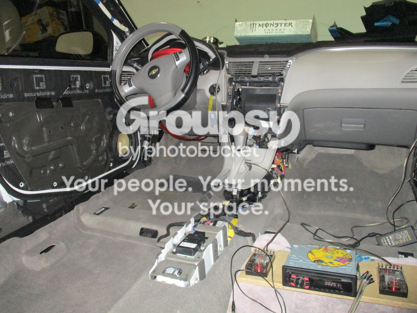

I'm working on the driver panel and going to get that back on today.

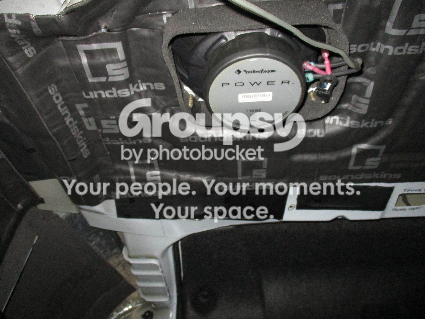

spacer.pngI spent a little more time deadening this side.

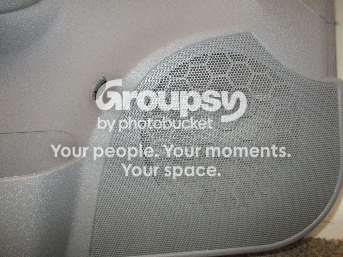

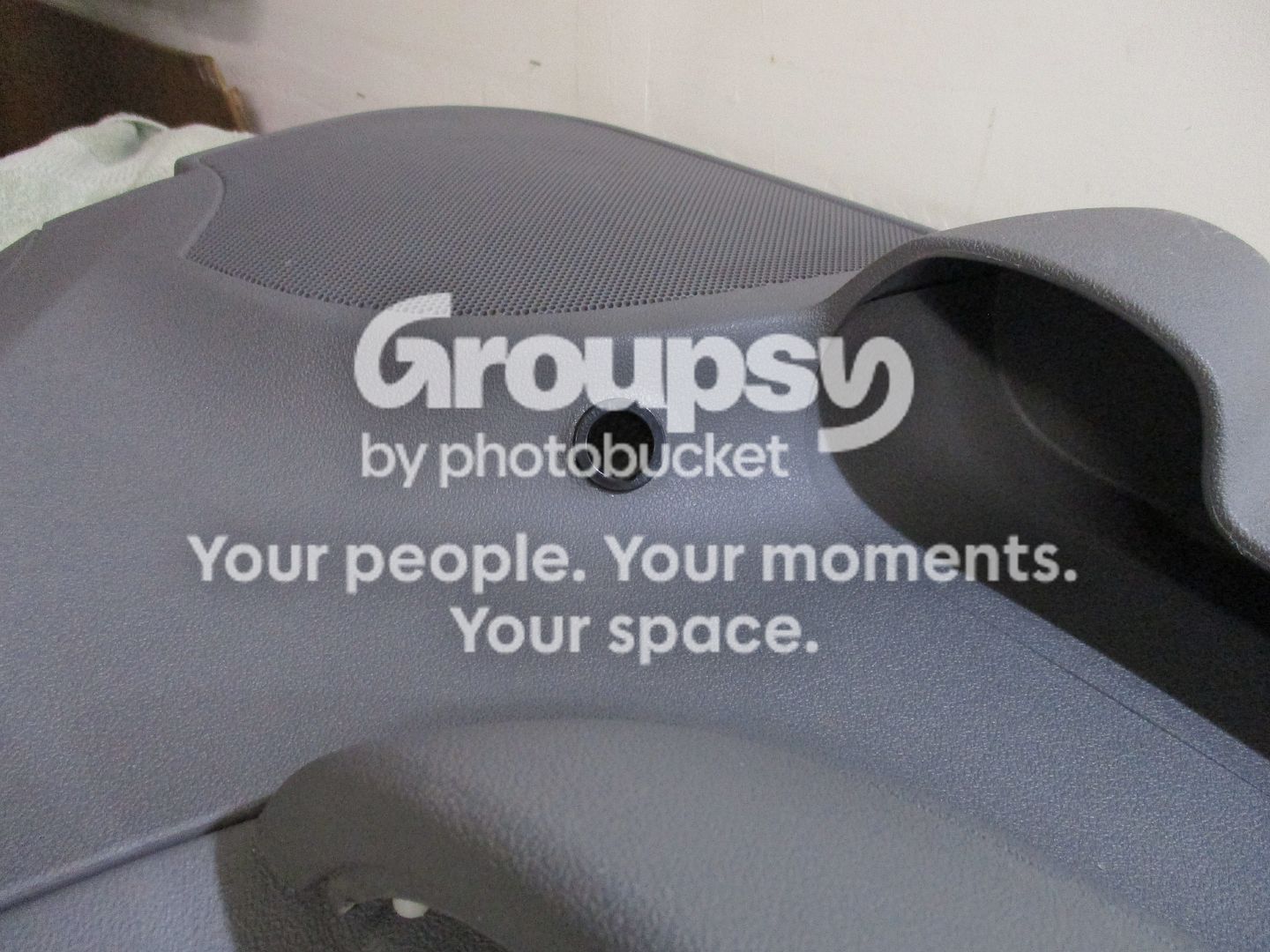

spacer.pngI drilled the grille hole on this panel too. I know what your thinking but they weren't clean holes and it looked as if it could interrupt the wave going out by suffocating the speaker.
