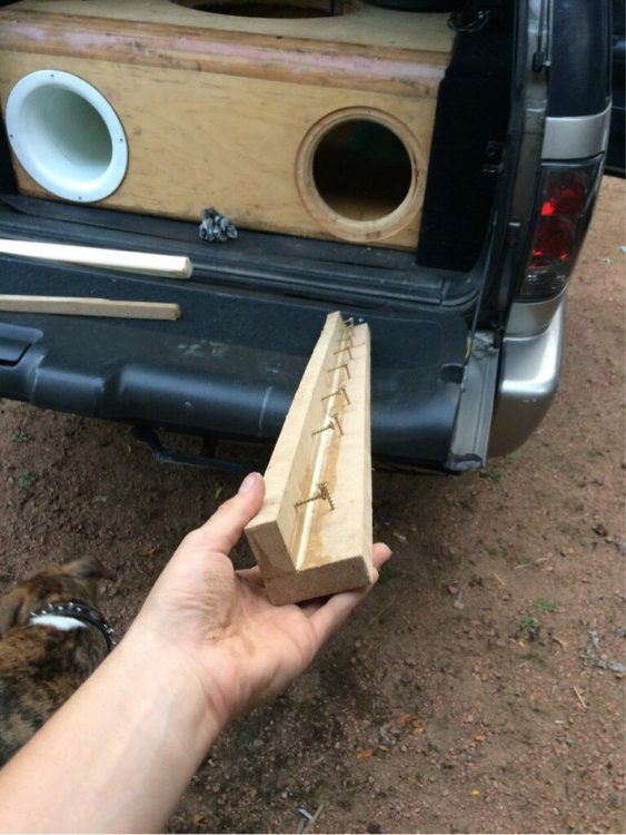

Made a right angle section of wood to run along the entire seam that let loose. Slapped a shit ton of glue on the two sides, and screwed it in. Let it dry overnight and pretty sure it solved my problem! For now at least

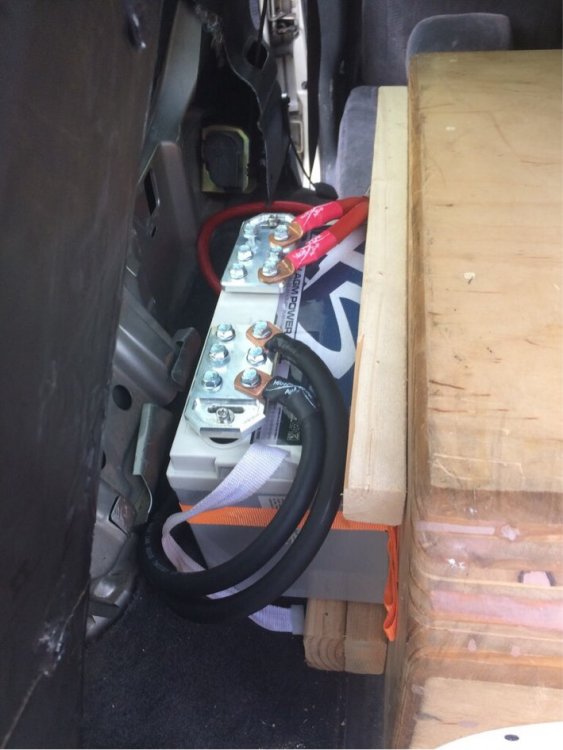

I have 4 runs total. 2 power 2 ground. You can't see the battery but I have an xs power xp3000 under the 4 channel behind the beauty panels. So from the battery in back I have 2 runs of power and 2 runs of ground going to the 3500, and a run of 4g going from battery to 4 channel. It's all shown in my build log.
As for fuses, I have 2 on the power runs under the hood, two on the runs right before the battery, and two from battery to 3500. So 6 total. All 150a fuses I believe.

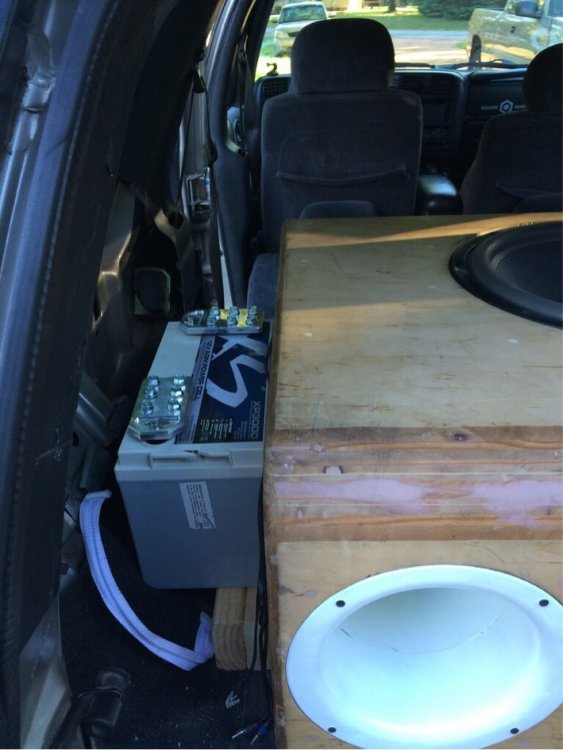

Figured I had another xp3000 sitting in my house for like a year, I might as well put it in my truck. Made a platform of 2x4's on the other side of the box and tucked it away under the amp rack. Worked out pretty well. So now there's an xp3000 hidden under each amp. :)
IMG_2795.thumb.JPG.2fcc15bd25af341d98fc0b79a3a22663.JPGIMG_2794.thumb.JPG.8bf928f1ccb4817b39f616eb00dfc8d9.JPGIMG_2793.JPG.1eba1b3110b222f0a07ecf860e42a7e9.JPG
All tucked away and hidden :)
