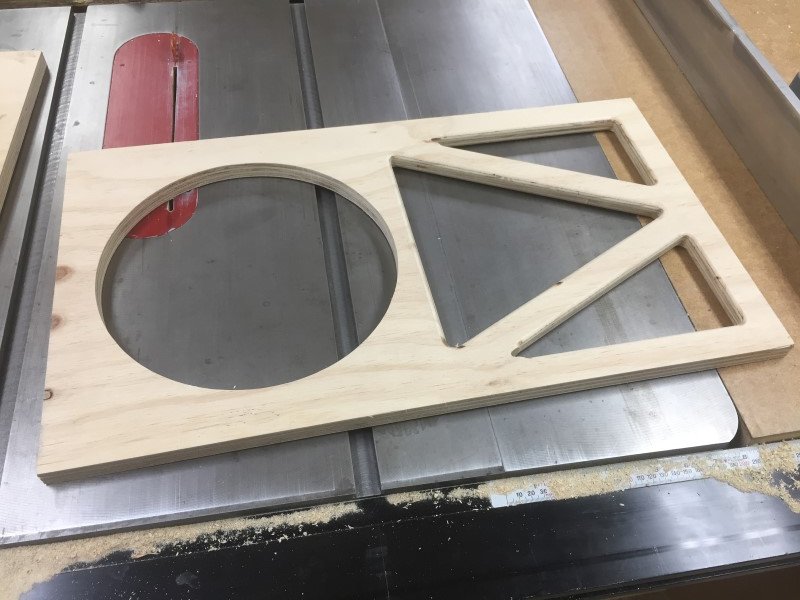

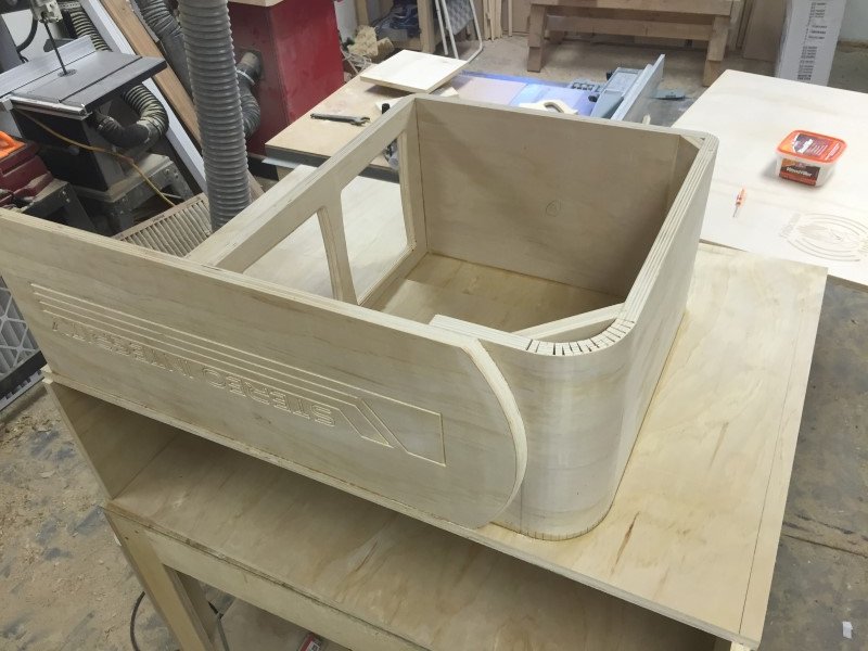

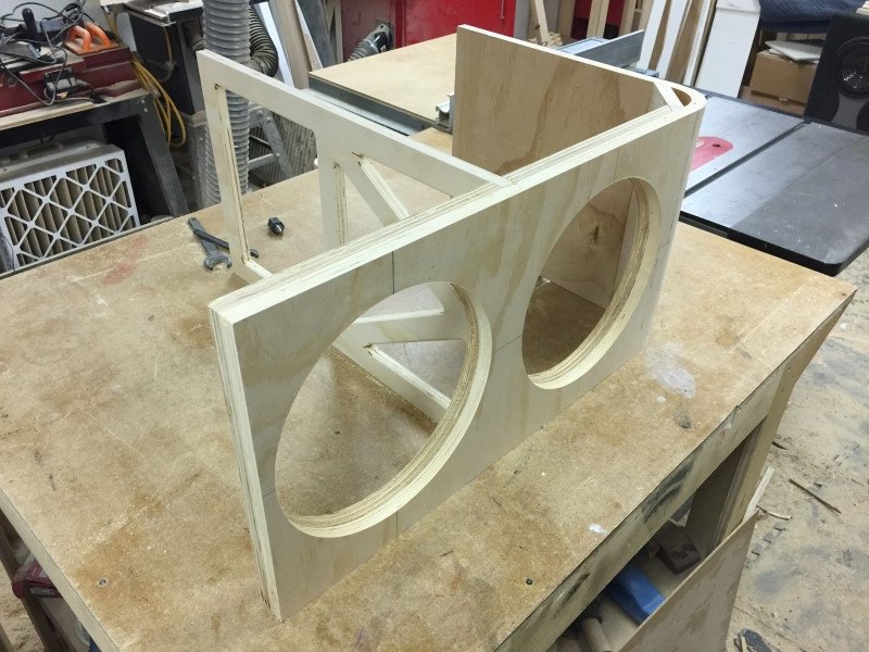

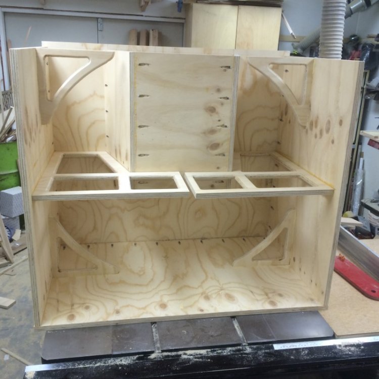

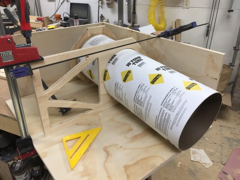

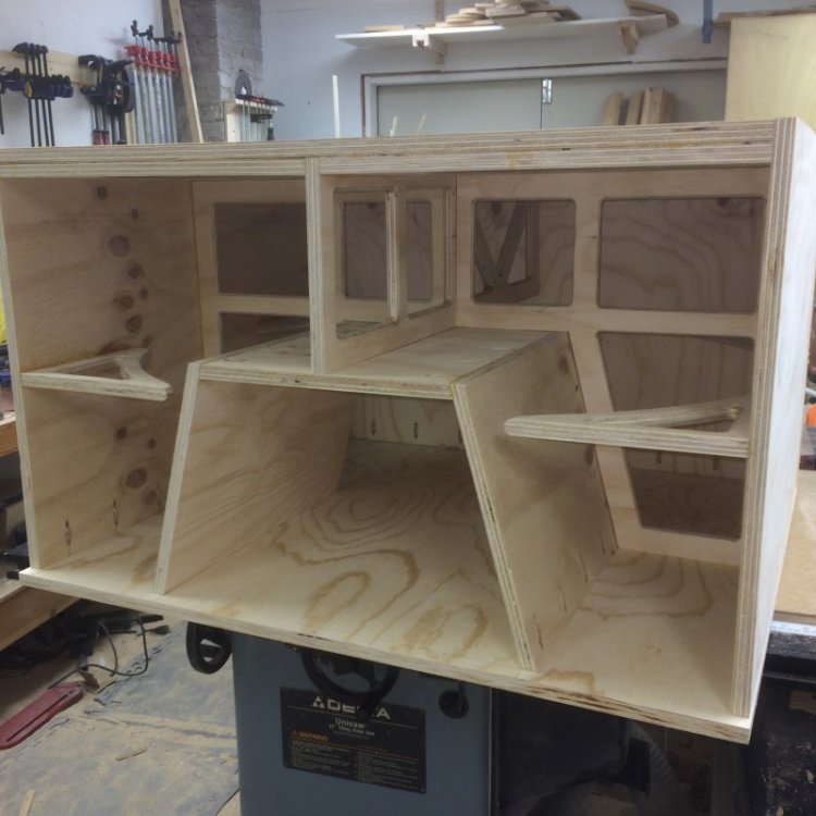

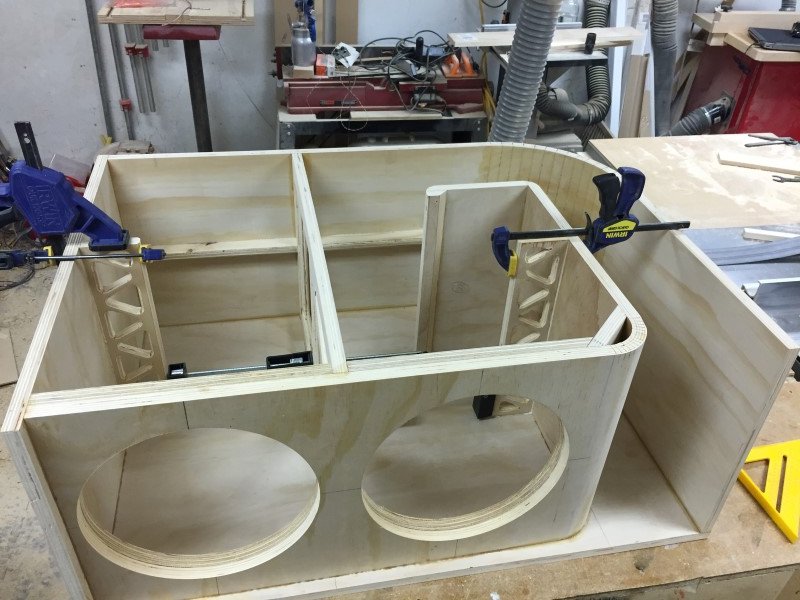

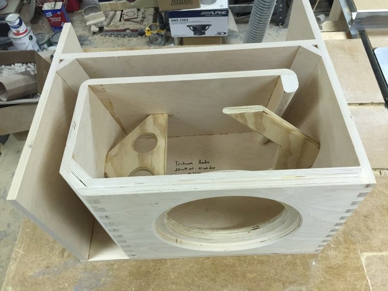

I'm digging up this old thread to update it with some more examples.  Here are some pics from builds I've done showing how I implemented bracing.

Hey Triticum,
What about the idea of using half-round dowel rods spaced along a flat surface? I thought about doing that because of the extra strength added by the round shape. Or will it always be better to brace between two perpendicular surfaces like you're showing?
15 hours ago, k58.cross said:
Hey Triticum,
I don't think the half-round dowels are going to provide much bracing at all.  Similar to how just adding a strip of doubled up panel doesn't do much for bracing either.  To get the strength you need to have a brace that sticks out from the panel quite a ways.  This is why bracing between two panel, either perpendicular or parallel to each other, works well.

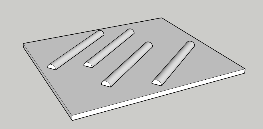

I appreciate the feedback! I made a quick (and rough draft) sketchup of the idea in case I didn't really get it across right. You sure this wouldn't do much to prevent flexing of the panel?
For what it's worth, I looked into this more and yeah, shelf brace is stronger than hemisphere brace of same width. The nerd explanation is that it has to do with the area-moment of inertia. Cutting a cylinder in half cuts the MOI in half, so I would imagine it would reduce the AMOI by more orders of magnitude. A 1"x1" half round brace of same length as 1"x1" rectangular brace will have less than half the stiffness (maybe more like a quarter...not sure the math on that one). Now when you extend the length of the dimension working against the force (sound waves), the 1"x1" rectangle increased to 1"x4" gained 76 times more stiffness. So yeah.
What's worse is you can't increase the radius of the half round without increasing it's width too. So it's just not feasible like the shelf brace.
A sound wave causes both outward and inward deflections though right? I wonder how that works for the inward case.
