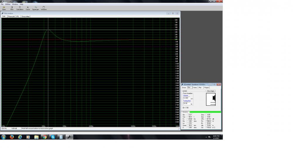

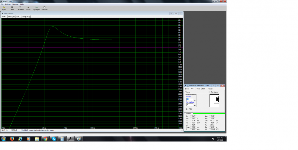

So I don't claim to know what I'm doing with this program. The last time I used a box building a program I was ~16 years old and it already had the T/S parameters of the subs we were using so I didn't have to enter them in. Today I tried my best to enter in the parameters I could find for each sub and compare the two setup's I have in mind using WinISD beta.
I modeled both the two X 15's and four SA-12's in a 12 cube box tuned to the recommended 32 and 35 hz. I'm not sure if I did everything correct or got the parameters correct. It seems to me that the T/S parameters listed on Sundown's website are for the original SA series and not the SA v3 series. I question if the same isn't true for the X series. I suppose the biggest shocker the gain plot showed me was in how the two setup's rolled off from the port frequency. The 15's having a sharper peak and dipping below the negative gain line kind of surprises me. The 4 12's gained a little more at the tunning frequency as I expected but also look less peaky having a larger gain curve and not dipping into the negatives. The port area the calculator says is acceptable also seems like it's off to me. A single 8 inch is giving a vent mach of 0.09 for the 4 12's and 0.10 for the 2 15's. Of course I played around with different sizes and numbers of ports but the only change he program showed me was in the vent mach and port length. I don't quite understand enough yet to know if the number's the program gives me are correct. Basically the only thing I know about vent mach is that you don't want the number too high to avoid unwanted port noise.
This was for comparison purposes only and I'm sure the end design will be slightly different. I just hoped to get something mocked up to compare the two setups and hopefully get some advice or have someone show me what if anything I'm doing wrong with the T/S parameters and this program.
It's pretty clear to me that I don't understand much about port area. I'll be searching and reading what I can find about it but I guess what's confusing me is the need for more port area than require to keep the vent mach or airflow speed low enough. I don't claim to know what low enough is other than going off what the box design programs I've used say are good enough which has been a mach number of 0.16 or lower from what I remember and this program is showing.
The only thing I can think of that would give me enough port area (correct me if I'm wrong) would be to use the back wall with a 50" long 3" wide 7.56" deep slot port. 150 square inches of port area taking up 0.65625 internal space before the wood needed for the walls. This would still allow for quite a bit more airspace than recommended. The subs would all be firing down and the port up. Does anyone see anything wrong with this type of configuration? The only others that I can come up with that give me enough cubic inches of port area would be too long and would have clearance issues with the subwoofers plus take up much more of the box volume itself so unless I'm just not picturing something in my head that would work...well the 4 12's would be out simply because the ports would need to extend into them.
