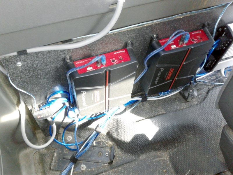

Here is the messy version of my setup, I have it up and running now, but with all the speakers playing full ranges, which is not exactly ideal, but my head unit's xover settings are idiotic. Most channel only ger a hpf up to 250, not useful imho.
2 cheapo pioneer amps for mids and tweets, JL for mid lows, and sundown not yet installed for subwoofer.
