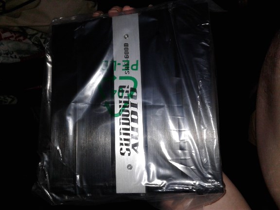

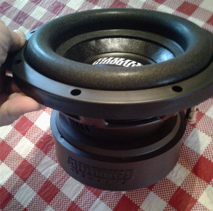

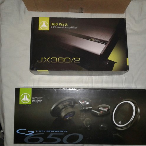

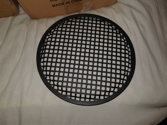

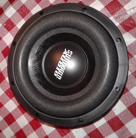

So the man fixing my brake lines and changing my tires is taking forever and claims to have run into some difficulty involving the brake lines so I still don't have my damn truck home, but I fished out all the pics I DID take from this stage of the install so there is at least a little eye candy.
Sub Amp:
Grill for Subwoofer Box:
Amp for midbass and current midbass/tweeter (both to eventually be replaced most likely, I guess we will see how it all sounds together):
Side of subwoofer, which is the most monsterous 8 I have ever seen in person:
Cone:
