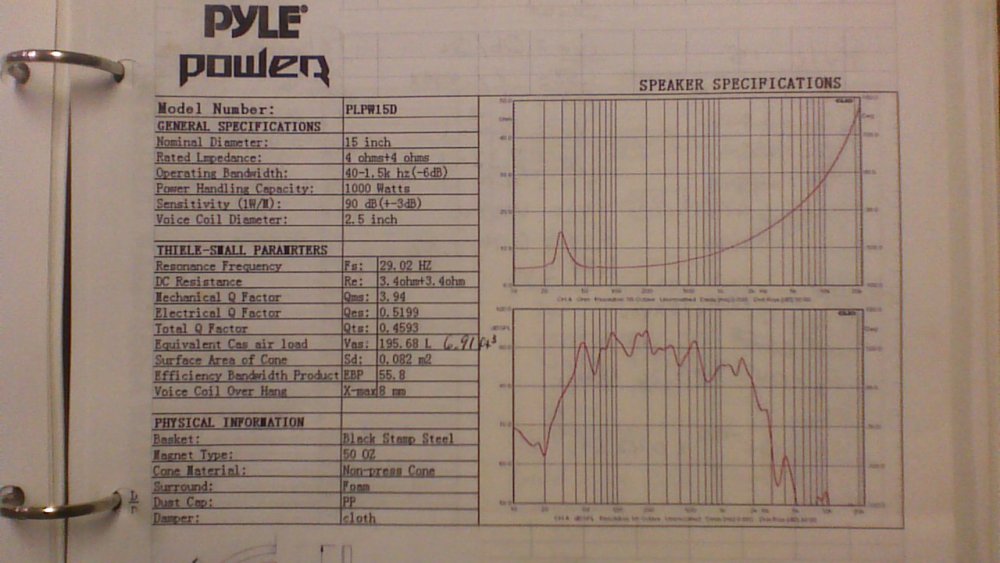

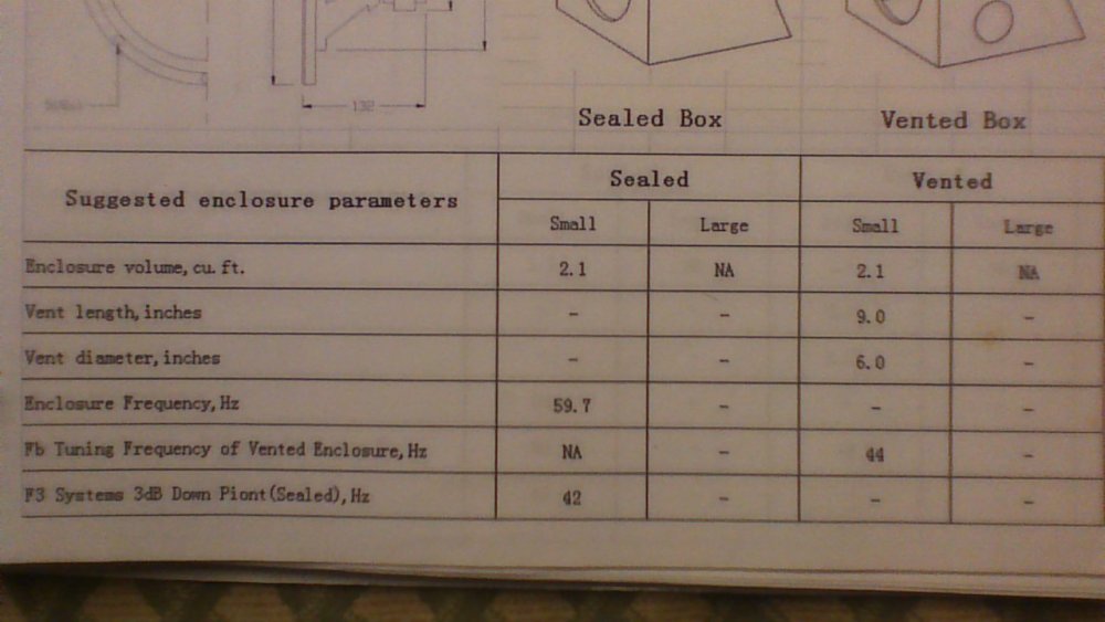

joshuaV Posted April 16, 2017 Report Posted April 16, 2017 Hello, I have 2 15" Pyle PLPW15D in a box that has 12 Cubic FT after displacement and bracing. I currently have 2 sets of AERO PORTS that I have made to try and found that the bigger sized ones are louder. Aero Port set 1: (2) 8" diameter and 20" long Aero Port Set 2: (2) 4" Diameter and 12" long Can someone please help me to try to find the best port diameter/length to use these to the best to be tuned to about 30 Hz? If it helps at all, i have attached the specs on this driver to the thread. PLPW15D_Spec_Sheet.pdf

ShadeTreeMechanic Posted April 17, 2017 Report Posted April 17, 2017 What kind of power are you going to run? That box is huge. The recommended volume is 2 cubic feet each. I ran 4 of them in my truck sealed a few years ago. Now they are part of my DJ setup. 91 C350 Centurion conversion ( Four Door One Ton Bronco) 250A Alternator (Second Alternator Coming Soon) G65 AGM Up Front / Two G31 AGM in Back Pioneer 80PRS CT Sounds AT125.2 / CT Sounds 6.5 Strato Pro component Front Stage CT Sounds AT125.2 / Lanzar Pro 8" coax w/compression horn tweeter Rear Fill FSD 5000D 1/2 ohm (SoundQubed 7k Coming Soon) Two HDS315 Four Qubes Each 34hz (Two HDC3.118 and New Box Coming Soon)
ShadeTreeMechanic Posted April 17, 2017 Report Posted April 17, 2017 I couldn't get your link to work. This is what I have on it. 91 C350 Centurion conversion ( Four Door One Ton Bronco) 250A Alternator (Second Alternator Coming Soon) G65 AGM Up Front / Two G31 AGM in Back Pioneer 80PRS CT Sounds AT125.2 / CT Sounds 6.5 Strato Pro component Front Stage CT Sounds AT125.2 / Lanzar Pro 8" coax w/compression horn tweeter Rear Fill FSD 5000D 1/2 ohm (SoundQubed 7k Coming Soon) Two HDS315 Four Qubes Each 34hz (Two HDC3.118 and New Box Coming Soon)
Joe X Posted April 17, 2017 Report Posted April 17, 2017 Based on the parameters posted each driver will work on a single 6" port (as they suggest), two drivers, two ports, very small xmax.

ShadeTreeMechanic Posted April 18, 2017 Report Posted April 18, 2017 The sub is more of a woofer than a subwoofer. With the single cloth spider, I wouldn't expect them to have a long life with 12 cubic feet. 91 C350 Centurion conversion ( Four Door One Ton Bronco) 250A Alternator (Second Alternator Coming Soon) G65 AGM Up Front / Two G31 AGM in Back Pioneer 80PRS CT Sounds AT125.2 / CT Sounds 6.5 Strato Pro component Front Stage CT Sounds AT125.2 / Lanzar Pro 8" coax w/compression horn tweeter Rear Fill FSD 5000D 1/2 ohm (SoundQubed 7k Coming Soon) Two HDS315 Four Qubes Each 34hz (Two HDC3.118 and New Box Coming Soon)
