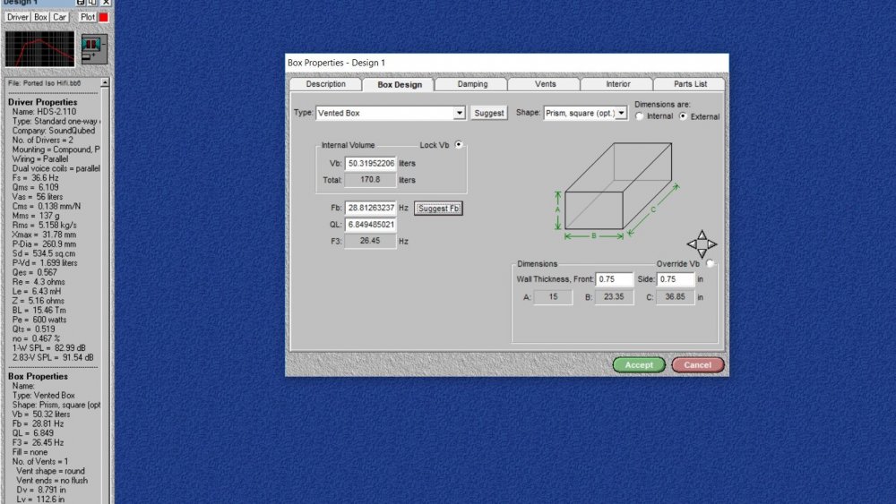

Charles Phillips Posted July 15, 2017 Author Report Posted July 15, 2017 After designing a ported isobaric box that had a very large port (9 inch diameter and 112 inch length) we decided that since the most he's had in the car before was some 100 watt amp and an Rockford Fosgate sub, one 10" would probably be enough on 600 watts. However, to make sure, I have a box sitting around for 2 12's that is about right for them. I'll adapt that box and see if he's willing to give up space for bass. In the end, if we decide on one sub in the car, the other one will go in his boat or as a home theater sub in some sort of bandpass or horn. For all those people with two SoundQubed HDS-2.110's wondering what to do with them, my results from BassBox Pro 6 are quite telling. They indicate strongly that a hi-fi design gives strong SPL and a very acceptable frequency range to play with. You only give up having a huge peak at a few frequencies which is expressed in the loudness optimized setting. I've included the specs here in case I've made any huge errors, which is very possible given how big the port is. - 2009 Toyota Matrix Base - - iPad 64GB - - miniDSP 2x4 HD - - PPI Art a200.2 - - SoundQubed SQ-2200.2 x 2 -
Triticum Agricolam Posted July 15, 2017 Report Posted July 15, 2017 So just to make sure I'm on the same page as you, you are proposing a 1.75~ cu ft box, tuned to 28.8 Hz for two HDS210 subs on 1300 watts. Is that correct? Assuming that info in correct, you neither need nor want a 60 sq in port for that setup. Its too much, and I don't get to say that very much. A 112" long port is going to cause you problems. Once you get much over 44" or so you can start to run into pipe resonance issues. Also, you don't need that much port area to keep port velocities under control. A 30 sq in port will get the job done, and even it is going to be pretty long. These really small, low tuned boxes are where a t-line starts to make sense. "Nothing prevents people from knowing the truth more than the belief they already know it.""Making bass is easy, making music is the hard part."Builds:
