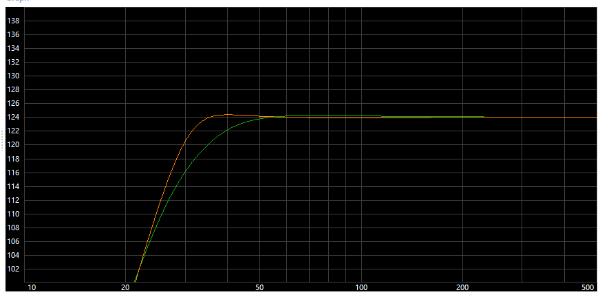

1. Your math is correct, but the single 18" PR has quite a bit more excursion compared to the two 15" PRs.  You can probably get away with the single 18" PR if you set your subsonic filter to no lower than 26 Hz.
2. Here is a graph of the approximated difference in output between the PR box (orange line, 3.5 cu ft net tuned to 32 hz), vs your three 4" aero port box (green line, 2.8 cu ft net tuned to 32 Hz)
