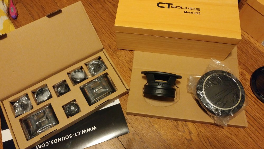

bmwking Posted September 20, 2017 Report Posted September 20, 2017 Hey all, just wanted to put up some pics of the install i did in my 03 cooper S. Space was at quite a premium in this car, but I like to think I did my best Stock 03 Cooper S (mods coming after all the reliability bugs are worked out) HU: Alpine CDE-143BT Front stage: CT Sounds Meso 5.25" Components Rear stage: Soundqubed triaxial 6x9s Sub: CT Sounds Meso 6.5" Sub amp: CT Sounds T300.1 Enclosure: Custom by me, still needs carpet Wires: SHCA 12g speaker wire, 4ga power and ground Stock alt, Factory replacement AGM in the boot Now, onto the pics (sadly no pictures of the HU, 6x9s or component set going in, but they all fit in stock locations): Here's the beefiest 5.25" component set I've ever owned. They sound amazing, if not a little bright, on headunit power:

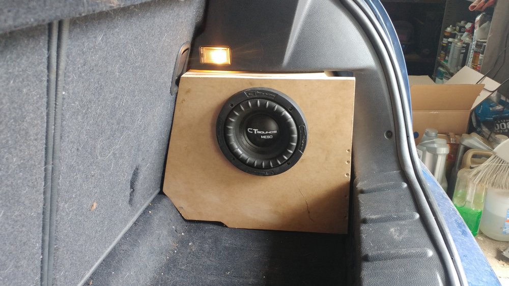

bmwking Posted September 20, 2017 Author Report Posted September 20, 2017 This is showing the complicated nature of the box. I asked for, and received, lots of quality advice. Ultimately, a slightly smaller than recommended, sealed enclosure ended up being what fit my needs. Unbelievably tho, it adds quite a bit of bottom end for what it is! Everything is 99% done, install-wise, just have to carpet the box when I get a chance. The painters tape is covering the bolt terminals for the speaker connections. Also, this was my first successful kerf, albeit a small one, still... success!

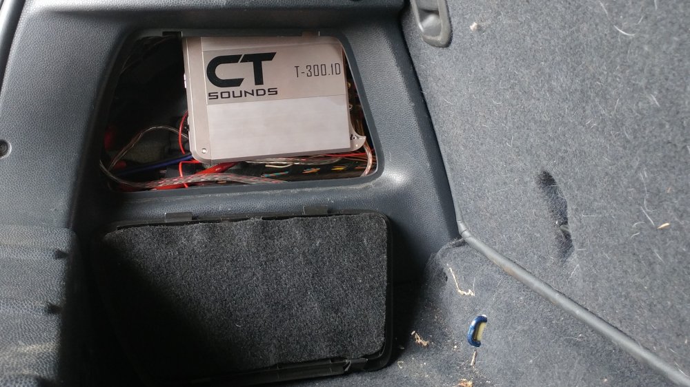

bmwking Posted September 20, 2017 Author Report Posted September 20, 2017 this is what the amp look like when in its hiding spot. not a whole lot of storage in this car. The compartment that the amp is in on the drivers side had a matching twin on the passenger side that i had to cut the trim panel out from to fit the box in. battery is right under the carpet in the boot area here.
bmwking Posted September 20, 2017 Author Report Posted September 20, 2017 And finally, here's what the sub and box look like shoved into it's tiny cubby. It's pressure fit in where I cut the panel out and helped by some body sheet metal behind it. Still can't get over how good this little guy sounds! Thanks for looking!
