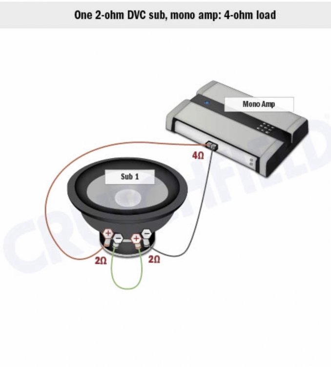

what is the proper wiring diagram for the sub?  The amp is not a 1 ohm stable,so that means I'm only able to wired the sub from a 2ohm to 4ohm to have a 4ohm load into the amp? Or is there a way to keep the sub at 2ohm?

Your only option is to wire to 4 ohms. That sub and amp are not a good match. You should have gotten a dual 4 ohm sub.
43 minutes ago, StuntBoy said:
Pretty much like this correct?
Yup
