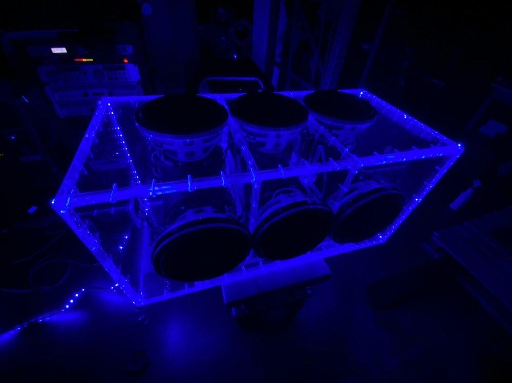

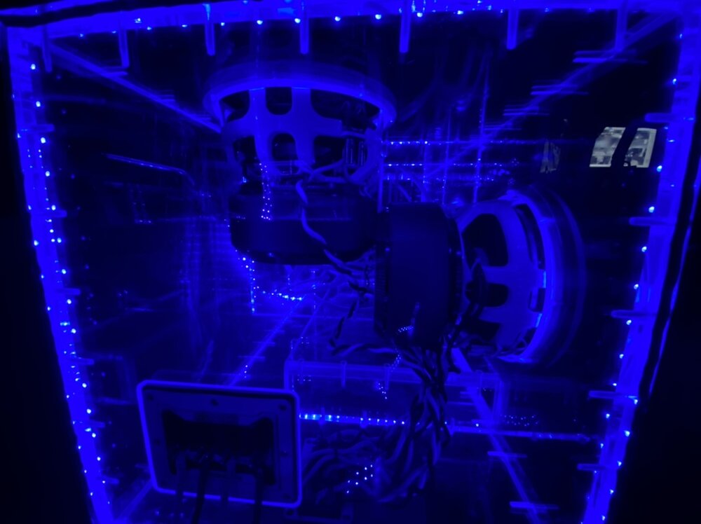

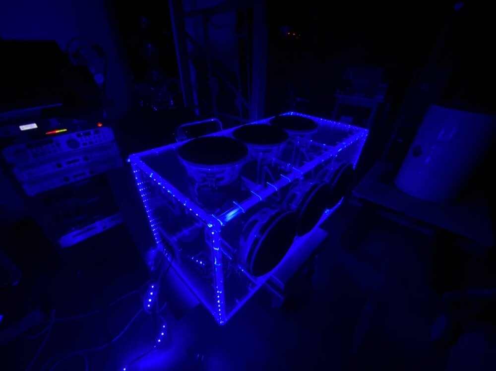

Damn. They should consider it in white as an option lol
The LEDs on sold me. That looks good.
I'm a bit jelly lol

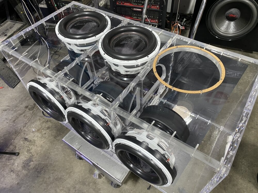

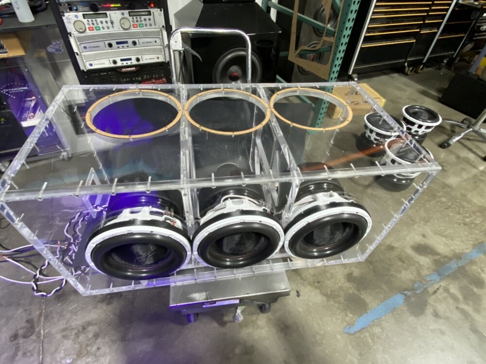

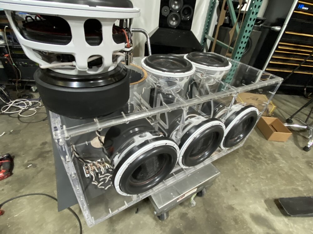

With the sub clearance, you worried about any box flex and them hitting? I know nothing about Plexi, so... asking for a friend? lol

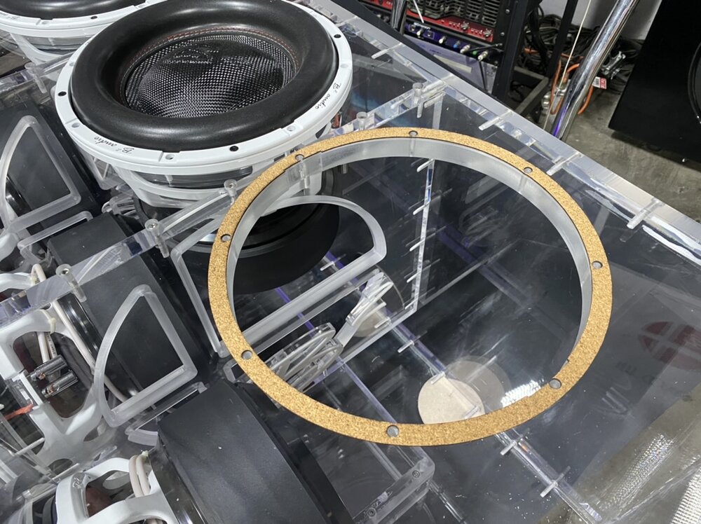

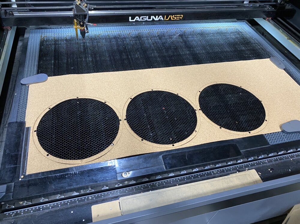

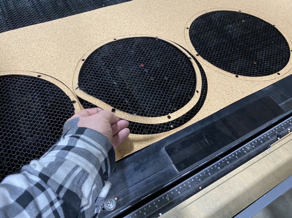

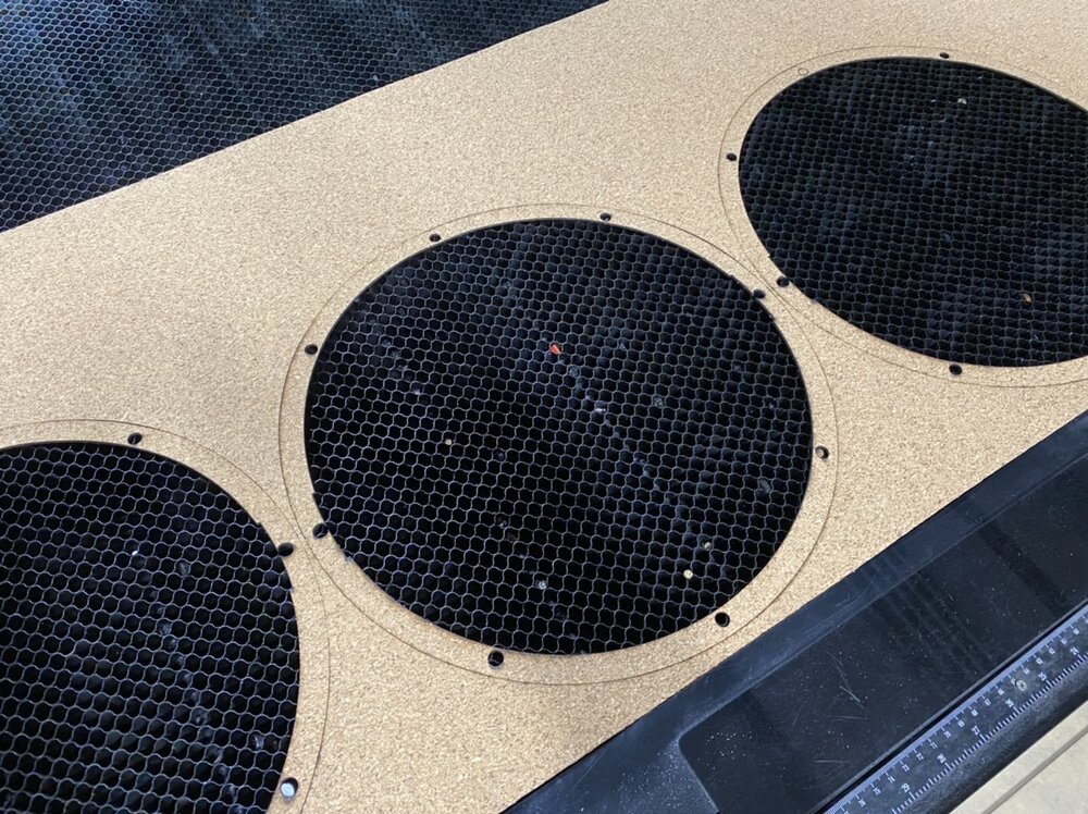

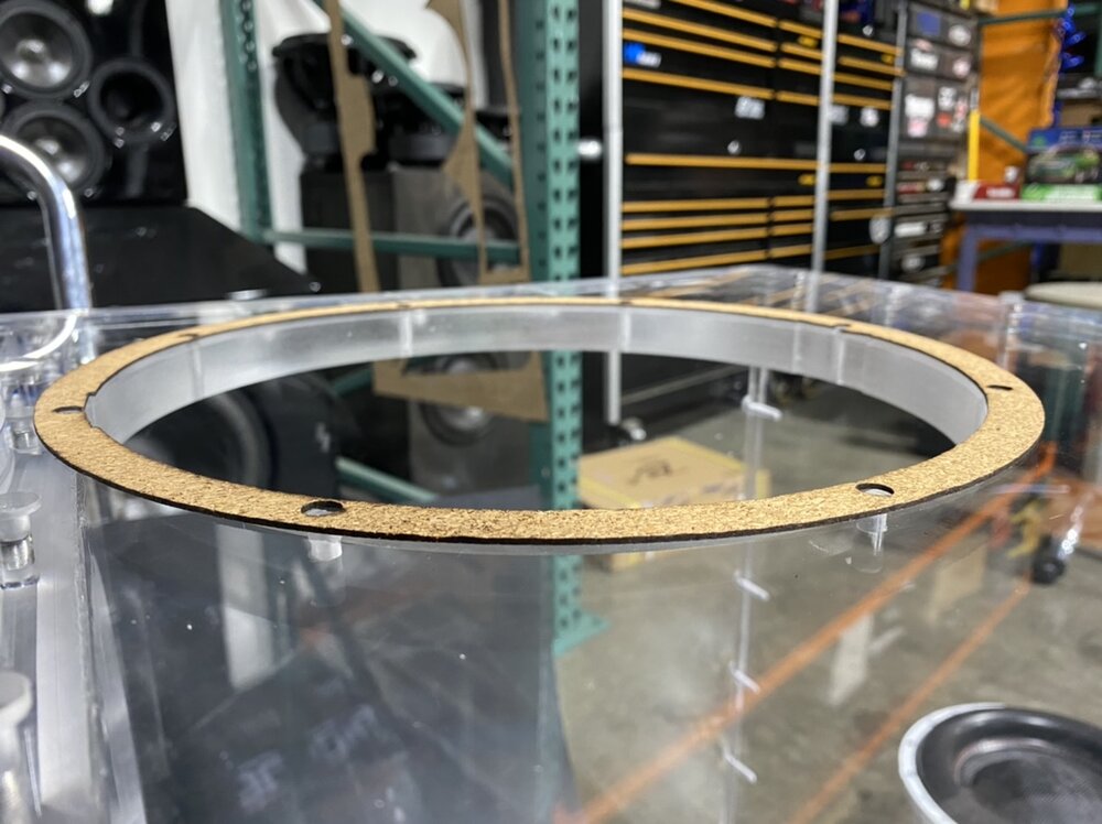

some laser cut gaskets made today

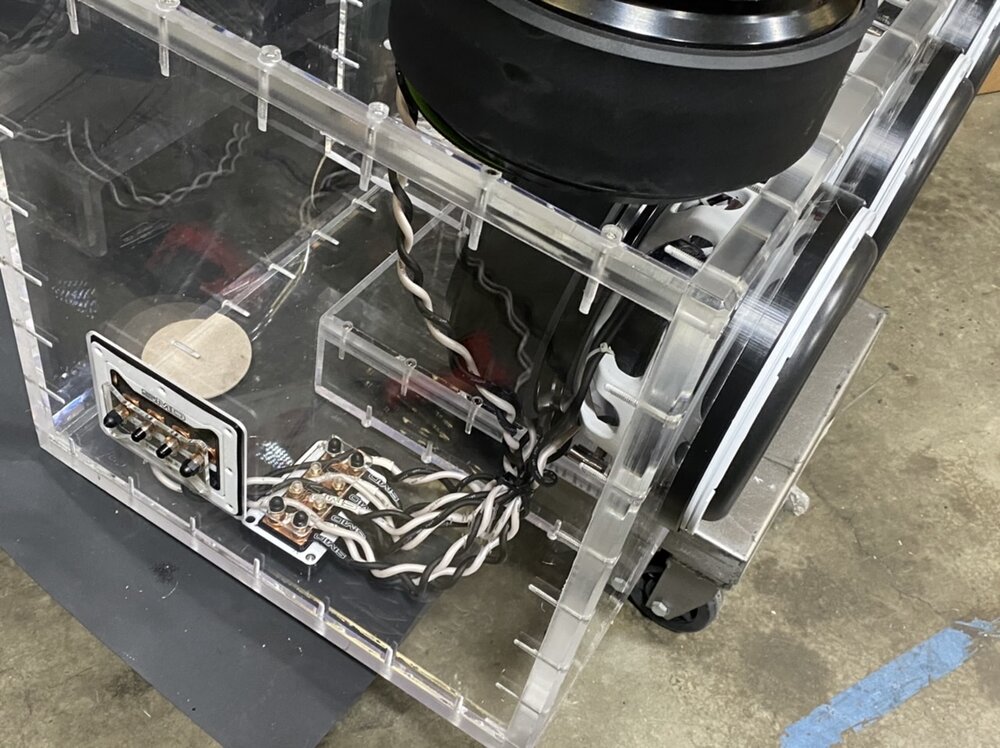

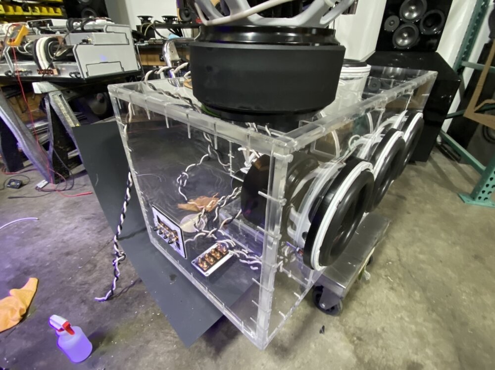

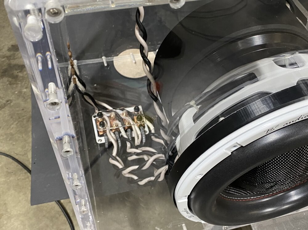

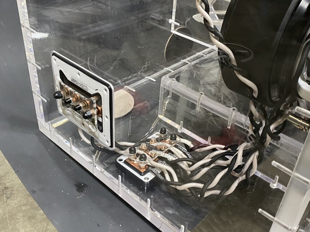

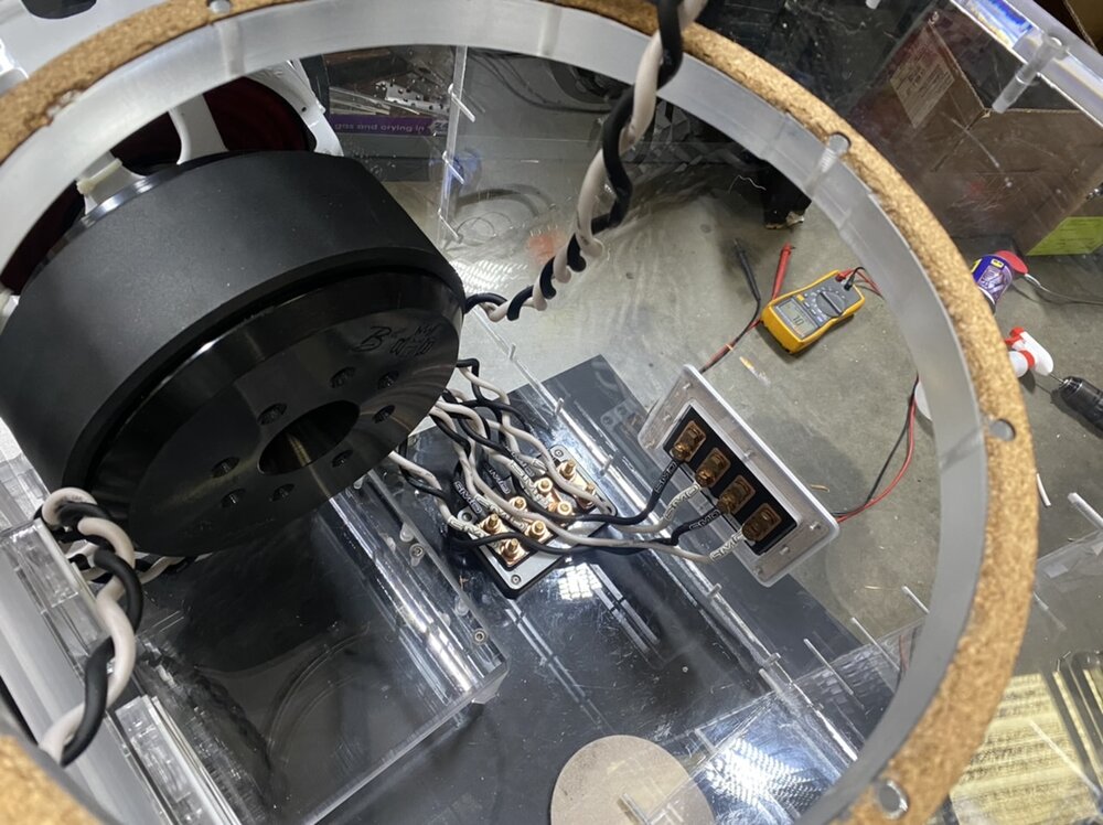

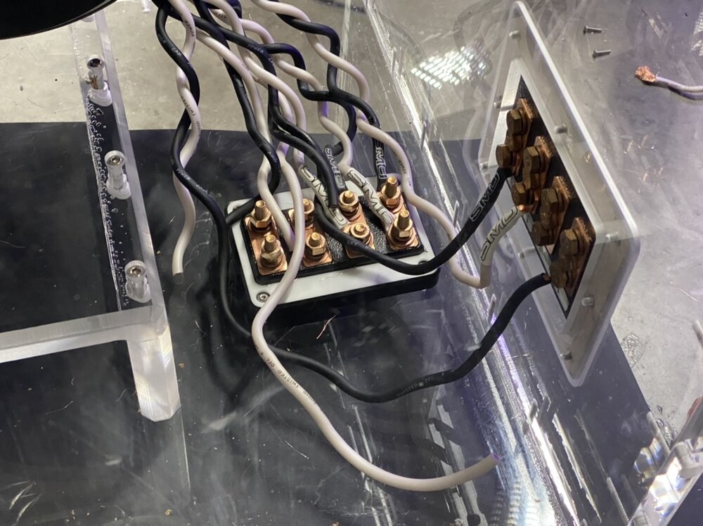

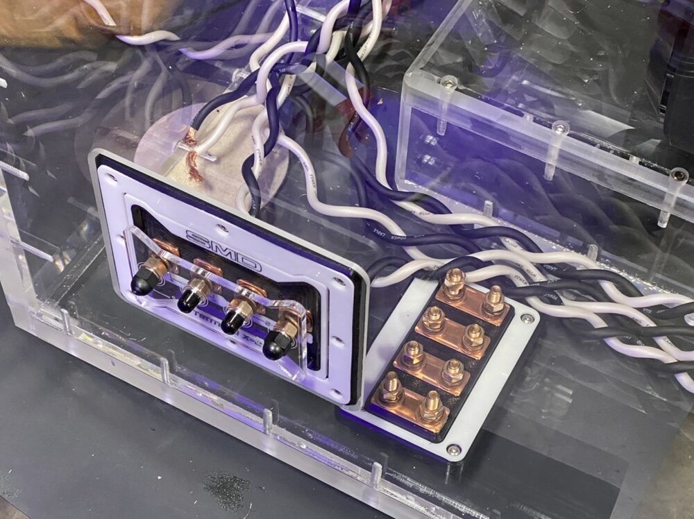

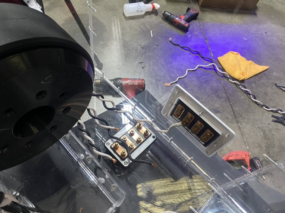

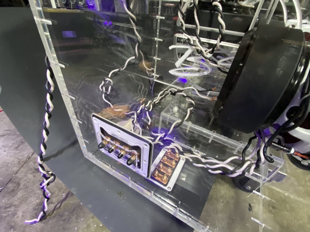

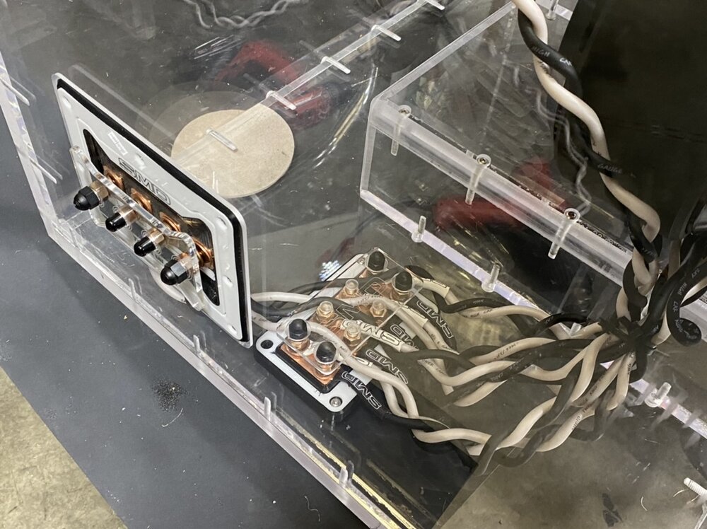

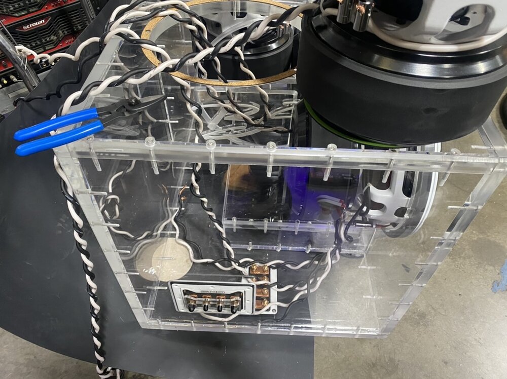

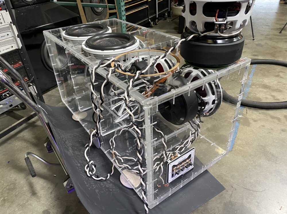

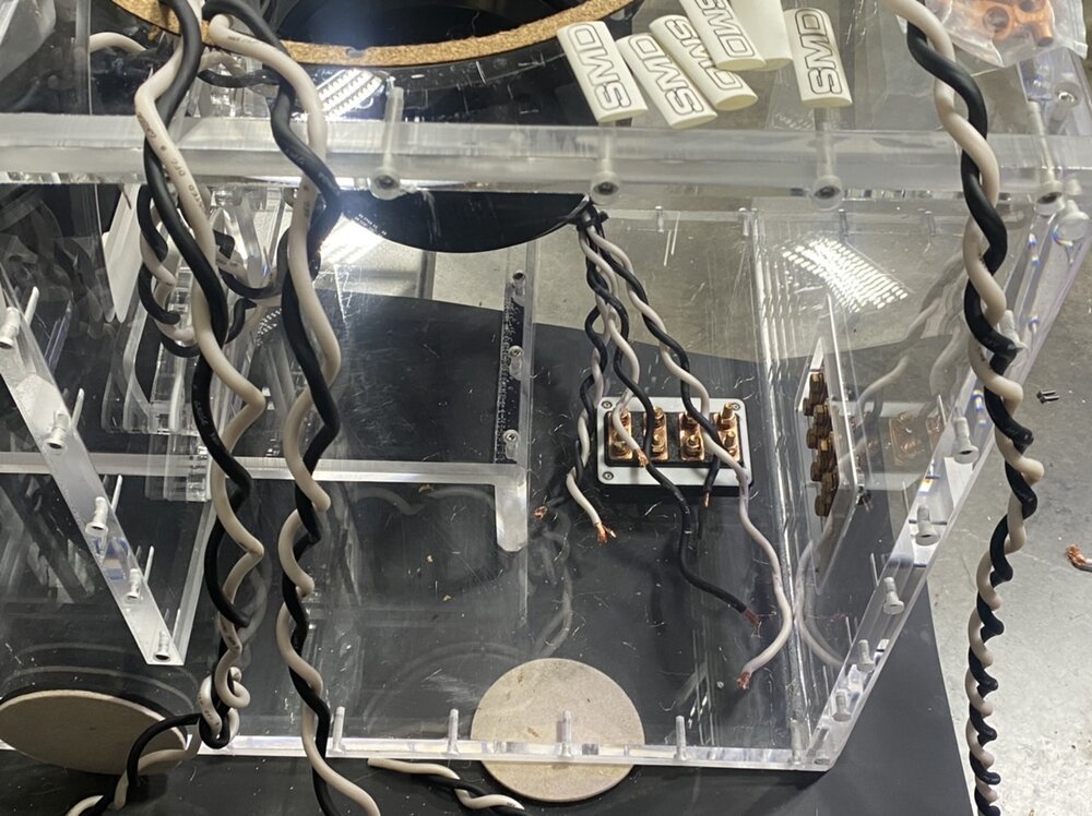

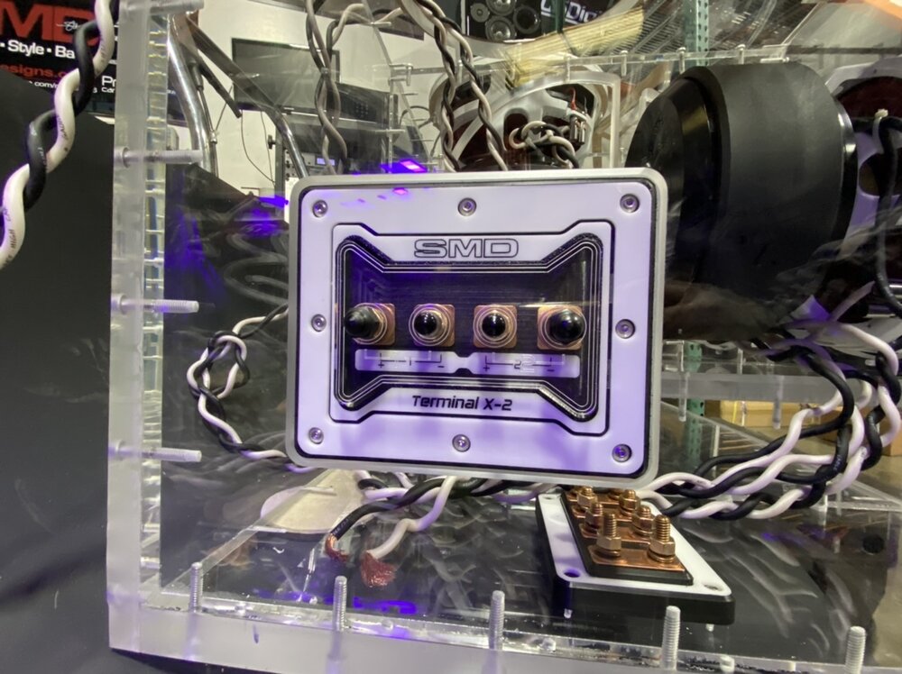

Time to start wiring up the terminals.   For this i am using an SMD DCL 4.2 and a SMD TX-2.  The DCL 4.2 will help me wire up the series/parallel stuff clean.  It might look straight forward (and it is kinda) but it is a little more complicated than it looks. These subs are dual 1's.  They are each wired in parallel.  Then they are wired in series (each group of 3) to bring that set down to 1.5 ohms. The amps they are being hooked to are rated at 2ohm bridged so this is a little lower than i am supposed to but that should be OK. More power!
Both the DCL 4.2 and the TX2 are mounted with TAPPED 8x32 stainless allen-head bolts.
  • Like (+1 Rep) 3
Positive on channel one comes in, goes into one sub and out the other, then into another sub, then the last negative in the chain comes back out to the terminal cup.
