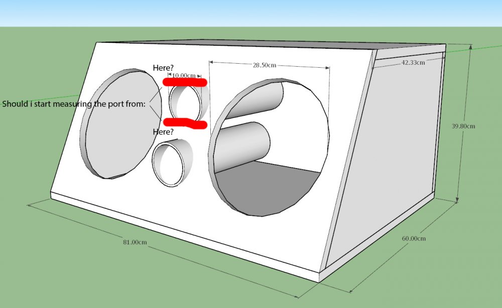

AndriusLT Posted January 13, 2018 Report Posted January 13, 2018 Hello am planing to make angled round ported sub box and I want to ask how should i measure the ports, starting from where?
bmwking Posted January 13, 2018 Report Posted January 13, 2018 the full length of the port is what matters. if you dont plan on making them angled and flush with the face of the box then its simple algebra. if you are going to flush them its still simple math, just figuring the volume of a cylinder and triangle (roughly).
AndriusLT Posted January 13, 2018 Author Report Posted January 13, 2018 So its the same as I would have without angled front? Because I need to make the front angled so it could fit nicely in my E39 trunk.

bmwking Posted January 13, 2018 Report Posted January 13, 2018 2 hours ago, AndriusLT said: So its the same as I would have without angled front? Because I need to make the front angled so it could fit nicely in my E39 trunk. basically. it doesnt matter if you measure from the top of the port or the bottom if you arent beveling the ports. if you are going to flush the ports with the face of the box (therefore angling the port mouths) it will change the overall volume of the ports, although not by much. what are the dimensions of the ports? what angle do you intend to cut them at? personally i'd leave the little bit of port sticking out though the ski opening if you can, it'll be simpler

AndriusLT Posted January 13, 2018 Author Report Posted January 13, 2018 Yes I am thinking am gonna leave the ports like that not cut. Subs - 2 x JBL GT5-12; Amp - Pioneer GM-D9601; Sub displacement - should be around 0.10ft per sub. I calculated everything and exported everything into Sketchup Correct me if am wrong somewhere
bmwking Posted January 13, 2018 Report Posted January 13, 2018 based on some quick torres results, that gives you a tuning of about 30hz (not a big difference, plus i rounded the dimensions to make it simpler). thats pretty low tuning, but to each their own! after plugging in the info of you box and amp into Triticums port calculator, it looks like youll run into port compression/noise, you may want to have a more experienced box builder chime in. @Triticum Agricolam might hopefully see this. hes a damn genius.
AndriusLT Posted January 14, 2018 Author Report Posted January 14, 2018 You mean air velocity is too high?
bmwking Posted January 14, 2018 Report Posted January 14, 2018 5 minutes ago, AndriusLT said: You mean air velocity is too high? yeah, the velocity of the air coming out of the ports will be too high, assuming youre wiring to 1 ohm and sending 1200wrms to the subs
