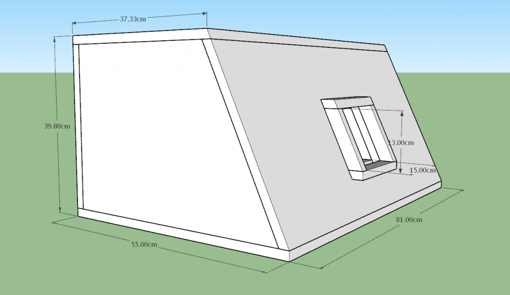

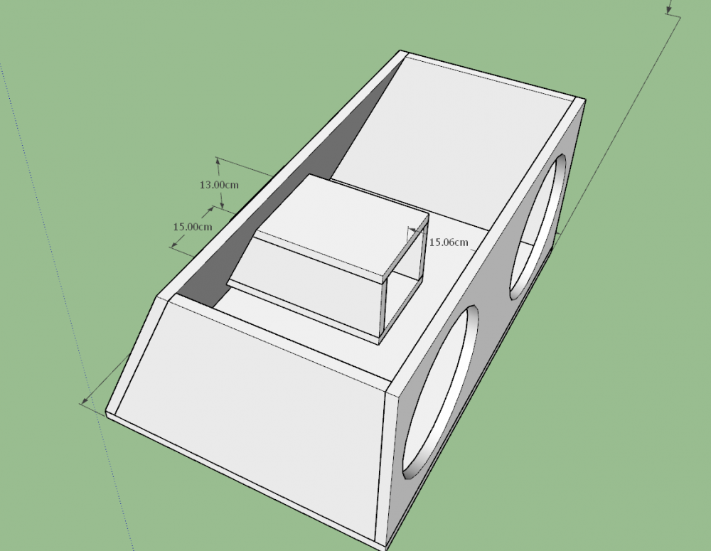

AndriusLT Posted January 22, 2018 Author Report Posted January 22, 2018 Finally made something am happy with. What do you guys think? Also I want to ask is it okay if put subs in the back and port to front, the distance from port to drivers will not be enough so to correct that i put the subs a little bit to the sides so they could sit nicely beside the port is that okay?
ckeeler11 Posted January 22, 2018 Report Posted January 22, 2018 How long is the port? How much power you going to be running, port area is pretty low?
AndriusLT Posted January 22, 2018 Author Report Posted January 22, 2018 I calculated everything and tuned it to 35 Hz will be running 800w on the system, net volume: 103 liters, port length: 34 cm.
ckeeler11 Posted January 22, 2018 Report Posted January 22, 2018 1 hour ago, AndriusLT said: I calculated everything and tuned it to 35 Hz will be running 800w on the system, net volume: 103 liters, port length: 34 cm. Thats what i got as well.. With the port blowing into the ski pass you will still see a significant drop off in output above tuning. Most of the port output will only occur around the tuning frequency.
8ten8 Posted January 22, 2018 Report Posted January 22, 2018 Check out page 79. Maby subs front and ported through the rear deck is a better option, idk.
AndriusLT Posted January 23, 2018 Author Report Posted January 23, 2018 2 hours ago, ckeeler11 said: Thats what i got as well.. With the port blowing into the ski pass you will still see a significant drop off in output above tuning. Most of the port output will only occur around the tuning frequency. Ye so thats why am gonna cut the rear deck holes so the output from the sub goes into cabin as well ?
bmwking Posted January 23, 2018 Report Posted January 23, 2018 9 minutes ago, AndriusLT said: Ye so thats why am gonna cut the rear deck holes so the output from the sub goes into cabin as well if youre going ot go through the effort of modifying the rear deck, just do subs forward and port up through the deck. youll be much happier
