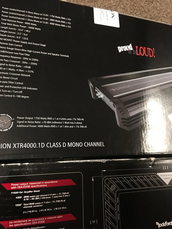

Smoothe Posted January 29, 2018 Report Posted January 29, 2018 I have two amps and am trying to decide which to use for my setup. Subs are two JL W7 12's 3ohm each wired to 1.5 ohm to the amp. The amps I have are a Rockford T1500-1bdcp rated and a Orion XTR4000.1D. The subs say 750 watts is optimal and 1000 is max rms before warranty is void. The Rockford would be safe but the Orion has the potential to blow them. Should I just use the Rockford and be safe or use the Orion and go very easy on the gain. What would you guys do? The subs will be sealed because that is what I prefer. Rockford ratings @ 14.4 Volts Orion Ratings @ 12.6 Volts 1000 Watts x 1 @ 4-Ohm 1750 Watts x 1 @ 4-Ohm 1500 Watts x 1 @ 2-Ohm 2800 Watts x 1 @ 2-Ohm 1500 Watts x 1 @ 1-Ohm 4000 Watts x 1 @ 1-Ohm

SkarredSierra Posted January 29, 2018 Report Posted January 29, 2018 I would use the rockford. Chances are its more efficient and cleaner sounding than the orion.
Smoothe Posted January 29, 2018 Author Report Posted January 29, 2018 Yeah I do think you are right, I think the Rockford gets the edge on efficiency. Thanks for the advice man!
PC Principal Posted January 29, 2018 Report Posted January 29, 2018 50 minutes ago, mathewyocham said: I would use the rockford. Chances are its more efficient and cleaner sounding than the orion. What he said^ 2007 Toyota FJ Cruiser RF Power T1000 BDCP RF Punch 400-4 2 P2D4 12's
Smoothe Posted January 29, 2018 Author Report Posted January 29, 2018 Okay Rockford it is then, I was kind of leaning towards that. I only impulse bought the Orion because of the BigD Amp dyno but it's really too big for my subs and can still get a refund on the orion. Now on to the rest of the components. Quick responses on this forum, thanks for the input guys.
bcbrassard Posted January 30, 2018 Report Posted January 30, 2018 You know that T1500 is putting out closer to 2K @ 1 Ohm. Smaller foot print and clean as hell. At least mine is. Either one is a winner, you could always turn the gains way down on the Orion. ?
