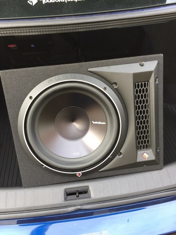

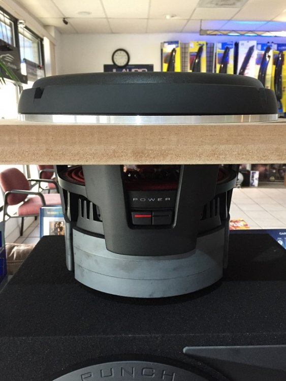

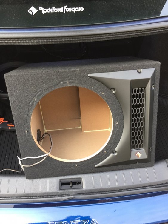

bigtinybob Posted March 29, 2018 Author Report Posted March 29, 2018 so no luck with Rockford website I went back to the local car audio place and they said they would build me a box to the p3 spec ..after talking to the guy since they are Rockford dealers he said he would sell me one of the Rockford boxes for the same price as the custom one....and I couldn't be happier it hits so much harder and sounds so much cleaner and better never had my wipers move with 1 12 lol also seen a t2 that was sitting on my box ,things a beast

bcbrassard Posted March 29, 2018 Report Posted March 29, 2018 Glad to hear it worked out. A properly tuned box designed for a specific sub is what its all about. What did they charge you?
bigtinybob Posted March 30, 2018 Author Report Posted March 30, 2018 5 hours ago, ckeeler11 said: Turning the headunit up to 80 or 100 could be introducing a clipped signal because of you over driving the internal amp of the headunit. You need to figure out where your headunit starts to clip (distort) and do not go above that volume and tune your amp at that level. At any volume the 80-100 hertz setting was horrible. Now the new box it sounds great at 80 5 hours ago, bcbrassard said: Glad to hear it worked out. A properly tuned box designed for a specific sub is what its all about. What did they charge you? 125. Considering I sold the old box and alpine sub for 150 I didn’t mind the higher price.
