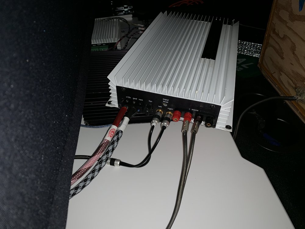

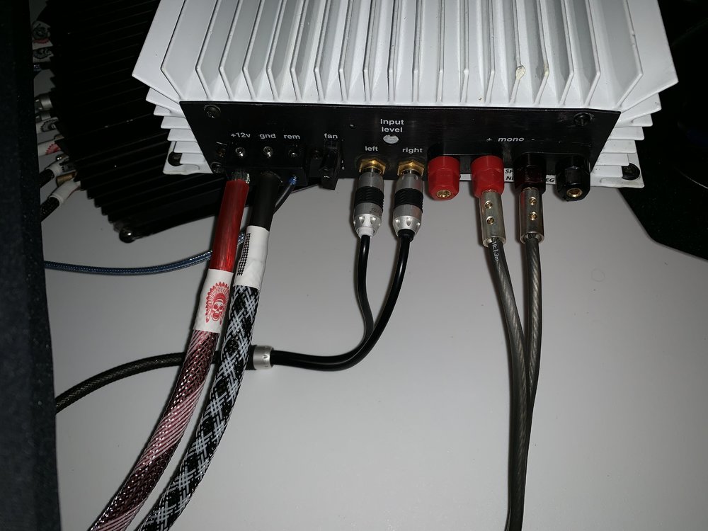

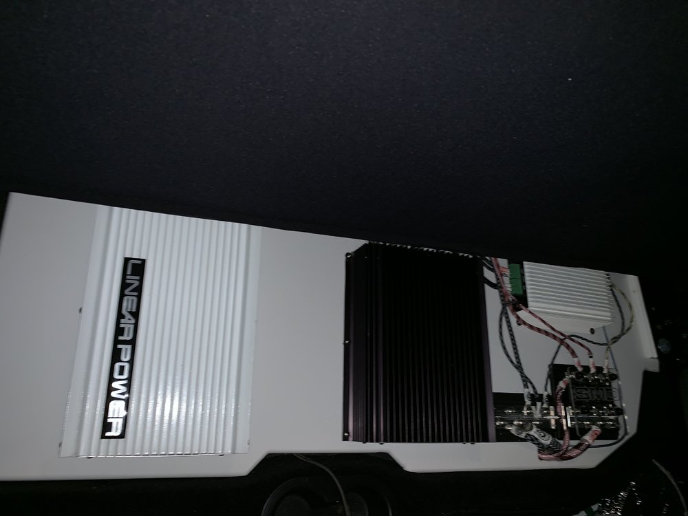

Big boy is wired up. I need to upgrade my battery situation ASAP. Before this thing kills it.
Those two extra speaker terminals are for something called "Feedback circuit" i forgot to account for that when wiring so i went without it. The manual says its fine to not use it, but when used its supposed to enhance cone control and damping factor. Ill try to use it when i make the final box.
The 80PRS was clean at max volume (62). I set it at 2.5 overlap for now. Probabaly shouldve kept it at 0 until i upgrade batteries. But oh well. Ill just keep any eye on voltage, maybe jimmyrig my SMD VM-1 just to watch it better.
Forgot to take pics tonight after it was all installed and wired up and playing. It was 11pm when i finally got to hear some real BASS and i couldnt turn it up much so i ended it there for the night. Ill take some pics and vids tomorrow in the day light.

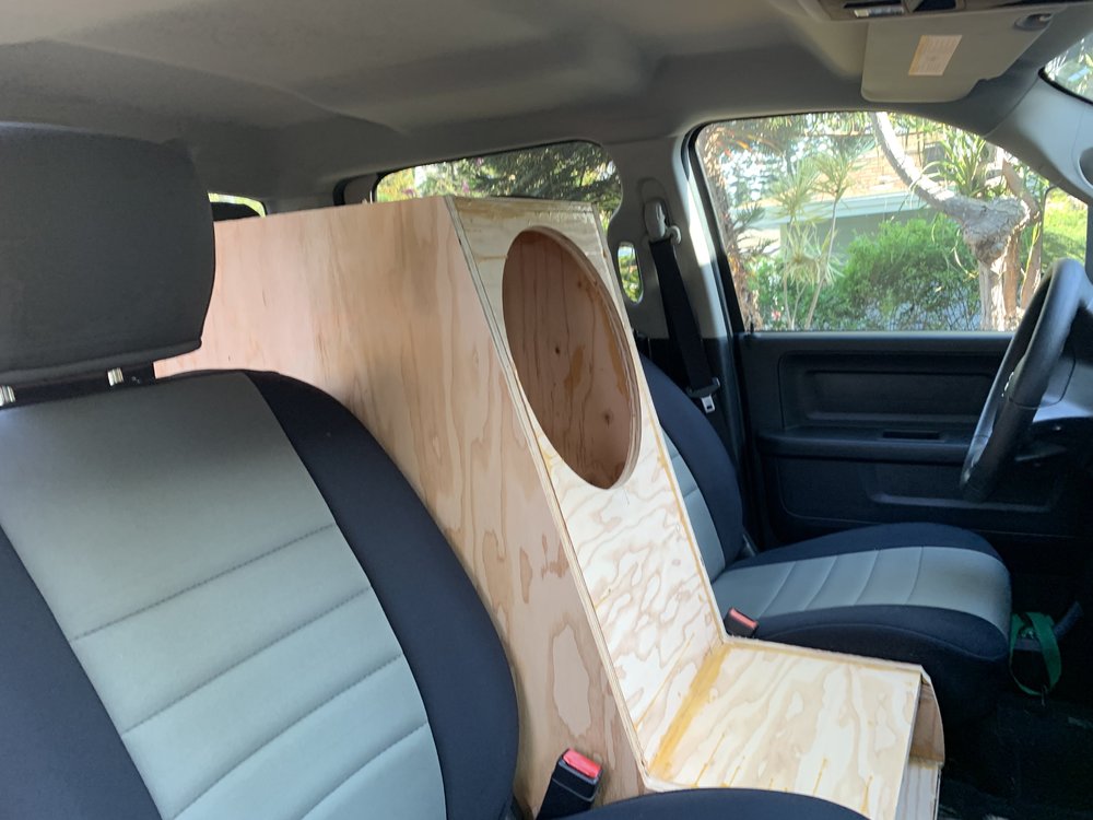

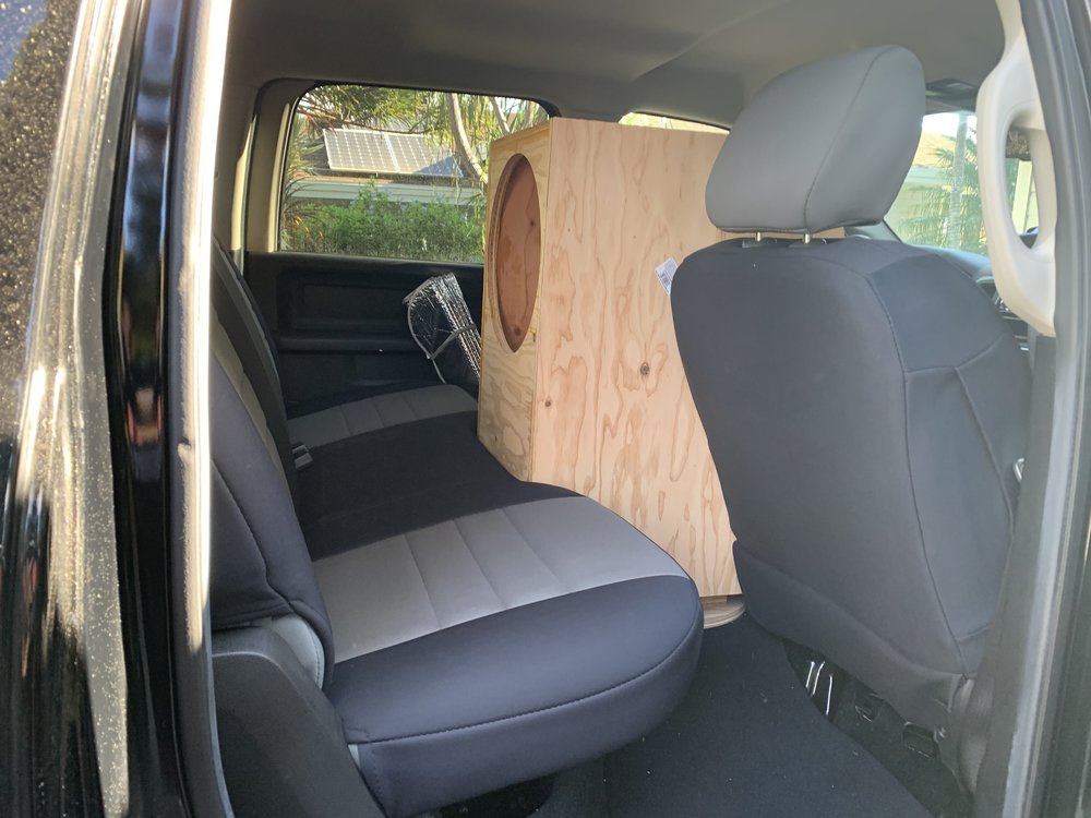

Heres some teaser pics of how it'll look, just no subs yet in this pic. These are pics from the boxes build log when i test fitted the box.

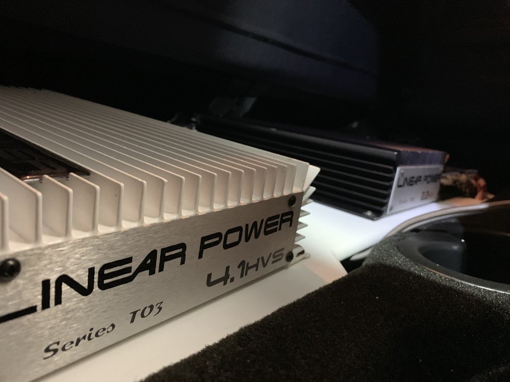

That 4.1hvs is fucking beautiful ...
Thanks man. Ive had it for a couple years now and this is the first time ive ever turned it on. Im so glad it came on and worked the first try lol. I got bad luck with stuff like that.

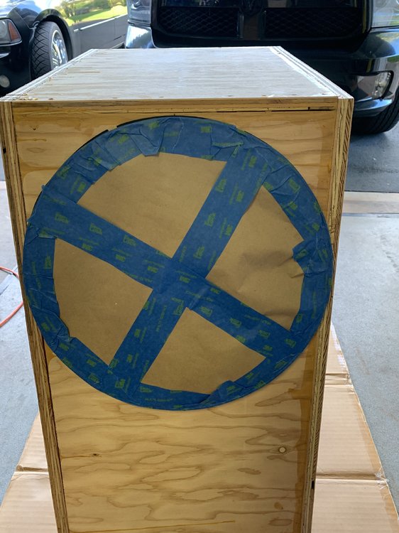

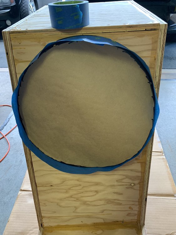

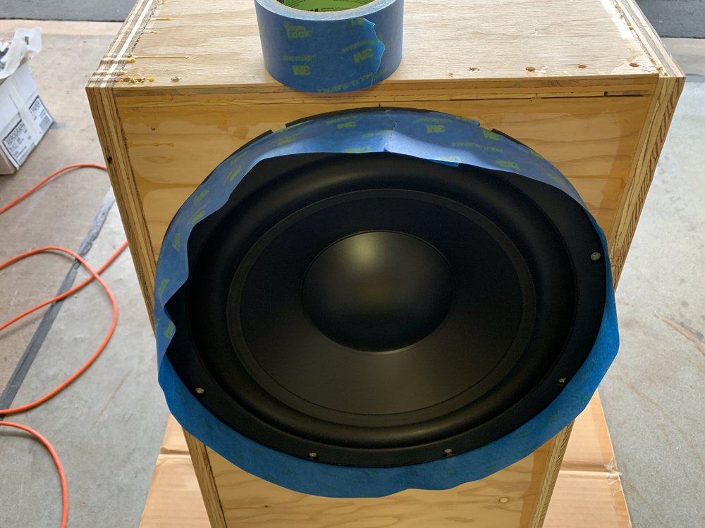

Gonna paint the box so it blends in a lil better and isnt so noticeable from outside the truck. Also need to get tints.
Taped around the side edges of the sub.

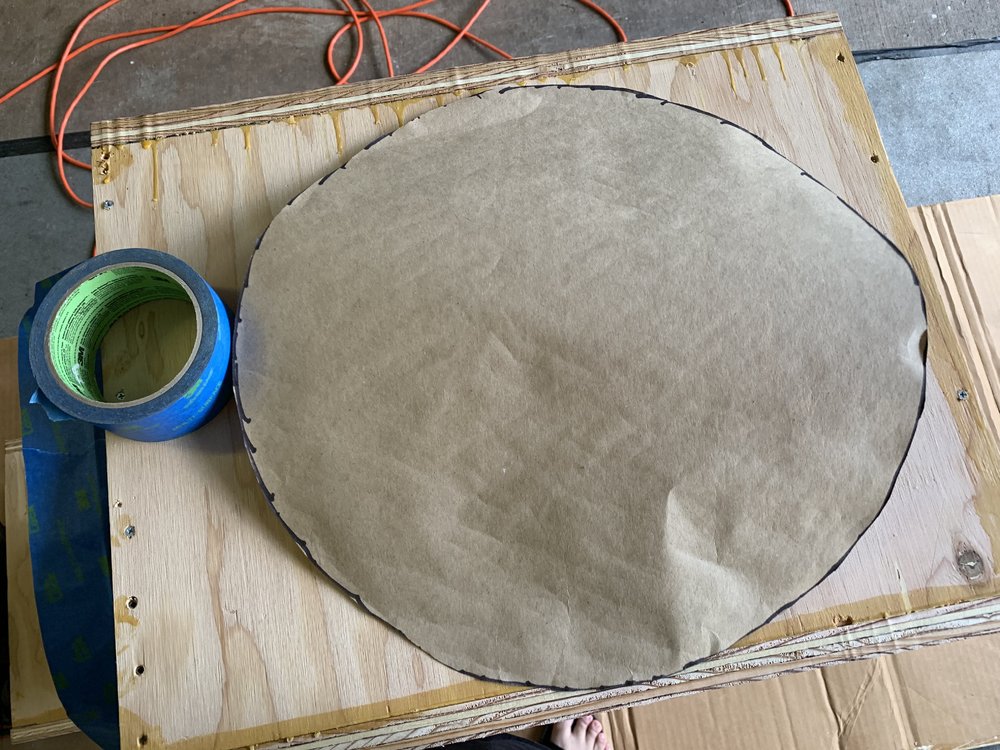

Then cut out a circle piece of paper to cover the front of the sub.
