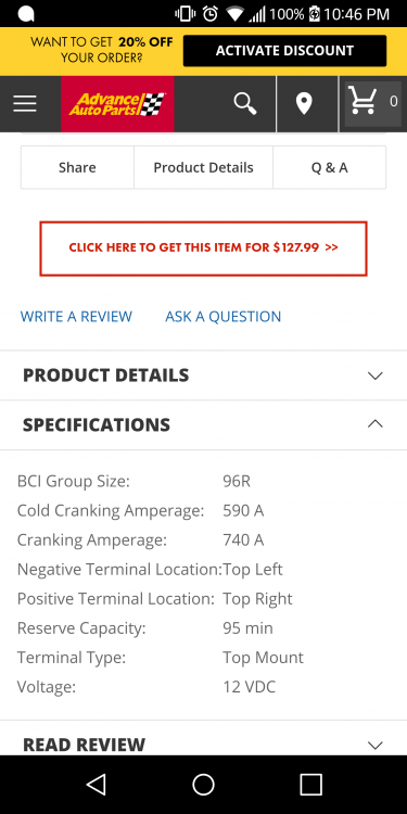

alex912005 Posted July 11, 2018 Report Posted July 11, 2018 5 hours ago, DJ Zander said: So u don't think I need to spend $300 on a big battery under the hood? You probably don't need it. That amp is not going to produce 1000 watts after impedance rise anyway, more like 300-500 watts. My Build Log
DJ Zander Posted July 12, 2018 Author Report Posted July 12, 2018 So these r the specs that the battery I have now under the hood. Called autocraft gold battery 96R-3. Don't really know how to tell if that's good enough. Many mixed opinions on this topic and it's difficult to pick the best answer out of all of them
DJ Zander Posted July 12, 2018 Author Report Posted July 12, 2018 They say it's perfect for starting ur car up and that's it
alex912005 Posted July 12, 2018 Report Posted July 12, 2018 It's small, probably around 50 Ah or so, but get your setup going and try it. You won't know if you need a bigger one until you try. My Build Log
