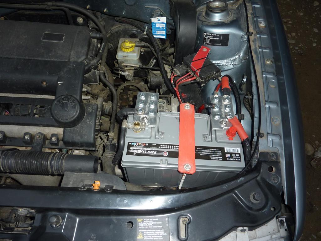

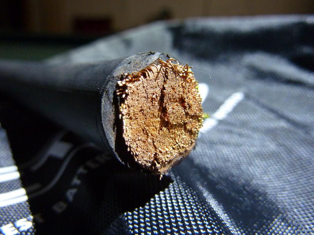

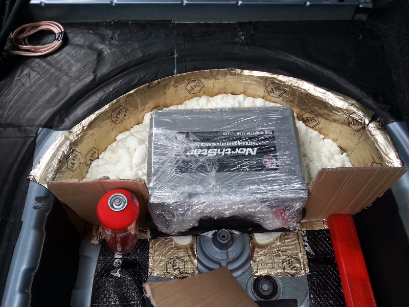

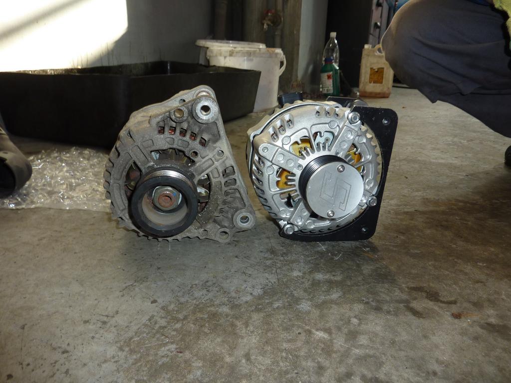

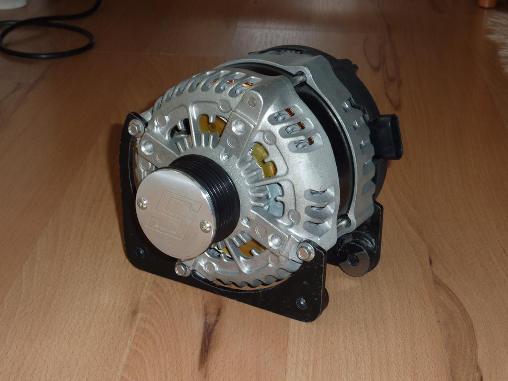

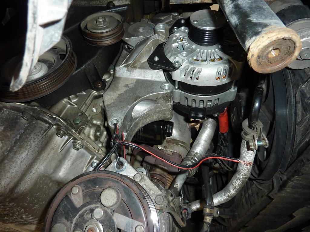

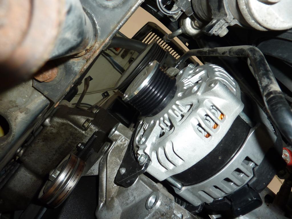

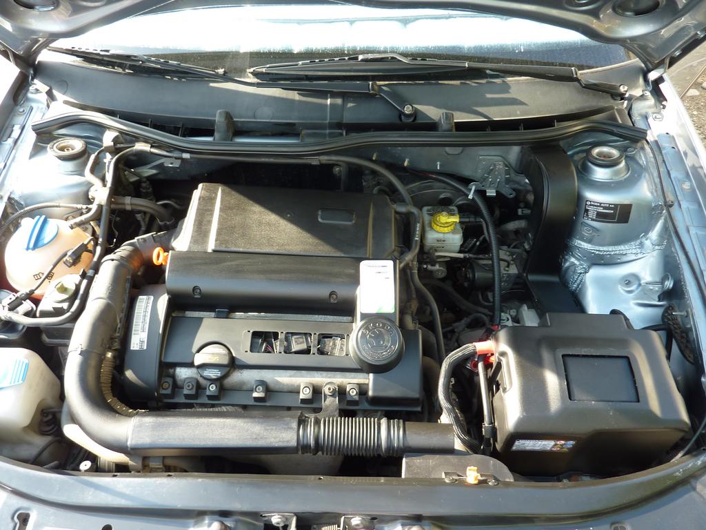

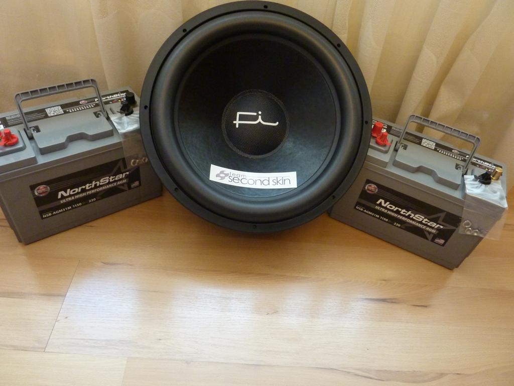

alex912005 Posted October 8, 2017 Author Report Posted October 8, 2017 Electrical Stock battery in engine bay (what a small engine; yes I know:)) Cramming a Group 31 AGM in there: Singer alternator install pics: Old 90A vs. new 270A Second battery My Build Log

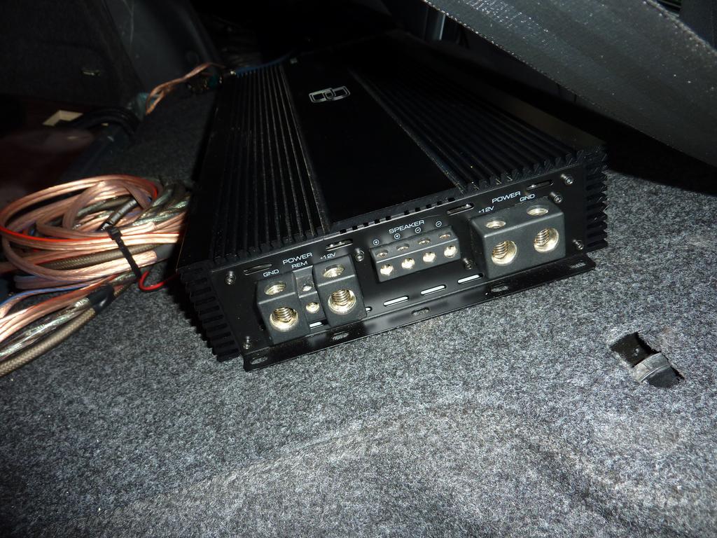

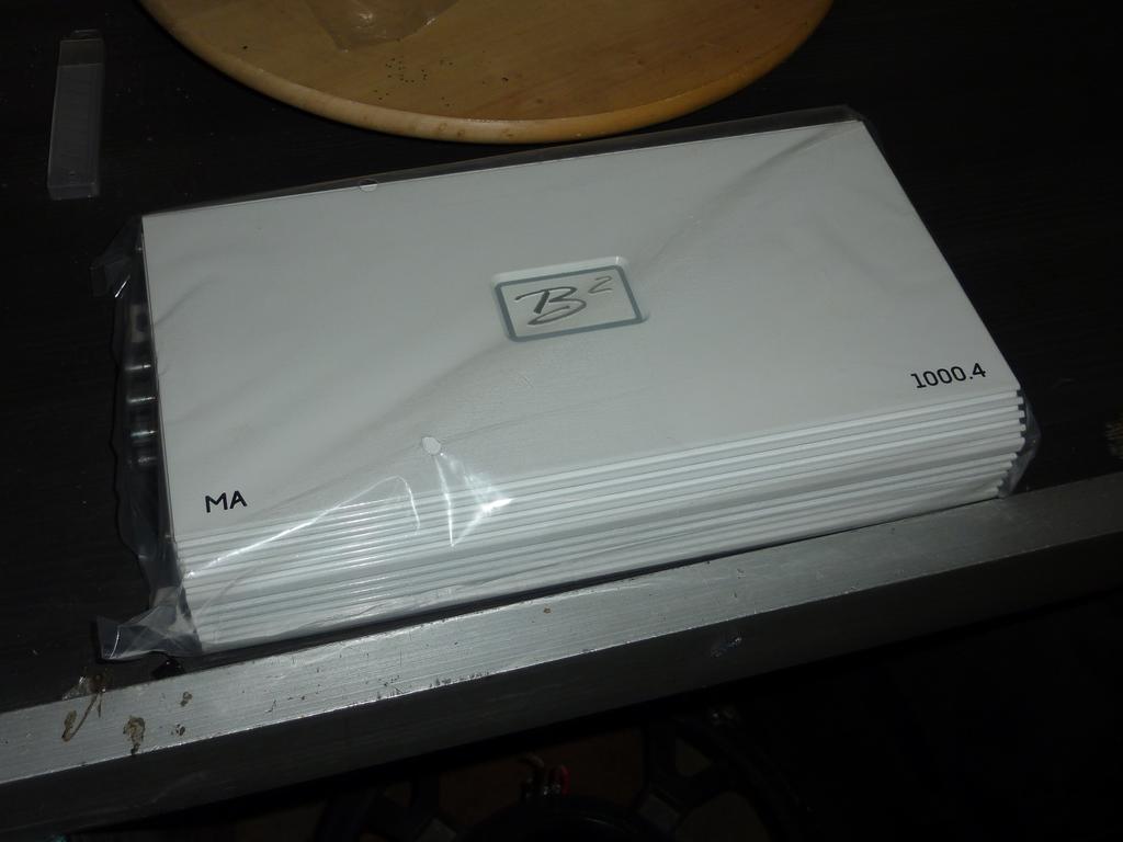

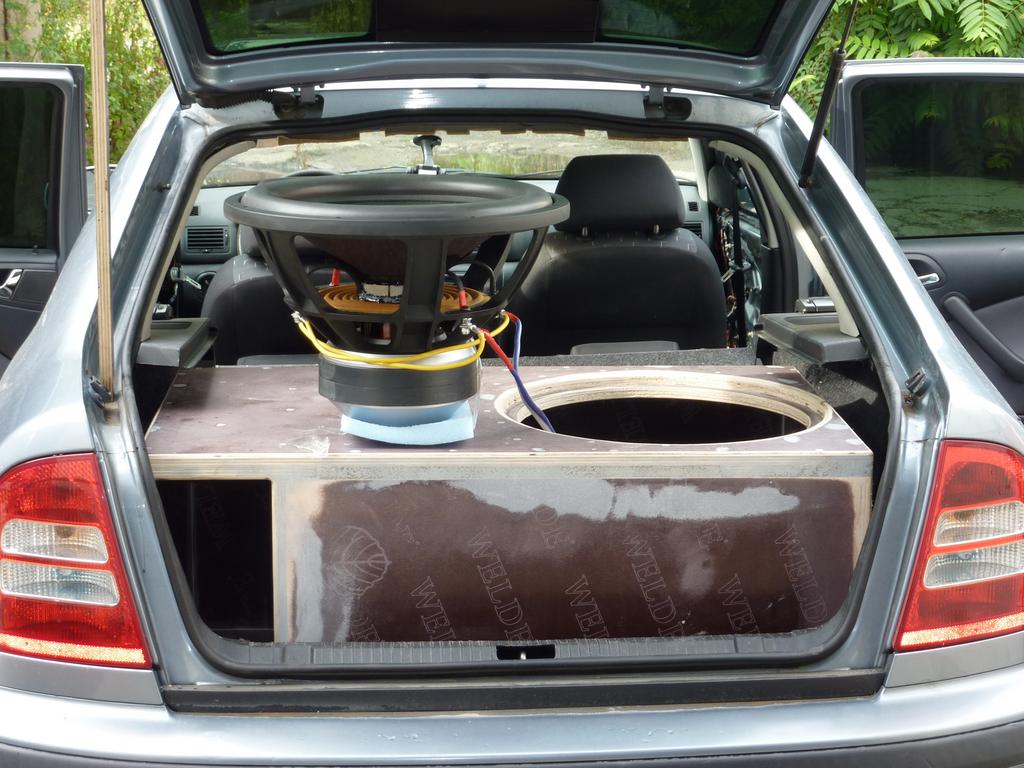

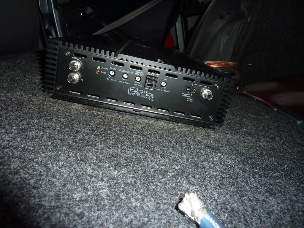

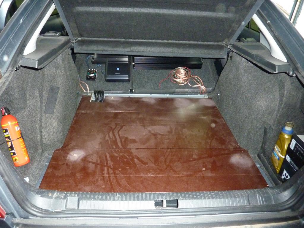

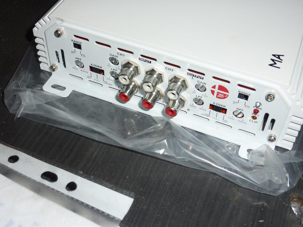

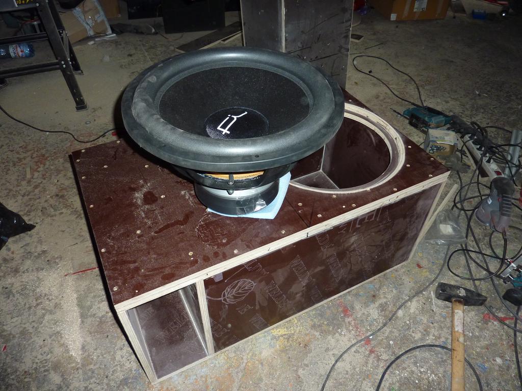

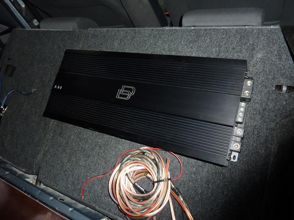

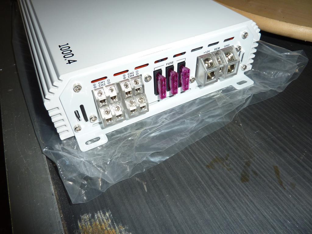

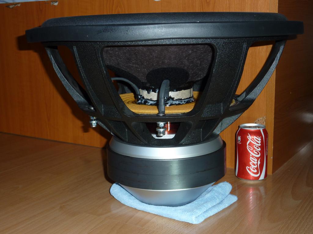

alex912005 Posted October 8, 2017 Author Report Posted October 8, 2017 Subwoofer and box Trunks space (with old amps that got removed and the new DD M4) Some amp pics Digital Designs M4 (underrated 5k) M4 clamped doing 2800w RMS on 2 ohms rising from .7 ohms B2 Audio MA1000.4 My Build Log

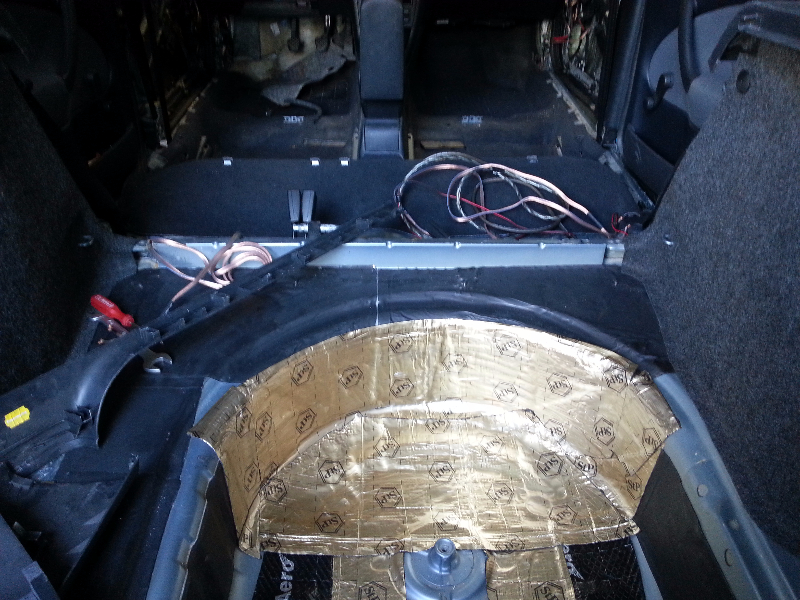

alex912005 Posted October 8, 2017 Author Report Posted October 8, 2017 Doors Here they are with some temporary paint. I then had them flocked, but the flocking cracked in two weeks and now they are being redone. Some deadening pics Second Skin Damplifier Pro STP Bomb Aero Very thick stuff Some "evidence" of bad repair work done on the car before I bought it... My Build Log

YukonXL04 Posted October 20, 2017 Report Posted October 20, 2017 Damn. That's a sweet build. Looks like the port is blocked quite a bit at the bottom. You have it playing yet? How you liking it? 18 Sierra 6.2 Z71 : 3 F8L's, DD M2a @.67, 1.95@33 05 TL build log SOLD 04 YukonXL : jvc kw-v51bt , RE 6.5c, 4 jbl gt5 12s, Memphis pr1000.1 5.5 cu.ft. sealed
alex912005 Posted October 21, 2017 Author Report Posted October 21, 2017 On 10/20/2017 at 4:40 PM, YukonXL04 said: Damn. That's a sweet build. Looks like the port is blocked quite a bit at the bottom. You have it playing yet? How you liking it? No it's not blocked. There's a good 8 inches there but it looks that way cause of the angle the picture was taken. It plays fine, from about 24 hz to around 55 ish before it rolls off. But it doesn't like the 2800 - 3000 clamped watts it's getting from the M4. It gets stinky fast. My Build Log
Karkov Posted October 21, 2017 Report Posted October 21, 2017 wow man nice gear! I really wanna know your thoughts of how that sub and amp combo sounds once it's banging since it will be much louder/better than the Kicker. =) Otherwise everything looks great man, you sure this is only 2nd sound system? haha 2007 Chevy Tahoe (SOLD) 12 ~ FI Audio X series 10" w/BP option 2 ~ DC Audio 5.0K @0.67 3 ~ DC Audio 5.0K @1.0 2 ~ PPI 3 way sets (not installed yet) 1 ~ RF T400-4, 1 ~ RF T600-2, 1 ~ RF T600-4 4 ~ CT Sounds 5.25" Strato comps (rear fill only) 1 ~ XS Power D4800 1 ~ XS Power D3400 8 ~ XS Power XP3000 160 stock alt, Mechman 370 Elite, 185 DC Power 320+ Sq. Ft. Sound Deadener Pioneer AVH-X5500BHS Youtube: https://www.youtube.com/user/knfjdkghjudfhsgkjdhf/videos?sort=dd&view=0&shelf_id=0
alex912005 Posted October 22, 2017 Author Report Posted October 22, 2017 15 hours ago, Karkov said: wow man nice gear! I really wanna know your thoughts of how that sub and amp combo sounds once it's banging since it will be much louder/better than the Kicker. =) Otherwise everything looks great man, you sure this is only 2nd sound system? haha It sounds fine. The sub doesn't like the amp from a thermal standpoint. It gets stinky fast. But not a lot of guys have this sub on a 5k so that's why. I am giving it 2800 - 3000 watts after impedance rise. And it's only my 2nd system but I didn't do the work myself if that's what you mean. Several people worked on it. My Build Log
