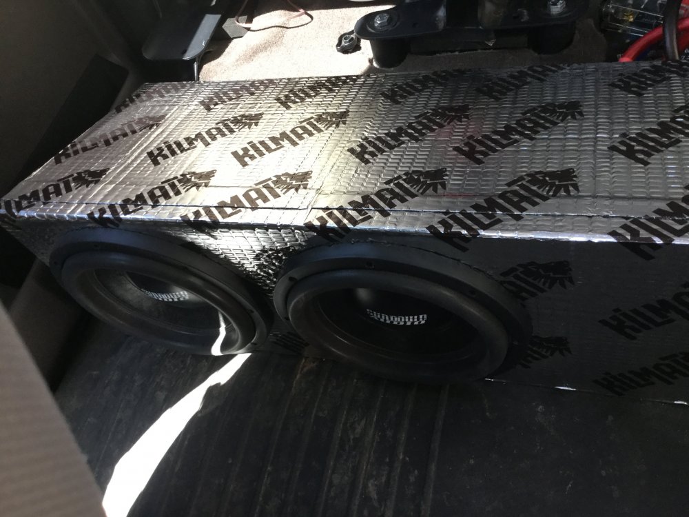

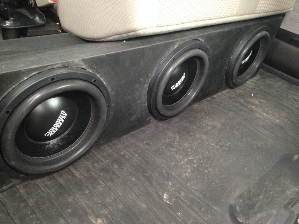

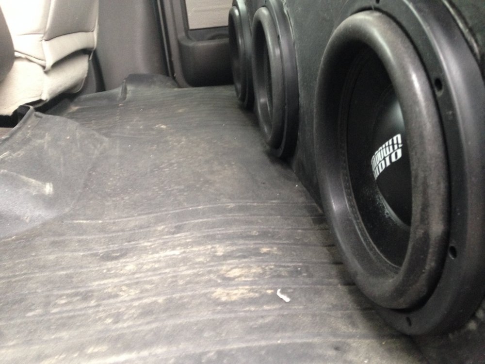

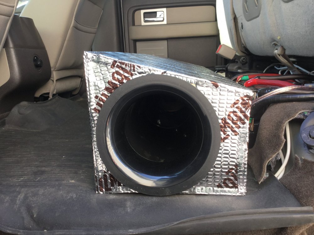

So I’ve been running 3 SA 10’s sealed box at .6 ohms for 2 years now and it pounds but I feel so bad for my electrical. This is an under seat build so there is know room . Here is my sealed box .

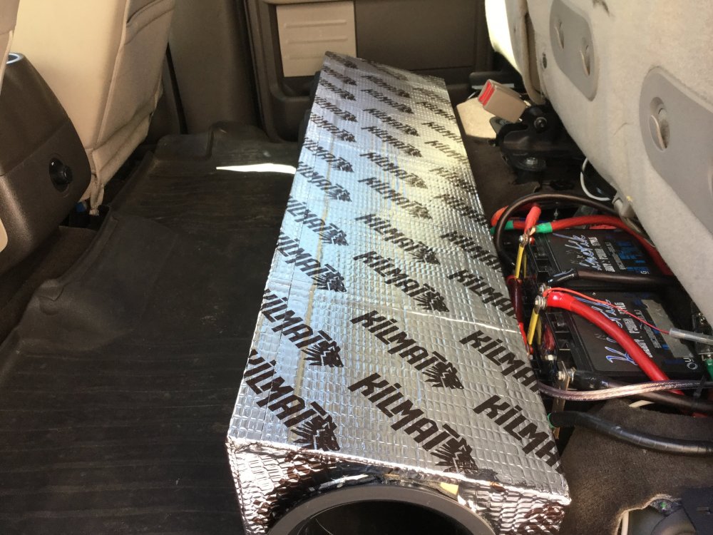

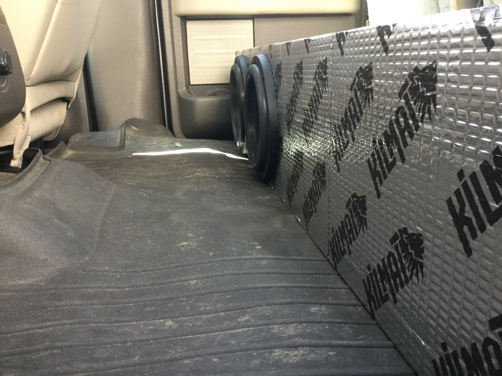

So I had 2 ports laying around a 4inch and a 6inch . I already have tons of glue nails and deadening mat laying around. So for the love for my electrical I built a box for 2 of my SA 10’s so I can run 1ohm . Box is 1/2 inch MDF that’s the only thing I didn’t have ,  Box is 55 long by 11and 1/4 deep and hight 11 1/4 to 8 1/4 , port is 6 wide and 27 long .

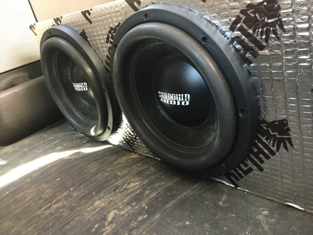

I rapped that bitch in killmat hoping to help hold it together because 1/2inch ain’t shit . I was shocked when it fired up , I got like 30bucks in this thing and it slams . Had to adjust the gain down because 2200RMS for 2 SA 10’s is a lot but it sounds exactly like my 3  10’s but alittle lower and my voltage at stop lights went from high 12’s to low 14’s . Night and day for my ALT.
I was just curious to see if the box would hold but am very impressed so far but if it blows apart don’t care but I think the giant port helps the box release pressure so should be ok ?
I don’t recommend going 1/2inch MDF on any box if u have room , this was just a one off and didn’t cost  me shit but time.

Box pounds so far need to get to a parking lot to adjust amp alittle bit more but am very happy and my electrical is too.
Did you add any bracing inside the box? Also man you gotta start recessing the subs lol.
Using 1/2 I would highly recommend a bunch of bracing.
